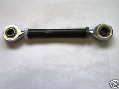

yeh iv seen chris's and if it would be made from female rose joints then thats pritty much what they would look like although his has to be removed from the bike to adjust it
if i can get turnbuckles make up then it should look a bit nicer, this is a turnbuckle and it would basicly look like two of these in parrallel with a turned town ally tube joining them. at one end
