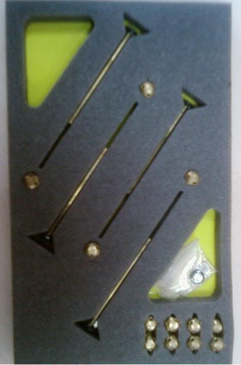

Need you help. I have bought KENSO\BAKUDAN jet kit for CBR400RR-L NC29. It has adjustable needles and set of main jets (123, 125 and 130). Here is the picture below
I have spoken with Graeme and he said that BAKUDAN KIT not work properly, but anyway I'll try to fit and check. Greggo advice me to start smack in the centre for needles and 123 main jet - because I run just with air filter and TYGA exhaust. If I will set up K&N air filter and extend air flow I will be able set up 125 main jet. Correct?

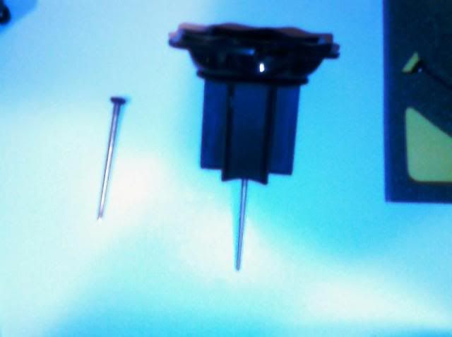

Carb jetting is new for me, so first problem I have faced removing standard needles. How it can be done, because I don't like to damage diaphragm ?

use a bolt and screw in the top then just pull it out
