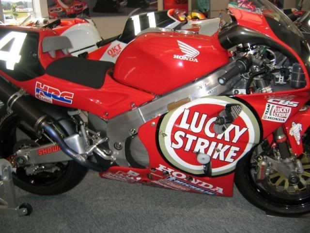

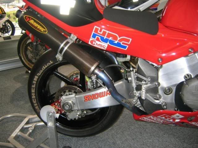

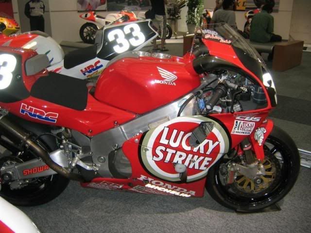

4.Does anyone have any pictures of the '98 / '99 Lucky Strike Suzuka 8hr RVF's as I intend to do a replica ?

Many thanks Viper for the great pic's.... I take it you've had chance to visit the Honda museum?
