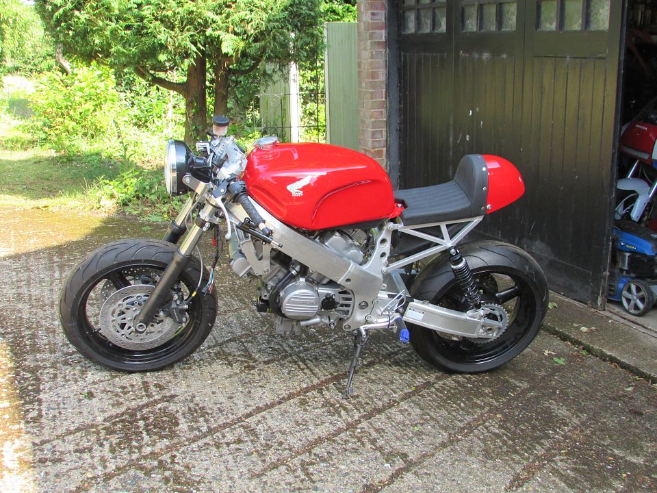

NC30 Cafe Racer

Re: NC30 Cafe Racer
Is... is that a steering damper?
- RickOliver
- Posts: 492
Re: NC30 Cafe Racer
Yes, it was only there because I needed to hold the wheels in line while I lifted the bike off my workbench using a sling and hoist - don`t worry, it`s gone now...

Re: NC30 Cafe Racer
Honestly?RickOliver wrote: Wed May 28, 2025 4:26 pm NC30 as 1960s styled twin shock cafe racer - early stages yet but what do you think of the concept...?
Sacrilege

Re: NC30 Cafe Racer
OK, fine...
I`ve been working with NC30s for 30+ years now and done every kind of performance and handling upgrade on my #1 bike, this one is something strictly for laughs, built out of bits that I had lying around my workshop and playing with a few different ideas.
On the face of it the chassis should be functionally worse than a stock NC30 but it has 46mm ZX-6R forks and a massive but light swingarm off an XJR1300 plus good quality adjustable shocks with the kind of `lay down` geometry that was popular on immediately pre-monoshock GP bikes.
The engine is basically an NC35 with a pair of ex-RLR race heads, it`s dressed up with NC21/24 type engine cases to look a bit more retro. I`ve bored the oilways in the cases and fitted a UK-type twin rotor oil pump. The bike will be unfaired with just a small flyscreen to protect the clocks - to keep the front profile slim it will run a single (lower) radiator plus a 15 row oil cooler which will sit in place of the top rad but be no wider than the cylinder block.
If you shelve your prejudices you might even like it when it`s finished... ;~)

If you can get past the 'OMG you've chopped an NC30' shock (and I understand why many people feel that way) then it comes down to aesthetics.
I like it. Although I'm not sure about the tail hump. Maybe it's the angle of the photo but it looks too tall to my eye.

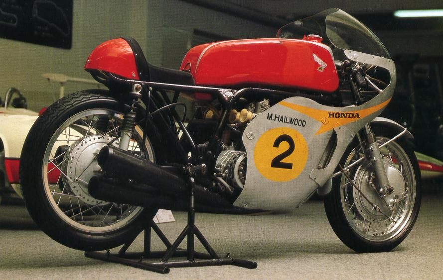

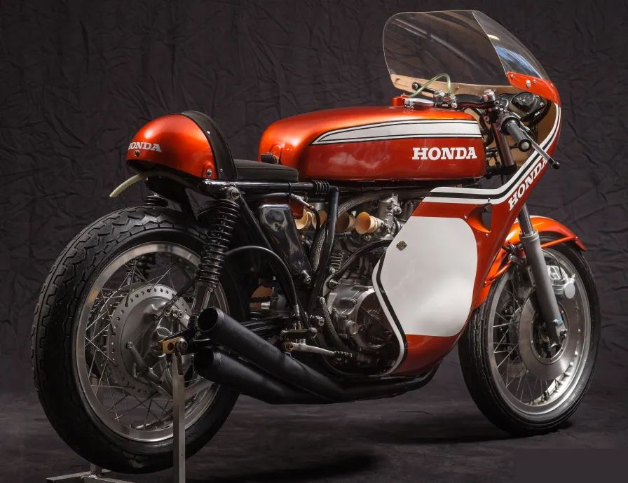

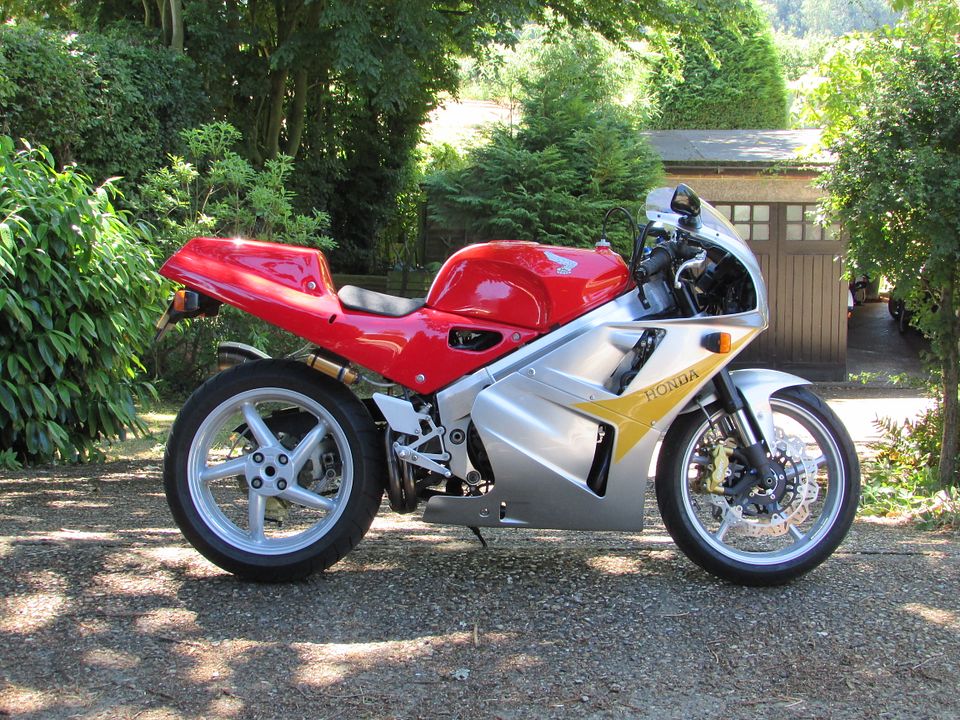

To give this some context, I`m just old enough to have seen the RC172 and RC181 raced in anger rather than simply paraded and those experiences plant something in the head of a bike mad 14 year old that just can`t be shifted.
This is my `best` NC30 (a 1989 RK model which I`ve owned since 1992) and I`ve had something in that colour scheme, from CB77s through 400/4s to NC30s, in my garage for most of my biking life.
The original plan for this current build was a full on RC181 tribute (obviously a V4 with a beam frame is never going to be a replica) -
- wearing full fairing with twin oil coolers in the flanks, spoked wheels with alloy rims and a four megaphone exhaust system. I`ve got most of the necessary parts and it may well end up there but for the moment this is a basic proof of concept build to see if the chassis configuration actually works.

Foxy - you`re right, the seat hump is a tad taller than the one on the 60s GP bikes - it`s actually a replica of the seat used on the CR750s that Honda built for Daytona in 1970, the closest thing that`s commercially available at a reasonable price.
It looks better in the flesh than that photo suggests - I`ll post some more pics when I have a bit more of it bolted together.

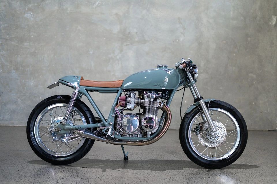

The whole chunky look is a kick back against the 21st century concept of what constitutes a Cafe Racer - to my eye this kind of thing (with due apologies to whoever built it) -
- is just a stripped out stock bike with an uncomfortable seat and inadequate mudguards...

The term 'cafe racer' is bandied about a lot nowadays and used on a whole range of bikes, many of which would never have passed for CR's back in their heyday of the '50's & 60's. So I know what you mean about that Honda, it's got elements but isn't quite there.
