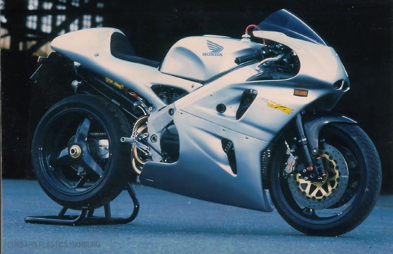

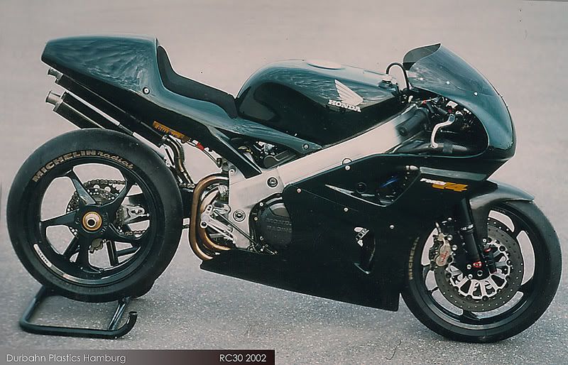

How about rear wheel options? I'm having a hell of a time finding a rear wheel option I've seen pics of on a few bikes. In fact, Thorsten had a certain model rear wheel on his RC30 project I fell in love with. I know the five spokes are Marvic but what are the three spoke mags, Dymag perhaps?

Thorsten mostly use PVM wheels, the three-spoke is a earlier (discontinued) PVM one, but they are too wide for the NC, go with oem, dymag or magtek.
