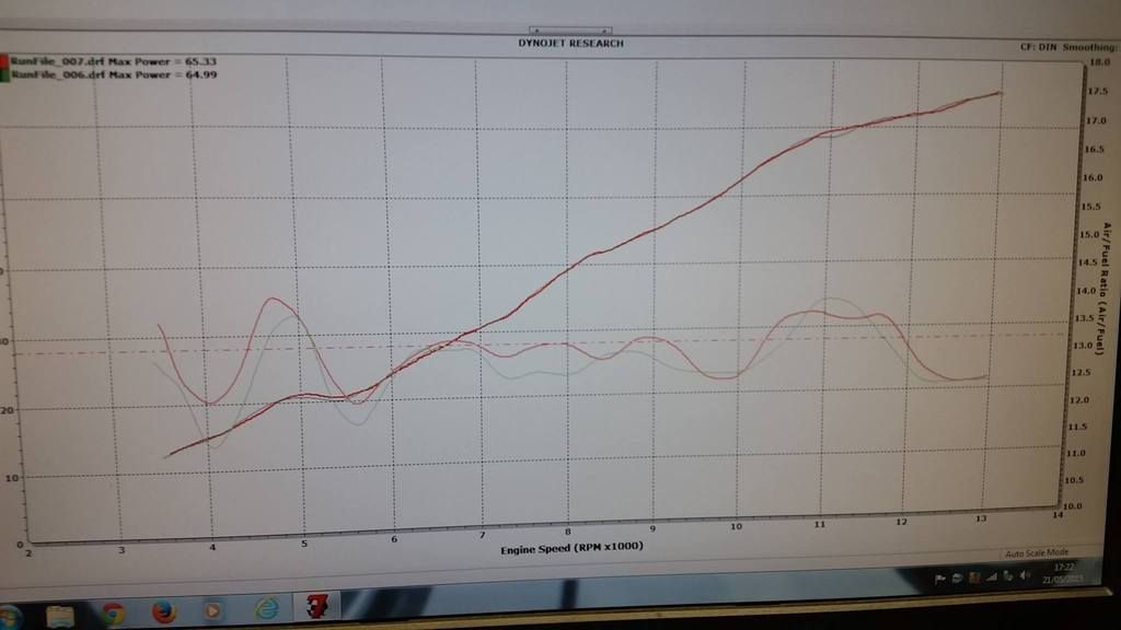

The first dyno run showed she's a little rich:

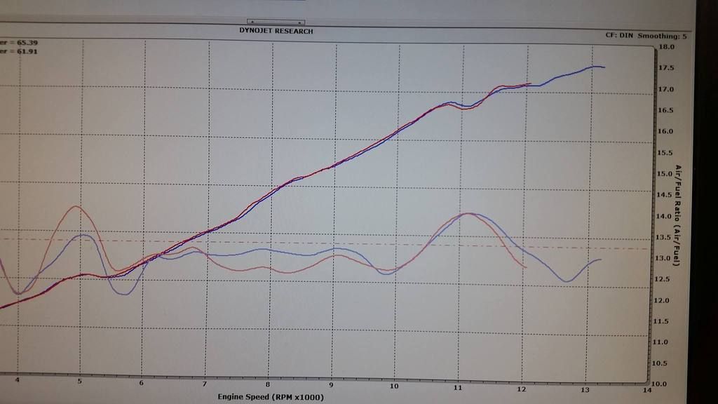

I had a dig through my selection of jets, ended up fitting 120F and 122R mains, on the needles I had some RO NC35 needles so fitted the red topped ones as they seemed the richest out the lot (J9MC I think), but still a lot leaner than the HRC type ones. It's all a guess at the moment, but the next run yielded the following results:

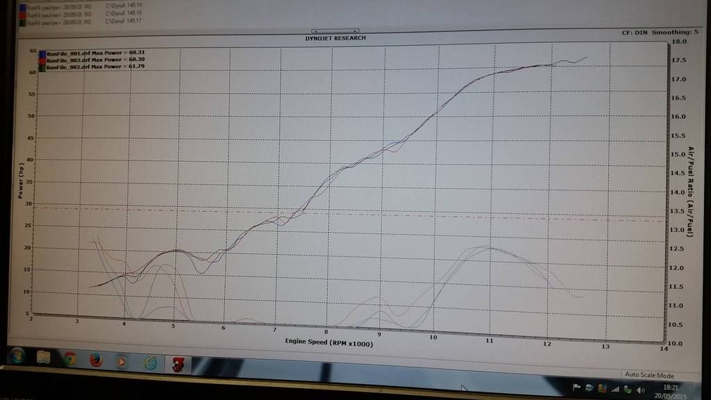

Then tried 118F and 120R and it didn't like it as much

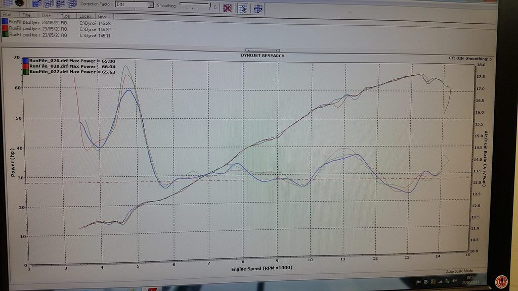

So went back to 120/122 and the needles on the richest setting. Also fitted some 5 hole emulsion tubes front and rear. By now we were running out of time as I was heading off for our first race. Ended up with it like this:
Far from ideal, but it was running and making decent power. That lean-ness at 10-12k looks horrible, would drilling the slides help this?
Better, but seemed to be hitting the limiter at 13k, a shame as it hadn't hit peak power yet.
