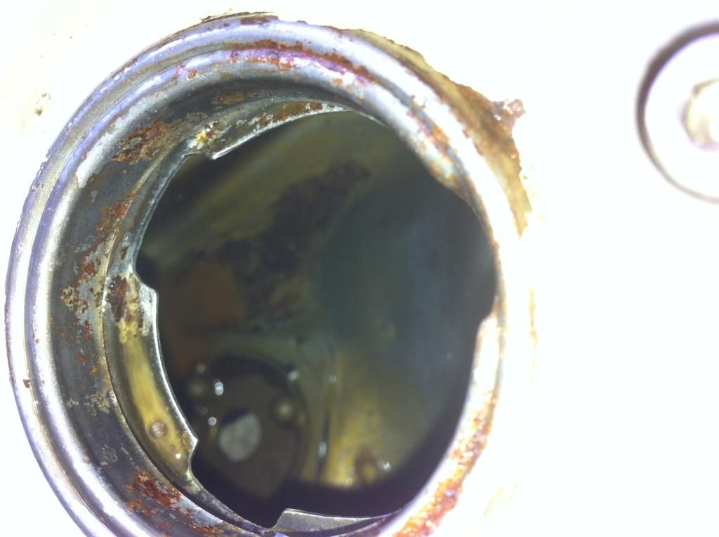

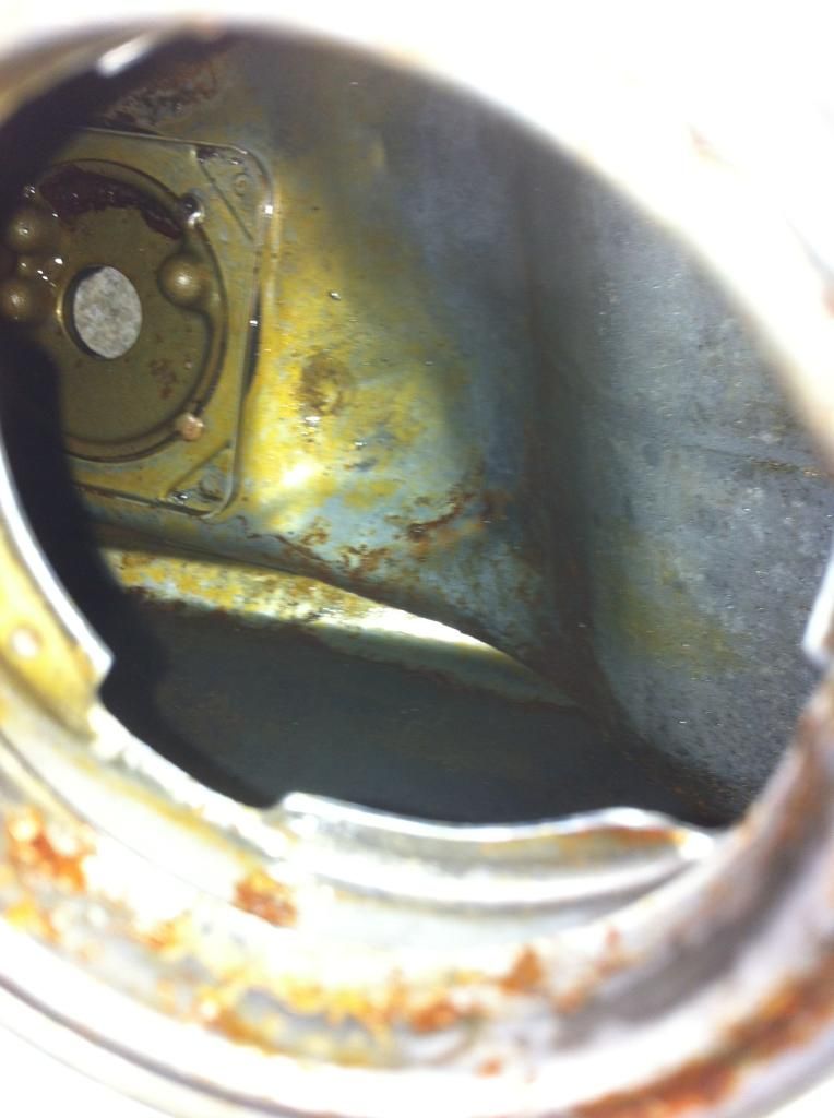

The tanks pretty solid as it wasnt enough rust to affect the integrity of the tank.
Im hoping the photos will show what kind of rust im looking at
The yellow stuff will be the oil to stop further rusting but the rust is fairly evident.
Am i being a bit fussy?
Now my carb rubbers have arrived i can hopefully make a few in roads

I wouldn't worry too much about that much rust, most old tanks probably have just as much in them.
A Pessimist is just an Optimist, with experience.
Doc out . . .
