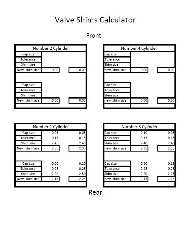

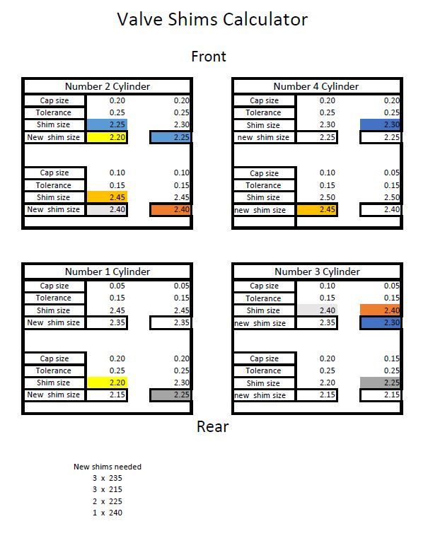

Hi all
While my carbs were off having some minor work done I decided that I would have a go at checking my valve clearances after reading the guide on here, It didnt look to scary. Seeing the figures I was getting from the rear cylinders I chicken out of doing the fronts and wanted to get these calculations checked.
By the way I did do a quick exel spreadsheet that does all the maths for you(layout is as is above), if anyone wants or needs a copy give me a shout unless the admins can post it some how....

Re: Valve shim Calculation
The reason I posted the above is really about what effect this would have had ? my bike runs well apart from the fact it's seems a bit juicy would this make sense, What should I expect when I replace and get valves back to where the should be ?
Re check one to make sure, but I measured both ways and it seemed the same, certainly well within the plus and minus limits.
Only when the clearances close right up [nil or less] and compression is lost will you notice any difference in performance.[May show on a Dyno run]
Starting and low speed running will be poor.
Well just a follow up after speaking with Ricky O about my shims he advised me to measure between the rocker and the shim as there is a difference between the 2 different places, there was a difference of .05.
