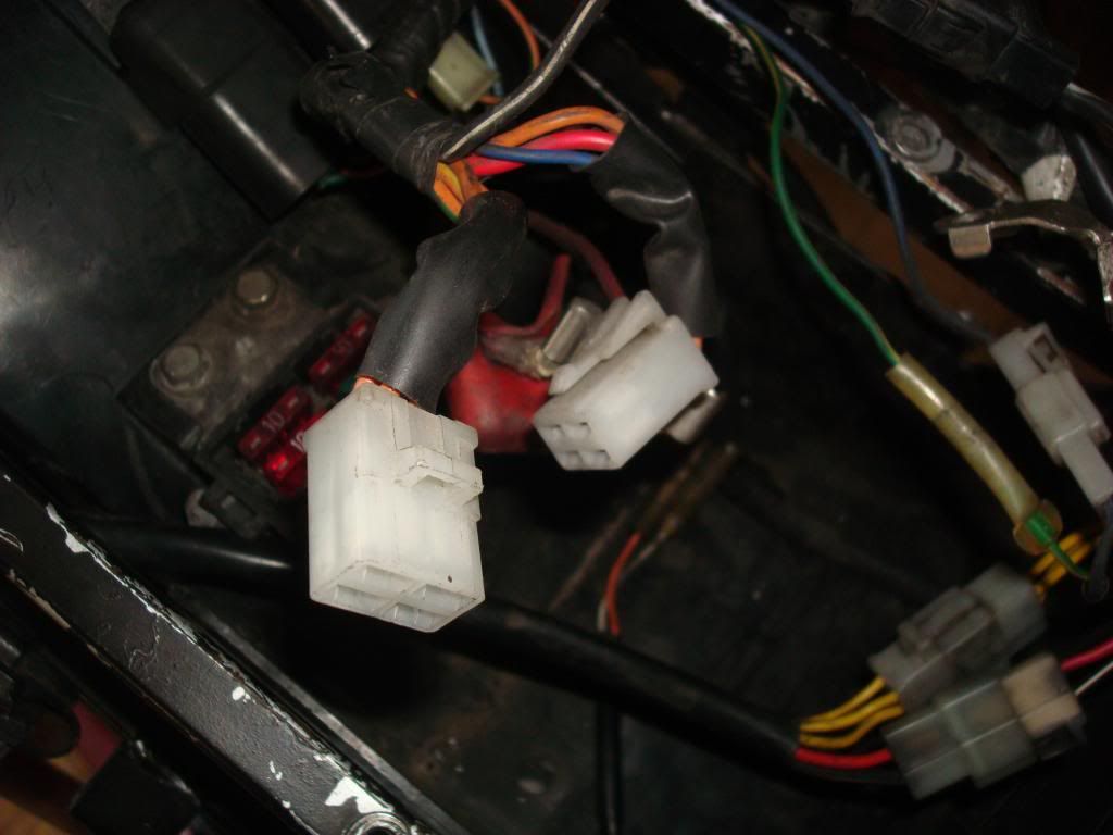

Figured those 2 connection blocks...feel stupid now.

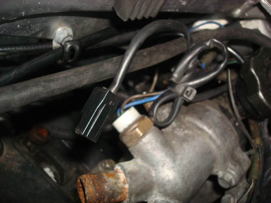

Any idea's where the other wire goes in the last picture?

Re: Wiring help on gk76a please.
Single wire? it'll be for something like the temp sender on the stat housing, or neutral switch , oil switch. Carb warmer.
I recognize it but can't remember exactly what it is.
- Posts: 228
- Location: Atlanta, GA USA
It should slide onto a flat tab located on the lower left front of the housing you have pictured. A lot of the time they are snapped off. You can almost see it below the blue wire in your photo.
rgvsp wrote:It should slide onto a flat tab located on the lower left front of the housing you have pictured. A lot of the time they are snapped off. You can almost see it below the blue wire in your photo.
Thanks buddy........I don't think it was ever connected.
Where would I get the spade thingy, for it to connect to?

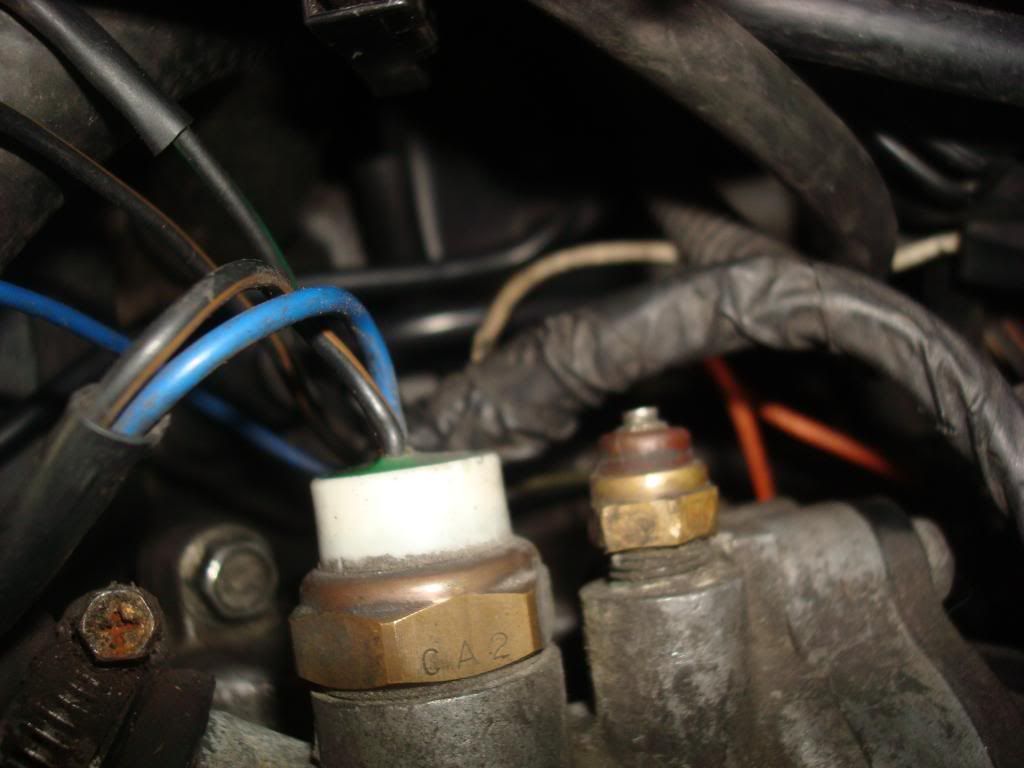

A better picture for clarity;
- Posts: 228
Part number is 34850-82012. Looks like a common Suzuki temp sensor. I'm sure you can find the whole unit on Ebay as well.
