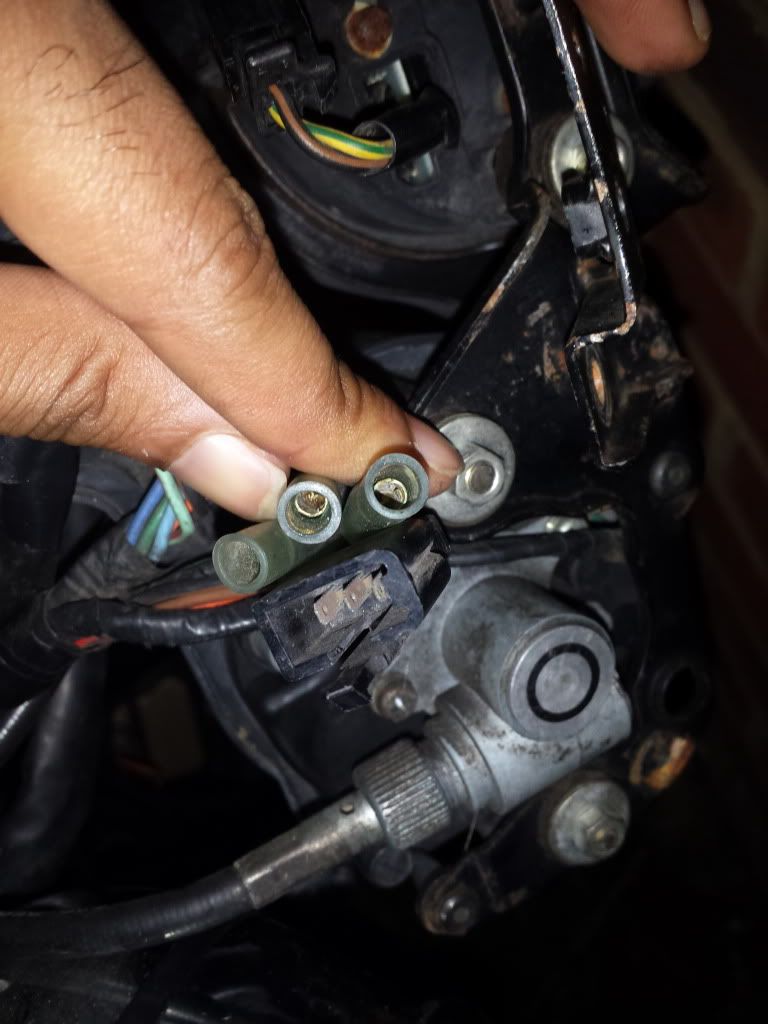

hey thanks for getting back i have had a look under the speedo
and di found few wires hanging not connected to anything
i don't know what they are
i will find a wiring pic and try match the colours
also the key hole is not the standred Honda one it looks like a aftermarket one
i will try get pics on tommorow
