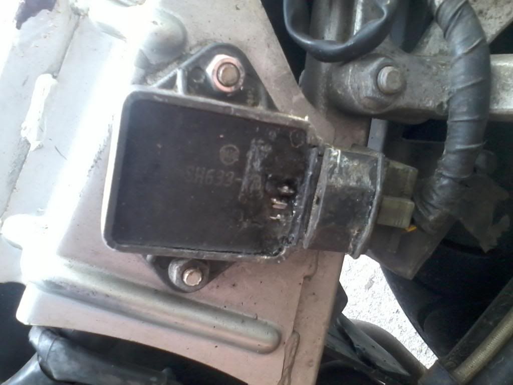

Went to check the conection of the reg/rec and found this:
My Dad was the previous owner, he said that the hole was always there, it never bothered him as it didnt affect charging and as he didnt rely on the bike for transport and didnt bother changing it as it seemed to work.
A quick google of the numbers says that its a cbr600 one?
if this is the case would the wiring have had to been modified to accept it?

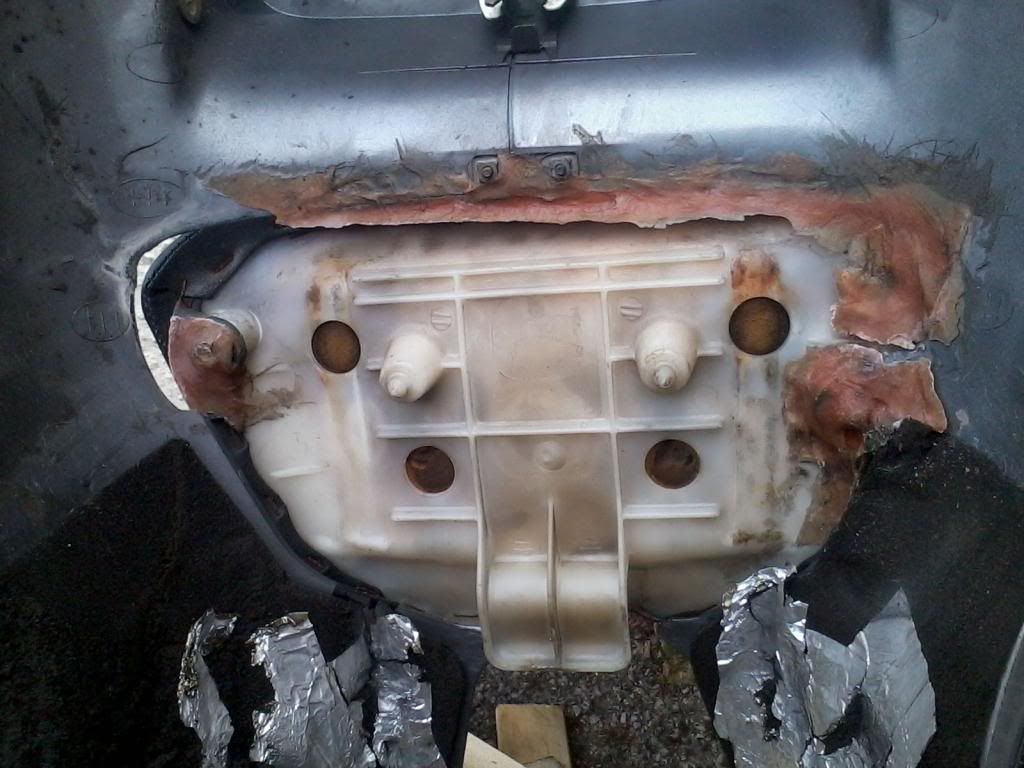

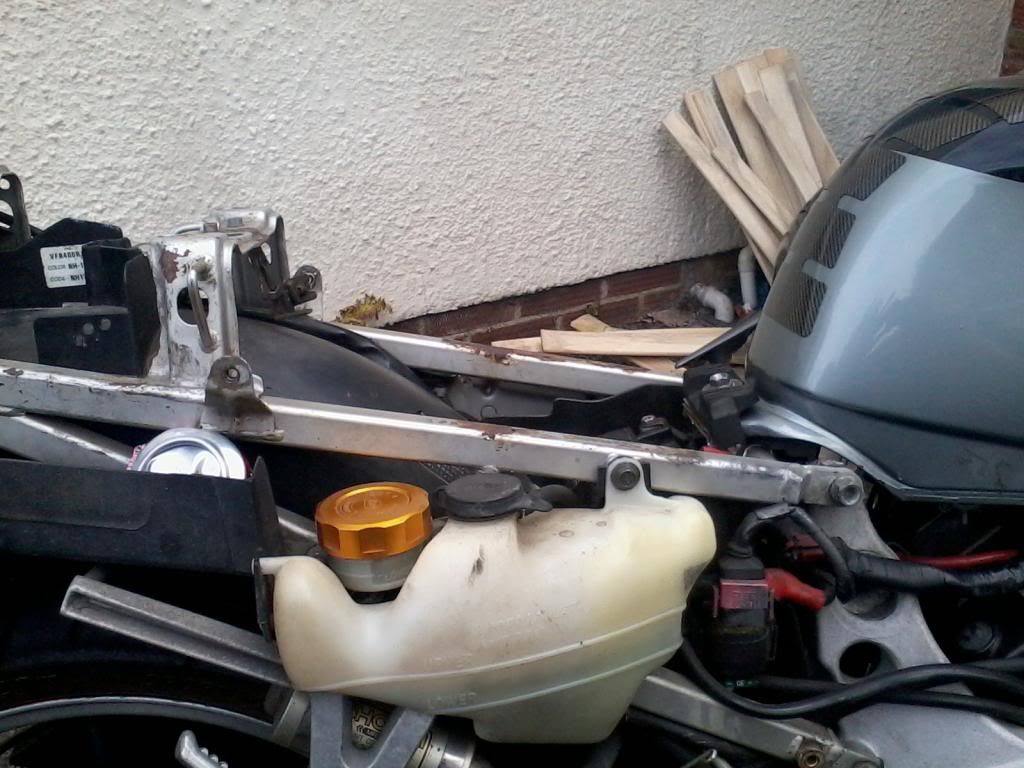

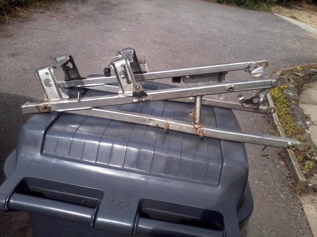

While i had the tailpiece off i found this handywork underneath, my dad bought a new subframe as he assumed that there was a part missing from the old one as there is nowhere for the seat posts to locate, this new one appears the same as the old one, where are the seat posts supposed to locate to?

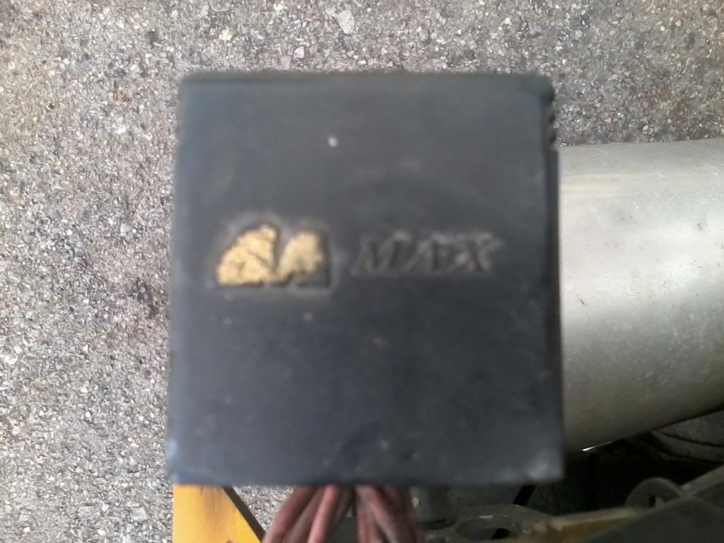

Is this an expensive boxed resistor to achive ultimate speed?

Bin the reg/rec. The only sensible explanation for it looking like that is it overheating. It's not got fins either, so if it hasn't destroyed itself, it's only a matter of time. 12.2V on tickover with the lights on is probably a tiny bit low. Define a quick blip of the throttle? Usual test is at 5K revs. If it's chucking out over 15.5V at that point, you're cooking the battery. There are loads of threads on here about charging issues, and also in the docs section there's a basic checklist. I'd search for a relevant thread (there are loads!) and then do a thorough check of it.

They don't locate anywhere (if you're talking about the inner two) the seat just rests in the sub frame. The outer two just screw into lugs on the seat unit, which in yours looks like it's been bodged on :)

The battery is obviously flat and although the charging system is working the output is too low to stop battery discharge at low engine speed. Do you do a lot of stop start riding with lights on? Below are the voltages expected from a fully functional charging system that connects directly to the battery.
Idle:
No lights 14.0 volts
Low beam 13.3 volts ( expect 13.0 volts with 55/60 watt headlight)
High Beam 12.7 volts
RPM to achieve 14.6 volts:
No lights 2000
Low Beam 2500 (expect 3000 with 55/60 watt headlights)
High beam 3500

The riders seat doesn't bolt to the subframe, it bolts to the seat unit.

As per previous answers regarding the reg/Rec and the riders seat and for your last question….Yes that is a M-max de-resrtictor that just plugs inline from the ECU (Big black box) at the back of the tail unit to remove the Japanese imposed speed limiter.
Plug it back in and enjoy
