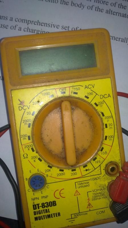

On to those 3 yellows, well never used a multi meter before for ohms so may have set it wrong (tip here would be good) all I got was a 1 on the far left of the screen on all of them, tried it on the different settings ignition on and off????? don't know what I was doing but don't think I did the test right, a-b, b-c, a-c???

The multi meter I'm (trying) to use

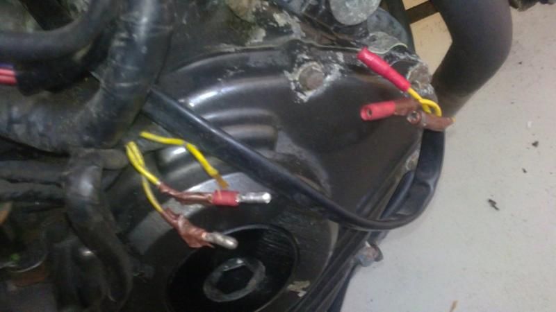

Alternator wires disconnected, I tested the ones on the left that went through the V the others came out the loom (am I right?)

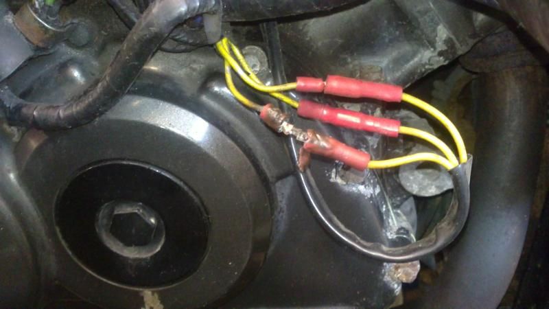

Found this where I guess a block normally is, one browny-burnty again.

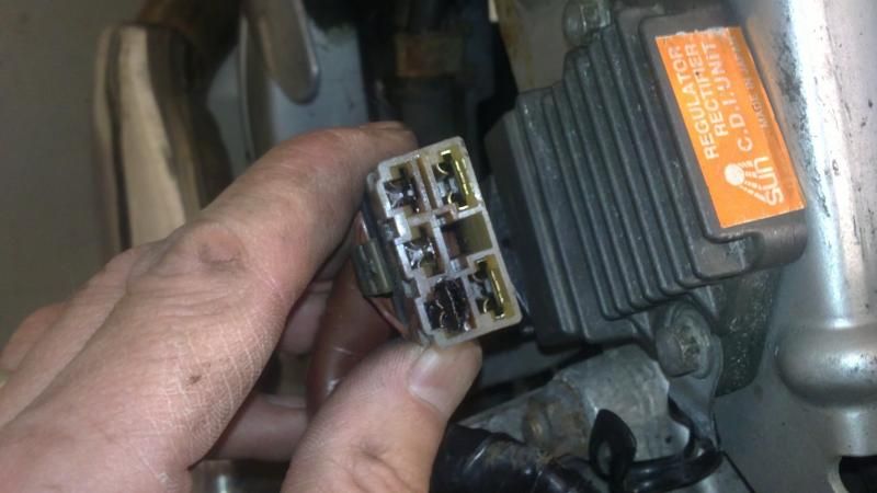

Reg/rec the connection bottom row right is browny-burnty looking, can I test the reg/rec?

Hi there the yellow wires ohms should be nice and low so 1ohm is good, I'd solder and heat shrink the break in them. Also either replace the burnt plug making sure the spades are really tight or solder the wires to the reg/rect. Yours is knackered so will need replacing before it kills the battery and then the stator/genny. You'd be looking for 13.8-14.5 roughly at 5000rpm with lights on. Easy fix just time consuming
Tornado
- Posts: 65
- Joined: Tue Jul 12, 2011 4:20 am
- Location: Alamosa, CO.
Re: Battery Charging???
Clean up all the connectors and cut back any burnt wires on the regulator and make sure you have good clean connections on the yellow wires... Then see what voltage you get at the battery. You can remove the pins out of the regulator plug with a small dental pick in the front of the plug . The female connectors will pull out of the back of the plug. If the wires are jacked you can always cut off the plug and solder or crimp on female spade connectors to each wire and just attach them directly to the male spade connectors on the regulator... In the right order!

You also might want to check ac volts on the stator (yellow wires). With the bike running at 4000 or so rpms you should have 50-70 volts ac ( if i remember correctly) between all 3 yellow wires (your mostly looking for consistency)

Tornado so the 3 yellow test running at 4000rpm AC with them connected together? or split and do the ab,bc,ca one against another thing. Also what setting would I put the multi meter too, I cant work that thing out?

Check the yellow wires with them disconnected on the engine case side...one multimeter probe to one yellow and the other probe to another. Don't connect (short) the yellow wires together. You should read consistent AC voltage between each yellow wire. This will tell you if the alternator is good.
Put your meter on the ACV 200 setting... As for the ABC thing... You got it!

3 yellow wire check all 54.8 all fluctuated by a .1 ish then did it again bike warmer all 48.1, that's pretty good right?
