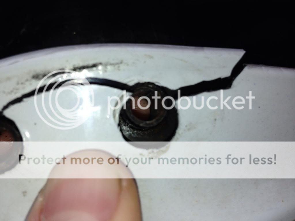

Also the left side of the nose cone where the mirrors attached is split:
Which seems to be due to the inner brace thing not lining up perfectly with the fairing, after replacing the mirrors i managed to improve the situation slightly but not as much as I wished.
Also cracks on the other side:

Looks like the blue needs to be repainted. Any cracks drill a 1mm hole at the end of each one this will stop the going any further. Mirror stay looks like needs a good 2 part glue like arildite good method is to use jointing tape that plasters use along the crack then put on the glue.

Your gonna need proffesional help to sort out correctly.
Cracks need repairing by experienced guy who knows bike plastics, then the whole nosecone will need repainting.
Other option is to bodge, I would just touch up/polish and live with the cracks rather than bodge it together.

Sounds good, thanks. Not sure how easy it would be to use one these cracks as there's not actually any material missing, or am I thinking about this wrong?taffnc30 wrote: If your serious about having a go yourself I could attempt to post a process chart on here to assist?

Your right they are tricky hence the advice to source someone with experience, I will scan the process charts for you when I get chance and post them on here for you, should be by the end of the week.
