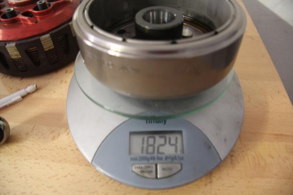

I have removed the flywheel but left the stator in place. The kilo will not make a difference to me at this stage - but I sure didn't want to dick around with sealing the grommit. So, it is all left there with only the flywheel being removed.
Gone:
And here is how much rotating mass was involved:
Quite a bit. I am a bit crap at race starts, and this will likely make me more crap ... so I better get practicing!

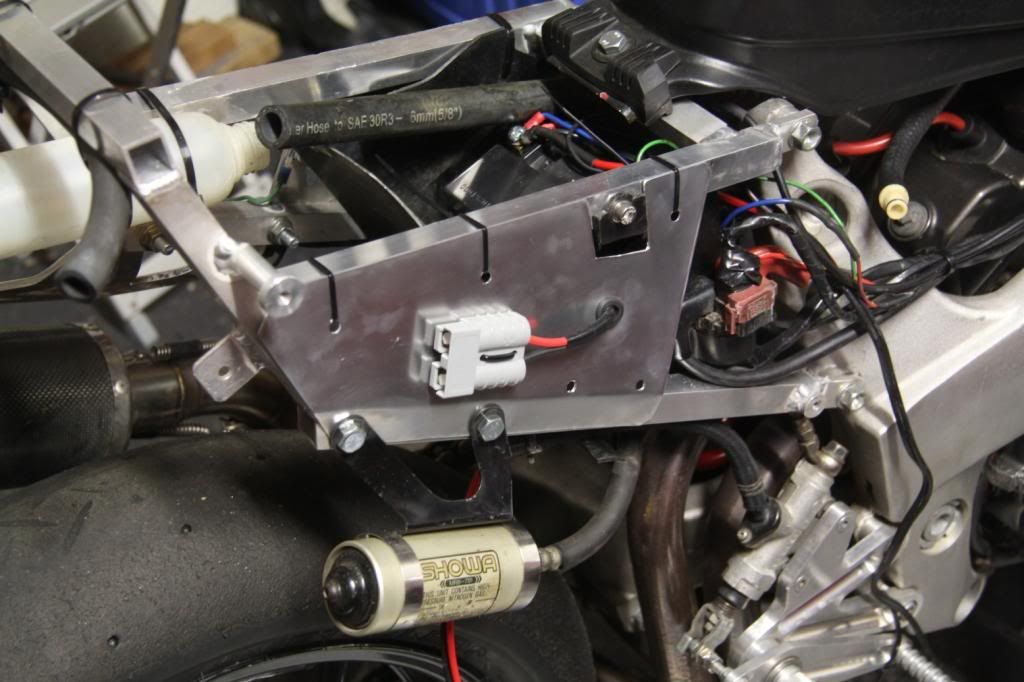

I made a aluminum plate for the right side of the subframe to mount the connector. It looks like a lot of real-estate for a single plug, but I wanted to to be easy to get at under the seat cowl with no mucking about and I wanted it to be shielded as well as I could from wheel/water etc (also, I have a rubber end-plug for it on order). I could have tied it to the subframe but the result was a bit wobbly, exposed, and not that great. The fabrication is a bit crap, I am pretty new to this stuff, but I am happy with the result.

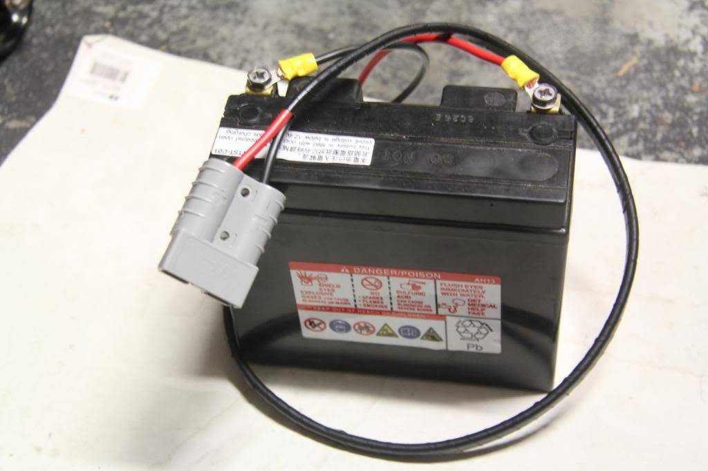

I normally take a spare battery with me to the track to help with starting if things go wrong. It is a Ducati 999 battery so it has some grunt. I wired it up to another Anderson connector so I can just plug the damn thing in to help the bike get started if required.

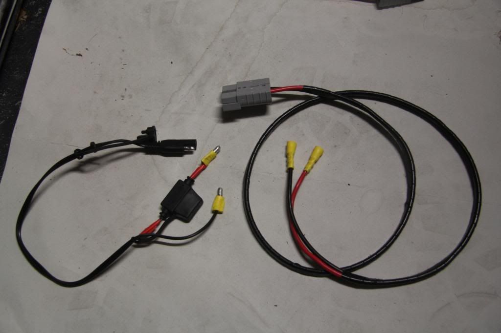

Also, for the trickle charger I used another Anderson connector and also butchered an SAE connector trickle charger lead with plugs so I can use my other (non-SAE connector) trickle charger without redoing the Anderson connector:
Gone:

And, even with my little non-LiOn $60 battery, I could get a good charge between sessions and had no issues at all. Over lunch break, the battery tender on it got back to 'green'. As I came in from each session, I just hooked up the anderson connector jobby above and it was all good.

I really like your set-up with the Anderson connectors, etc, looks nice and neat. I might have to give it a go myself one of these days.

The Anderson connector thing worked well. I got mine from jcar - the 50amp one. Much cheaper than other places and the real item - not a fake. The rubber cap is a must. Seals well and protect connector from grime. I got them from here:
