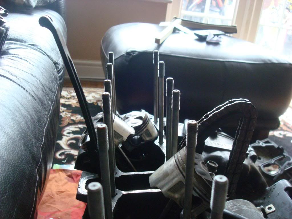

I left it for way too long and when I attempted to fire her up again, it wouldn't turn over

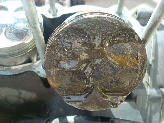

Water was in the cylinders.
This is how one of the pistons looked
I then left the bike again for a period of time......The only reason really being, i didn't know how one of the cam chain guide goes in

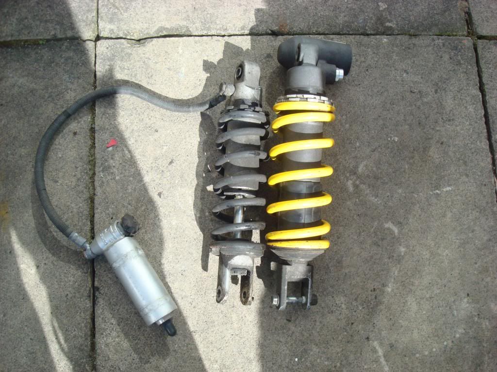

Decieded to do the rear shock swap which i've read being done...I already had a k6 thou one, so that's what I went with.

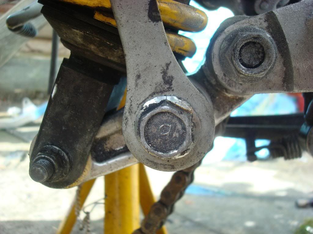

Was worried at this point;
Not a lot of clearance but when i hooked everything up, was a bit more satisfied

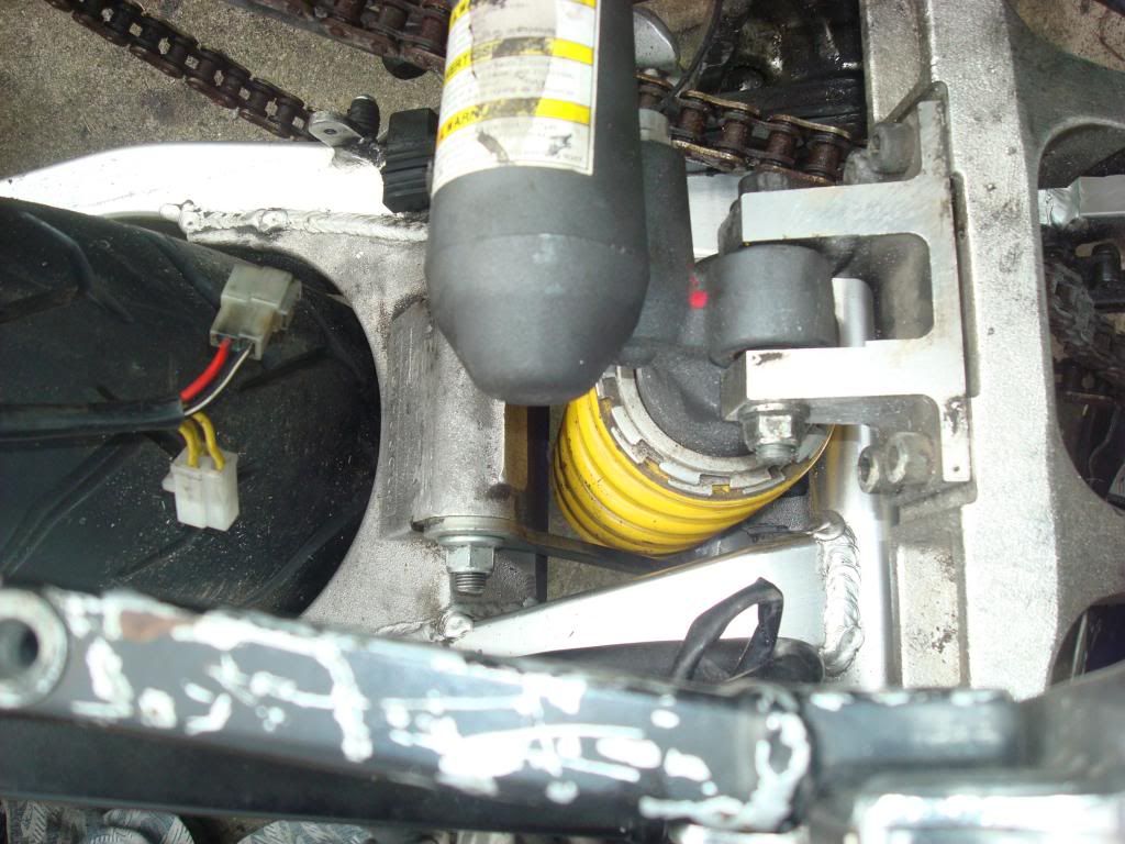

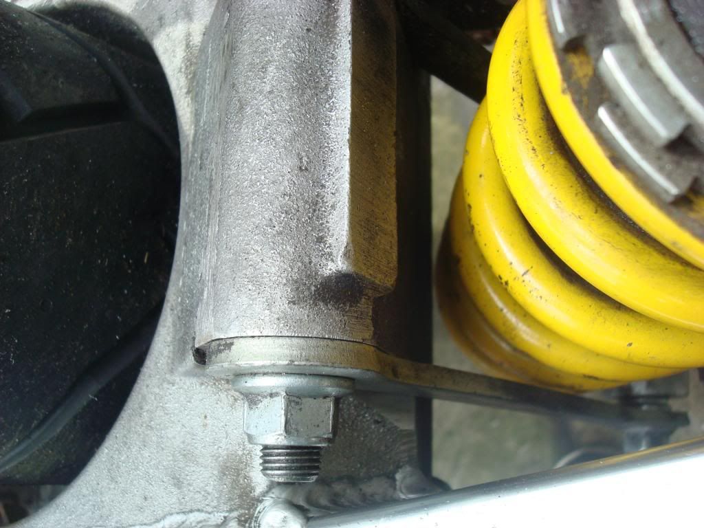

My only real concern is the rear of the shock, between the shock and swinging arm;
Just doesn't look a lot to me
I'm sure given enough force it will touch......any one else had this issue?!

I've been looking into doing this thanks for the link and the close up pictures . It does look close tho

Dont want to worry you but your new shock looks a fair bit longer .Dont know how that would effect the handling of the bike . Ive just picked up a k7 750 shock and looks to be same length as the original.

Yea thanks mate....I'm guessing you're right.panda wrote:Dont want to worry you but your new shock looks a fair bit longer .Dont know how that would effect the handling of the bike . Ive just picked up a k7 750 shock and looks to be same length as the original.
It does seem pretty close, especially when you compress the suspension!
Once i get the engine in and running, i'll see how she goes, otherwise I mat get the standard one refurbished....thanks!

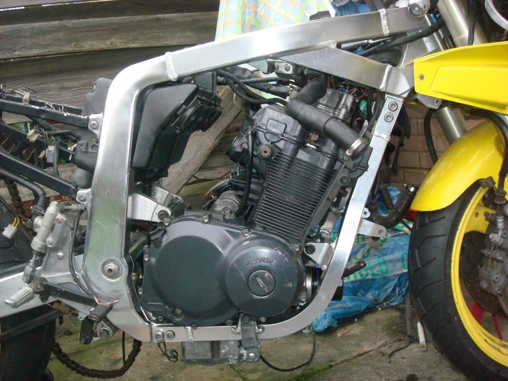

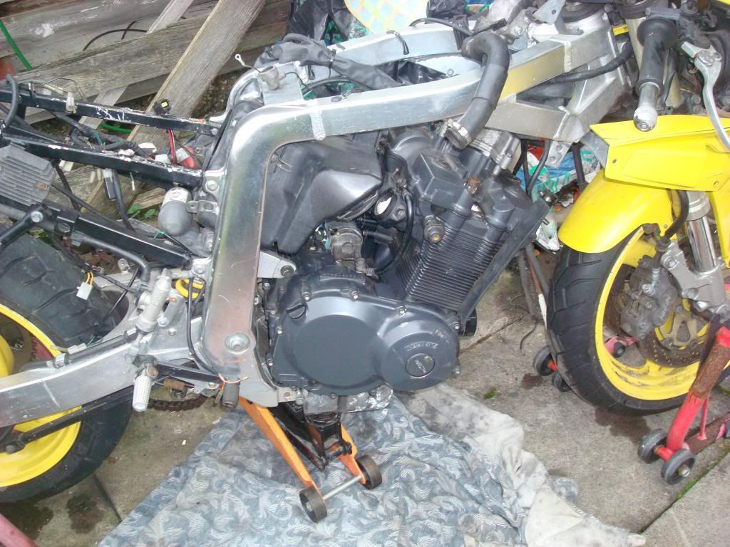

A little progress.........Engines all buttoned up, with new head gasket and back in frame.
Must say it's good to see the bike with the engine in........Will be giving the carbs a going over, not that I know what I'm doing
