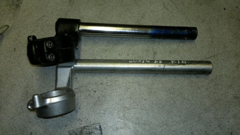

Heyup folks,
I've been trying to find some raised clip-ons for me nc30, but I after a lot of searching i'm trying sv650 clip-ons, there 41mm and pretty much bolt straight on, I've only tried on the left one so far (I only bought one to see it they'd fit). Only problem so far is lack of fixing for the bar end weights, but should be easy enough to sort. Clearance will be tight I think, but should be a small gap!!!
Heres a quick pic of the difference,
Will post up when other one arrives and I test fit both.

Re: Nc30 - SV650 clipons
Nice one, I'm in the market for some bars that have a slight rise over the standard 30 bars, these could fit the bill on the cheap.
I'll be interested to see what angle the bar sits on and if the sv clamp 'spigot' sits nicely in gap of the nc top yoke.

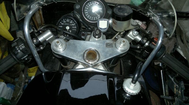

Heres a quick pic of the sv clipons. They dont hit anything on full lock, its close but ok and the cables aernt too tight either so hopefully it'll help me back a little bit.
Good outcome, I'm on the lookout for a pair.
If you put the forks back to flush with the yokes it will take some more weight off your wrists also making the ride more comfortable.
