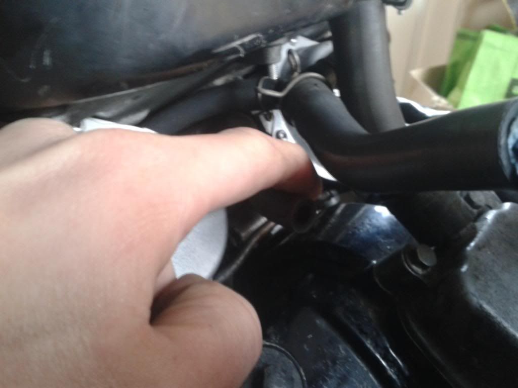

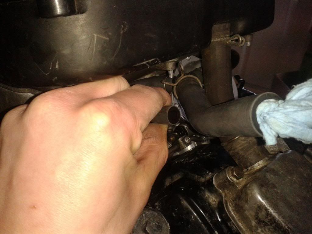

The thin tube should not be fitted to the carbs at all but the vacuum spigot on the left rear cylinder. The spigot on the carbs should be blanked off. A pic of exactly where it is connected to the carbs would help though

So am I right in thinking that there should be a tube from carbs that remains unconnected and only the main fuel feed hooked up to the carbs?
Presumably there then needs to be a tube ran from the horizontal spigot on fuel tap to spigot on left hand cylinder?? The bike was not hooked up like this when I bought it which may explain why I still can't get the rear cylinders to fire!
