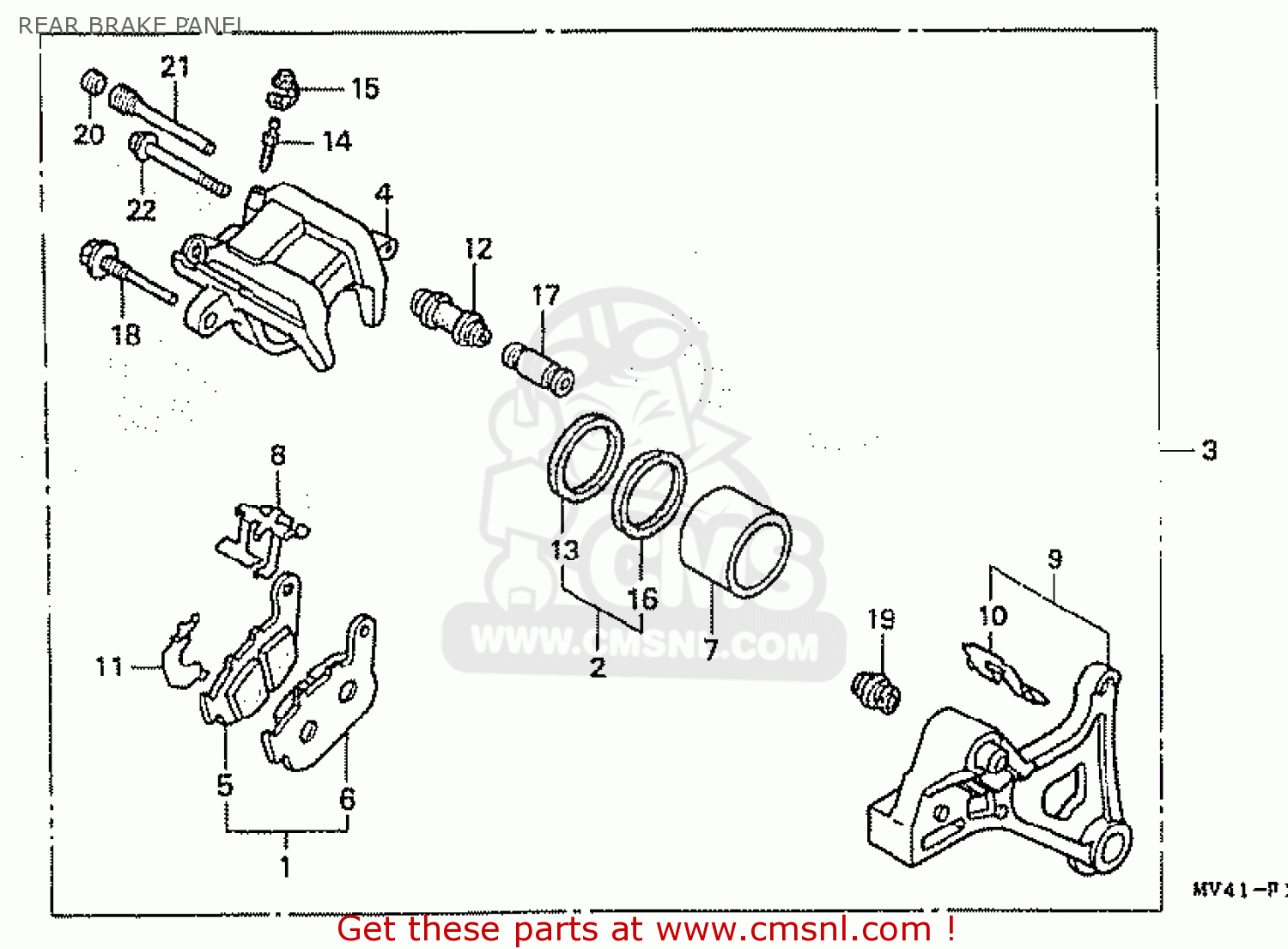

Right everyone including myself told me not to attempt to do my own brakes....
Finished work early and have a guess what iv had a go at :/
Everything's sorted it's just the little clip that sprung out so I didn't see where it went. Assuming it goes down the back of the calliper somehow but not a scooby do where... Help?

Thought someone more knowlagble would have been around to help you out but it looks quiet. So the small clip goes to the front of the caliper on the inside. Have a play around its self evident. It keeps the front part of the pads in place.Theres also a similar one at the pin side But if its another larger flatter clip could be the anti squeal shim that sits on the rear outer pad. For a better idea look at the parts book or the parts book at csmnl.
Here: http://images.cmsnl.com/img/partslists/ ... 2_2678.gif
