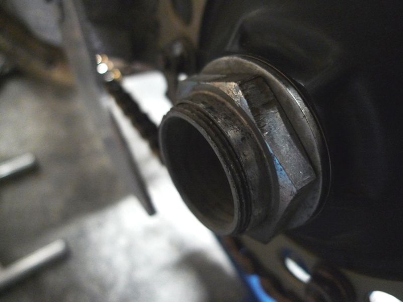

Hi all,
There are reuseable NC30 hubnuts out there - I think kyla (kayla?) does a drilled lockwire-ready nut. But .. what do you lockwire it to?
Anybody got a pic to share that shows their lockwired hubnut?
Many thanks,
Greg.
Re: NC30 Hub nut reuse - where to lockwire?
If you use kayla's hub nut you will need to drill threaded part of the axle and then either lock pin or lockwire it, theres no provision for it using a standard hub nut just stake it as per the haynes manual.
Post by porndoguk »
I drilled into the hub where the groove is, took for ever VERY HARD METAL!
Post by StrayAlien »
You needed two holes then (wire in and out)?
Righto. One hole and lockwire out to the edge. Got it.
Popped out to garage (yes, I known is is 1am locally - but some things are *important* :-) )
Not much room here. Looks pretty different to the pic above in terms of area on the threaded part to drill holes.
Any thoughts?
Looks the same to me :?
mmmmm. okay. Got me. Had another look at photo. Yes, probably the same. Been a long night - had two nights of shit sleep camping at the trackside campground at Phillip Island for the Oz MotoGP.
Post by arsey30 »
Will the paddock stand still go into the axle, wired that way?
You could lock wire the same way as the factory did the RC.
