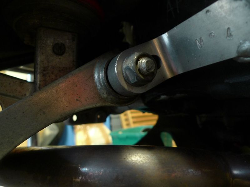

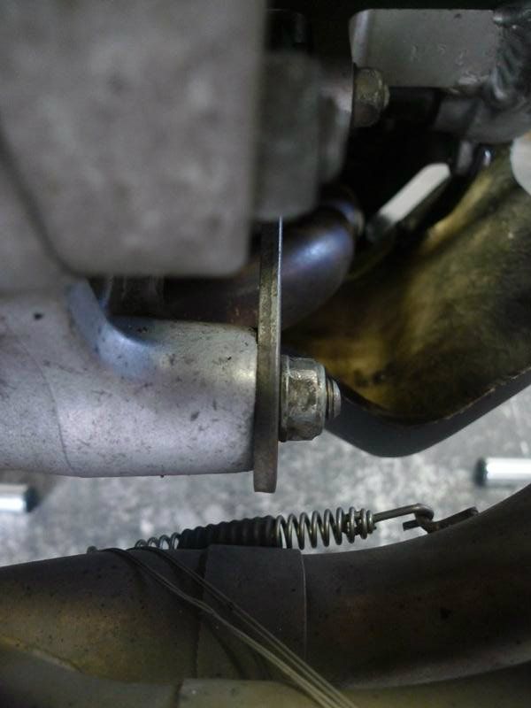

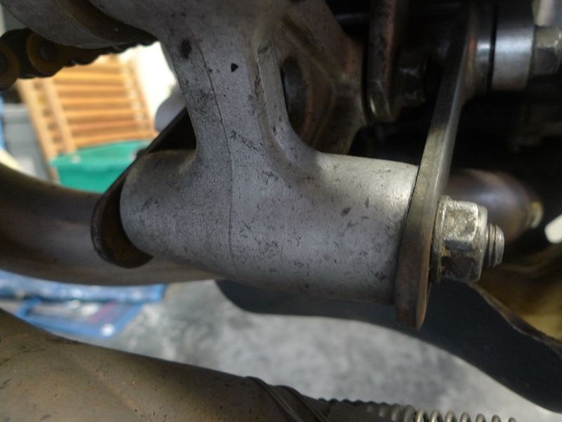

Question 1: metalistic bush
(he heh .. he said 'bush')
Section 10.10 chapter 6 of the Haynes manual refers to a "metalistic bush rather than an needle bearing between the linkage pivot and the shock" and that is is 'essential' to take note of the relative positions of the shock and the pivot before separation.
What??
Question 2: Is this weird?
The left side of the linkages seems to have a gap and the right does not. Check it out:
Left:
Right:
Look like bad news?

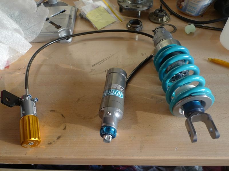

Here is the newly-cherished item:

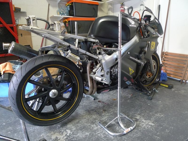

And here is the willing recipient. My '94 probably-never-seen-a-road-in-its-life NC30 race bike:
I haven't taken thing to bits yet, pending some feedback about a few things.
What??
Left:
Right:
Look like bad news?

All I can say is that on my RVF the linkage is sat to one side as per your pic, and I did ask about this before but got no answer... so I'd be intrigues to know too! Is that the hydraulic pre-load option on yours?

Yes, that is the HPA on it. "if you're gonna be a bear, be a grizzly".

I was going to go with the full works setup like that, but I read that having the HPA removes the ride height adjustment option on the NC30/35. No idea why, I guess there's not enough room or something like that. So I figure I'll spend the HPA cost on a fork upgrade kit instead... :-) Can still change pre-load the hard way, and have something else to tinker with that I don't understand... lol

Hi stray alien I also had the same query as you have in your question 1, this is the post that I posted at the time hopefully it helps you a bit? viewtopic.php?f=24&t=18265

Nope. It has the ride height adjuster as well as the HPA.speedy231278 wrote:I read that having the HPA removes the ride height adjustment option on the NC30/35
ok. Torque values sorted. 'Metelastic bush' sorted (people seem to ignore it, and I'll but putting an RVF linkage on now anyways).
Do other VFR/RVFs out there have the same gap of the left of the shock linkages and no gap on the right. Is this normal?
Greg.

No gaps with mine as supplied by RO.

You have RO's HRC linkage?magg wrote:No gaps with mine as supplied by RO.
magg
- Posts: 1921
- Bike owned: VFR400
Re: New Nitron shock install - help required (pics)
No HRC linkage, although setup included shock length extension as recommended by RO.
