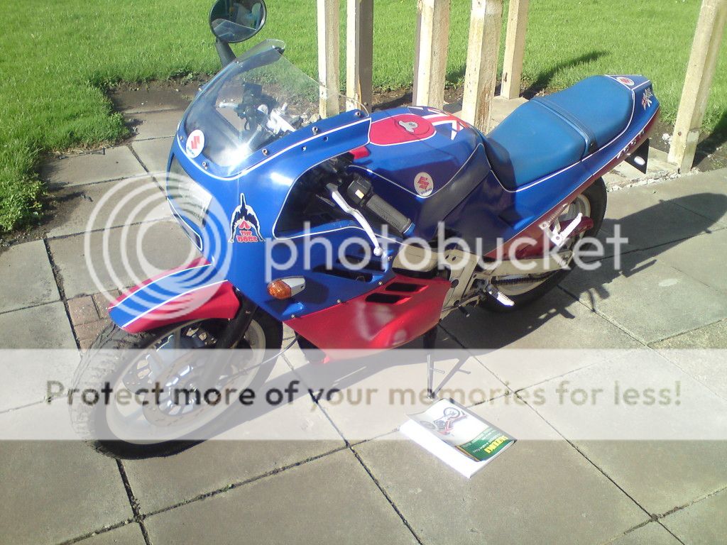

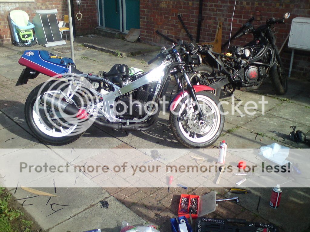

The bike an hour after it arrived and had a quick wipe down ... plastics and such are in good condition other than the horrific paint job

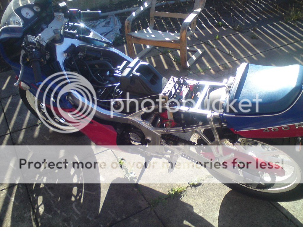

began the tear down ... battery is fucked
agm replacement motobatt AGM fitted
frame cleaned up really nice and the exhaust system is in mint condition even has newish looking gaskets and stainless bolts
Gave the engine a bit of a clean and its all looking in good condition :)

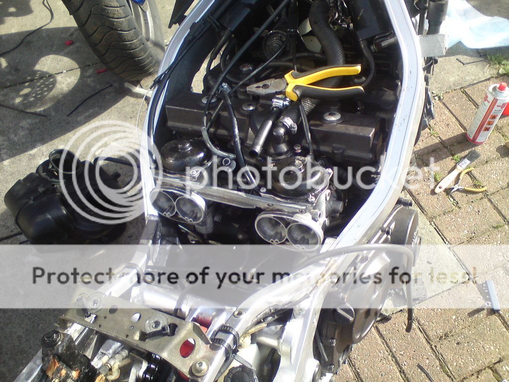

bloody weird carbs
1 slide & float bowl for two carbs never worked on anything like it

carbs stripped and being cleaned out thoroughly lol took ages too get the jets free ...
and semi rebuilt ......IT LIVES

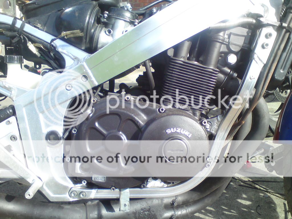

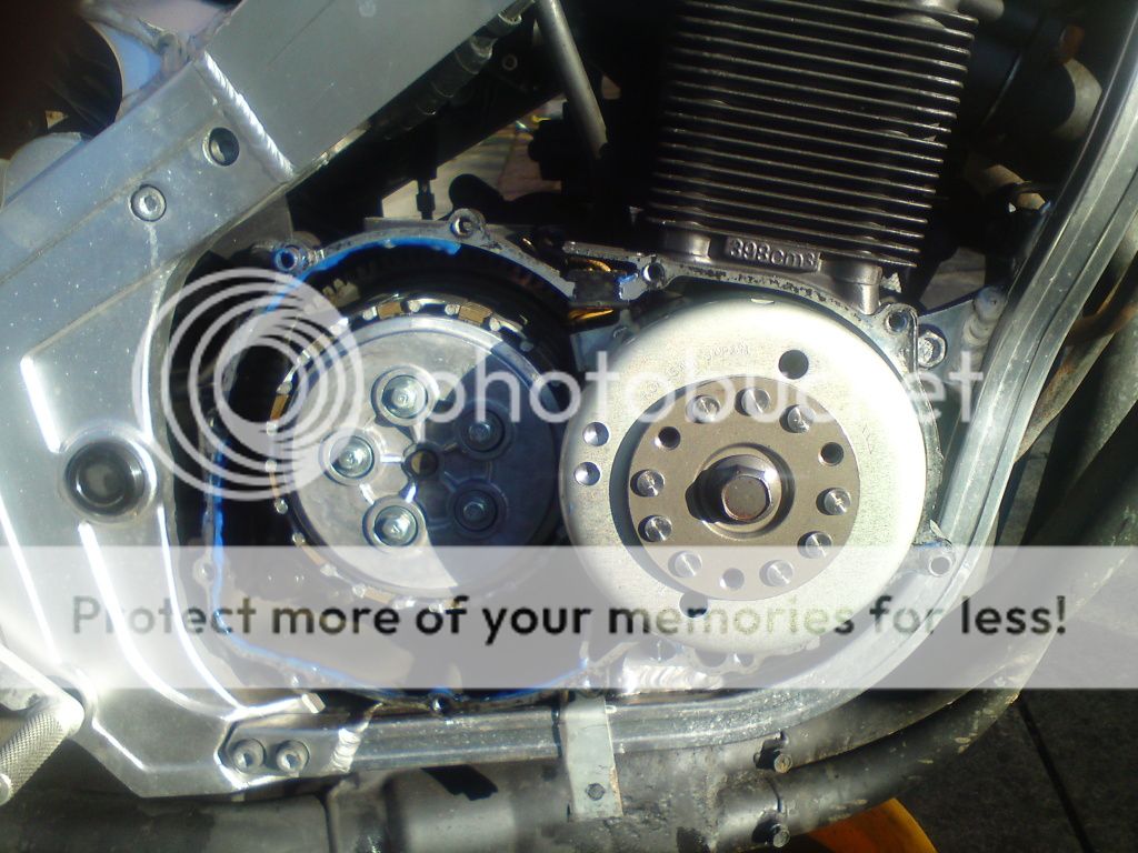

Oil leak from clutch cover but it looks like it has RTV not a proper gasket so an easy fix
i think

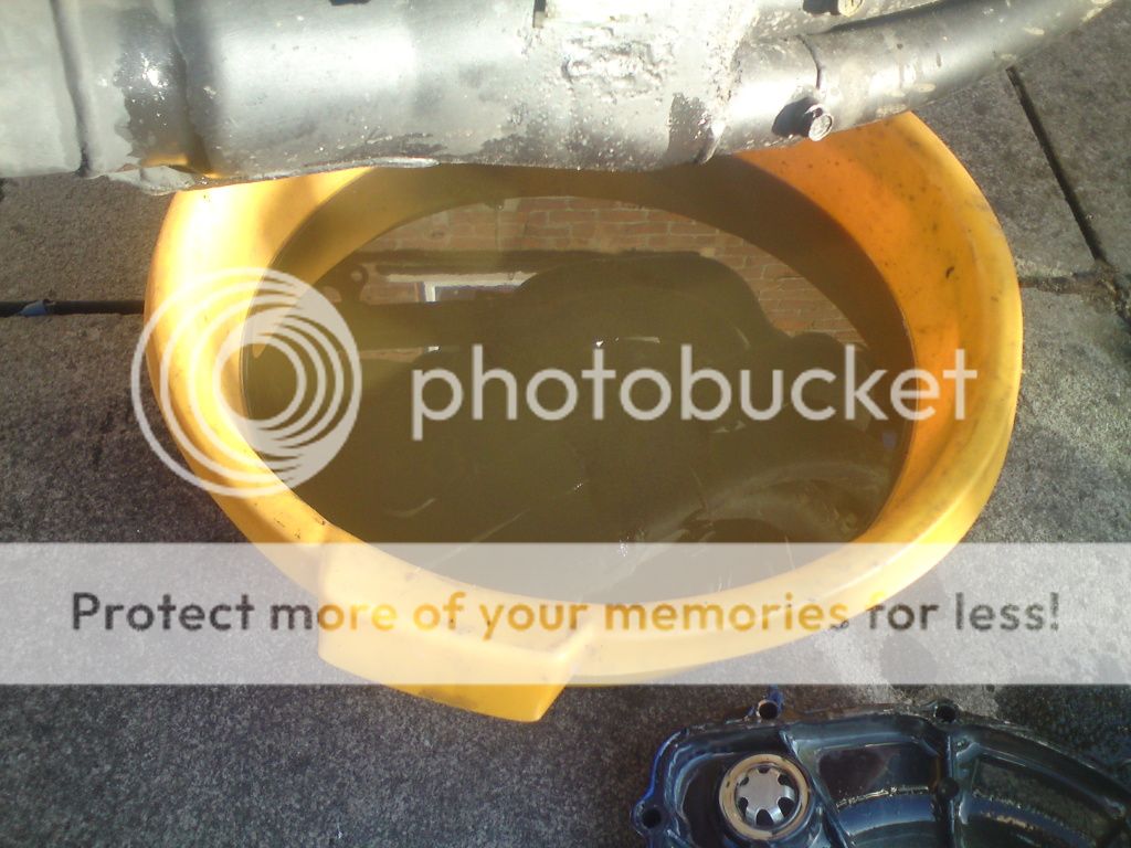

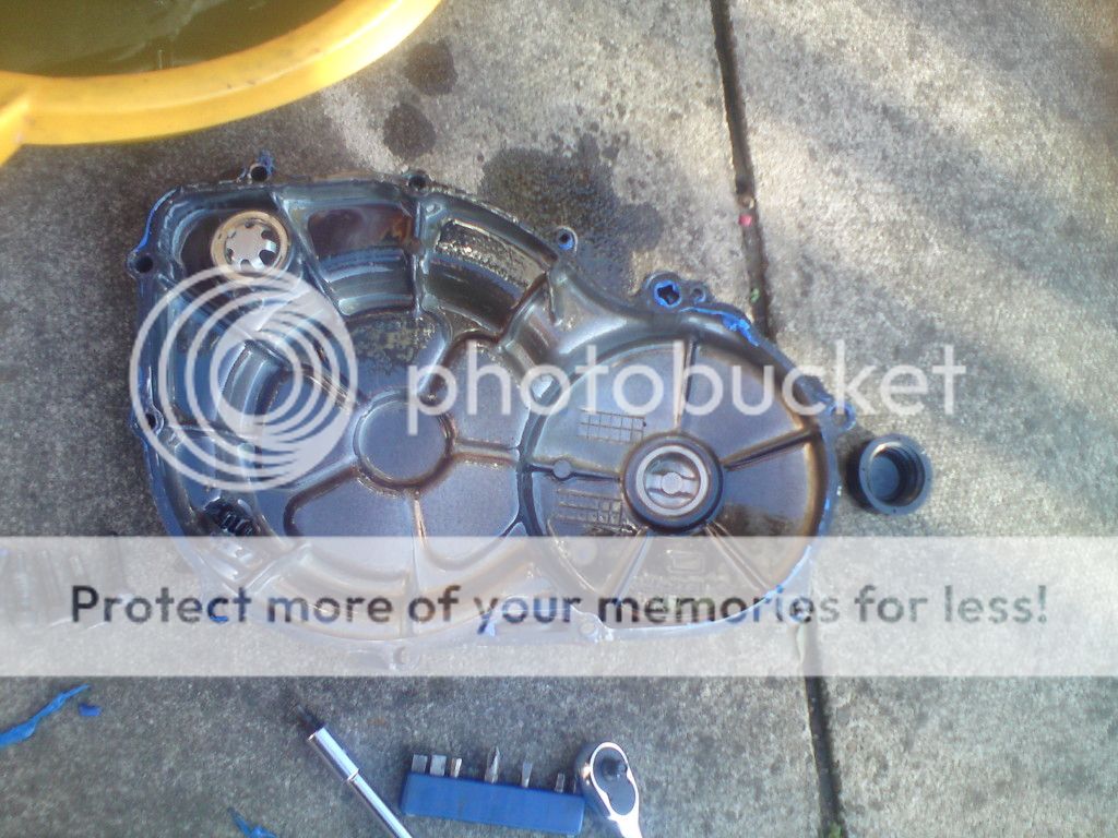

Dumped the oil and got this mess
spoke too a friend who restores bikes and he said for the sake of seven pounds too just refill the oil as it "might" be condensate in the oil from the bike having been stood an unknown amount of time before i bought it .
any way decided too sort out the oil leak ...
prior owner is a fool who used that blue stuff instead of a proper gasket . No wonder it was leaking
made one myself out of the gasket paper i picked up on impulse a few weeks ago
refitted and bam no more oil leak :)

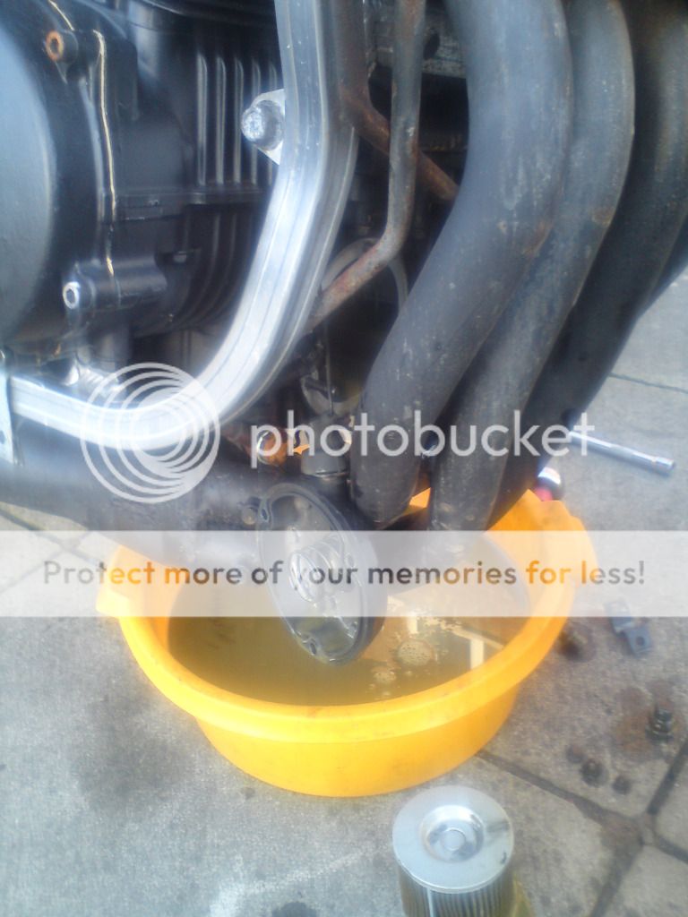

decided too crack on and do the filter while i still had some light too work by ...nuts were a PITA too remove
Its completely fecked
Got new filter in fresh oil in and started it up ....running a lot better but getting white smoke so think it might be a blown head gasket after all
