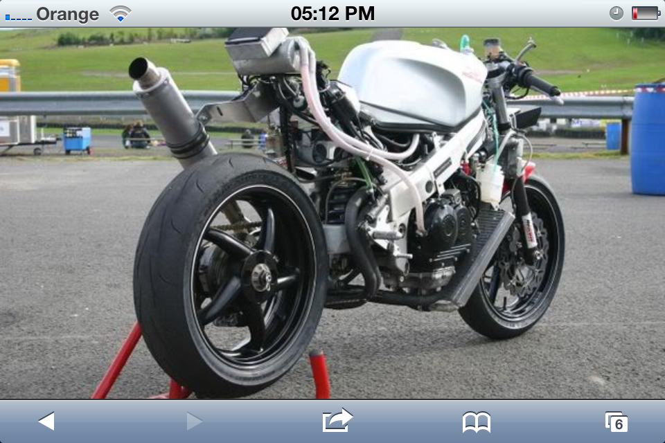

this is a VFR750 rear wheel but held on a standard nc30 hub, i think.

any pointers??

Modified wheel to make single hole for nut.
Seen a couple of these about lately.

I thought the locating hole in the wheel was the same diameter, but the stub axle was too short to allow you to just put the vfr750 rear on, and a vfr750 hub doesn't/won't fit?
If its just a case of milling out the centre locating hole in the vfr750 wheel, well that seems pretty simple!

Nut sure about the axle but i wouldnt have thought the wheel was any wider at the mounting point.
If it was the 750 hub they would just use the 4 bolt holes surely?

Also just seen this on Rick olivers price list.
NC30/35 VFR750 rear wheel conversion £125 exchange
(modified axle complete with studs & nuts + 5mm chain spacer kit)

Yeah yeah I know that you can buy the exchange kit from rick, and it's quality kit, but if I can mount the vfr750 wheel rvf400 wheel and vfr400 wheel on the same stub axle hub assembly then that'd be really useful, tho I doubt it's possible, but I'm still intrested to know how it works!

have a word with colin aka forceV4 on here, he has a 750 wheel for sale with the conversion for the 30 hub i believe

That wheel with the 4 holes filled in just looks plain odd!

Hmmm sounds like it needs a converted axle, so dunno if you'd be able to take the vfr750 wheel off and bolt the rvf/vfr wheel straight on without changing out the axle!
