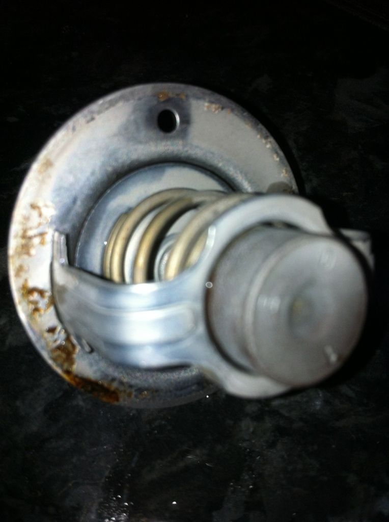

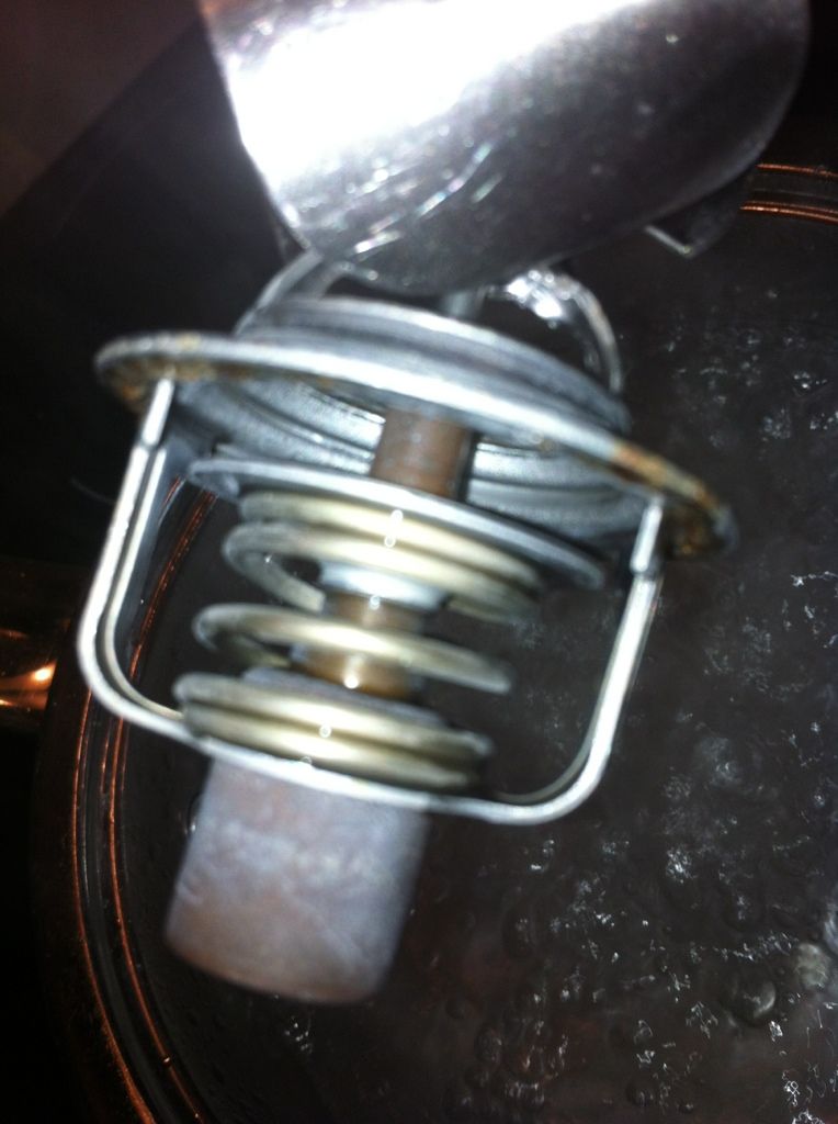

right i had a look in the haynes and it said the thermostat should open 8mm
this is before being cooked & is closed
and this is open
does this look ok , to me it does seem about 8mm , but then should the spring be fully compressed , if this thermostat is ok and works ok , what else could be causing the over heating ?
im soo losing hope with this bike
and this is open

Coincidentally, I 'cooked' my new one at the weekend. It won't fully compress the spring, as long as you have 8mm between the ring above the spring and the main body where it seats when cold, it will be fine. That assumes it shuts fully when it cools down, 'cos if it doesn't the bike will take ages to warm up. It also assumes it started opening at the right temp, which off the top of my head is around 80c. Again, if it doesn't start opening at the tmep listed in the Haynes and doesn't reach 8mm by the temp stated, it's shot.

great reply bud cheers , i have indeed done all the tests on the gauge , shorting it to earth etc and the gauge is working , its hard to check the gap cause as soon as its out the water it starts to close lol ive brought a second hand replacement so im guna just use that now ive brought it lol, im going to clean the rads as they are currently off the bike , they dont look damaged too bad , obviously there is a few bent fins , but no massive patches of em
