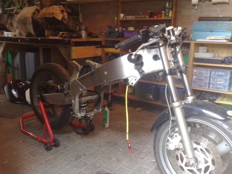

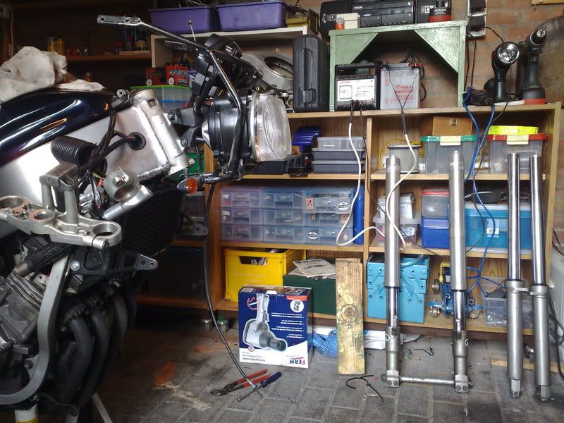

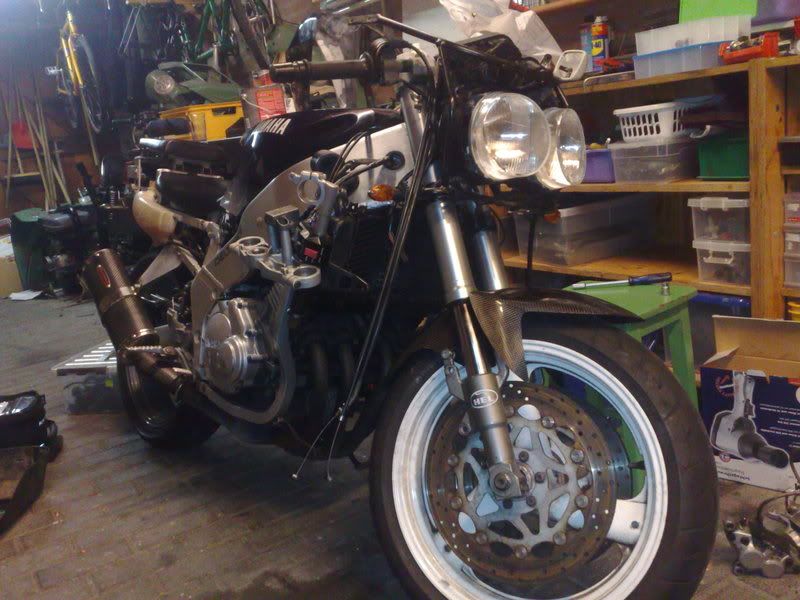

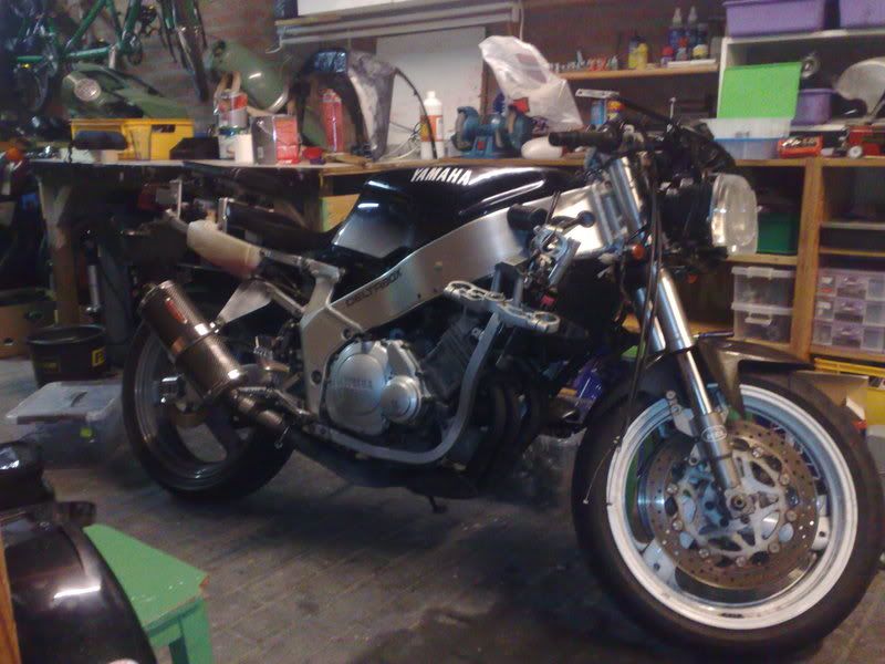

Got my frontend from an FZR1000 in this morning. Went and got some new bearings and a few hours later i have an USD in my FZR400 :)
How i started this afternoon:

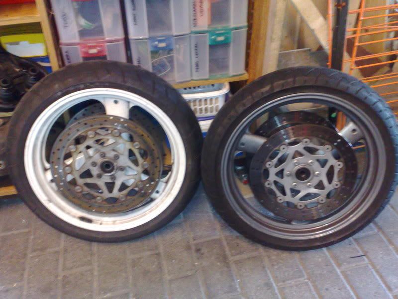

320mm disks :)
Spot the differences
And how she stands now:
Still to come on the front end:
- Powdercoated wheels in balck
- Repainted fork lowers
- Brembo brake disks
- And a WHOLE load of small things

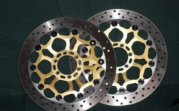

320mm disks :)

have you used the original yokes ?

Doubt it - upside downs are a lot fatter at the top than Right ways .... I personally think the FZR 1000 (Foxeye ???) front end will be a bit heavy for the 400 but as the parts are around from your other bike whynot do it.rrsp wrote:have you used the original yokes ?

Nope, didn't use the original yokes, but the stem on the FZR1000 is exactly the same as the one on the FZR400. So it's a 1 on 1 swap. All that i had to do was mod the steeringstops a little.
The original springs are a bit tough for my 400, but keep in mind that i am just under 100kilo and 187cm. FZR1000 forks standard have 15W oil in them, and now they have 10W oil in them. However need to go out and have a ride to test them. Atm it just looks 200% beter, if it improves steering and damping by 50% im happy.

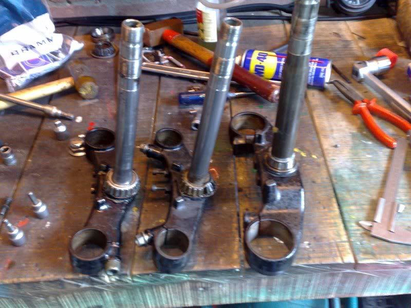

EDIT: Maybe some useful info for the FZR enthusiats around here.

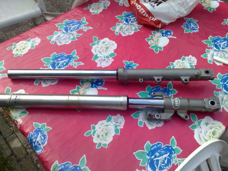

The FZR 400, FZR600 and FZR1000 all have the same bearing sizes, which means that the forks are interchangeable.
f.l.t.r- FZR400/FZR600/FZR1000
The FZR400 and 600 have the same steering stops.

Cool ... that's interesting - you can see the difference between the 41mm (400 3en2) and 38mm (600) forks in the last pic.

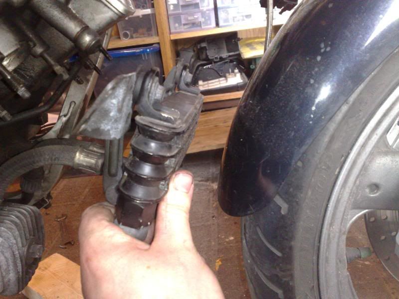

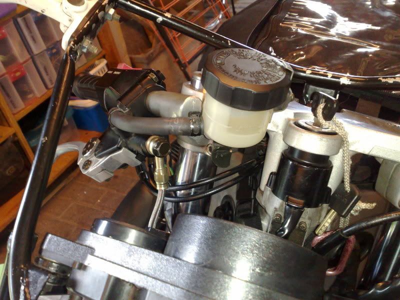

Rearsets look nice and the 1000 master cylinder looks similar to the TJ master but I suspect it's a 20 ratio.

Yup, the 600 has damn skinny forks compared to the 3EN2 en and the FZR1000.

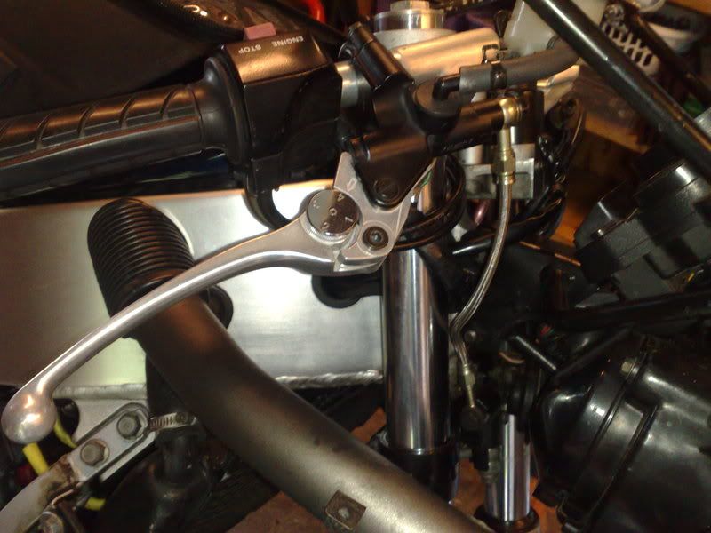

The mastercilinder is off a 600R (4JH), so i wouldnt be suprised if it was the same as the 3TJ. Makes quite a difference, not really in brake power but much more feel because i can finally reach the handel with my small fingers :)

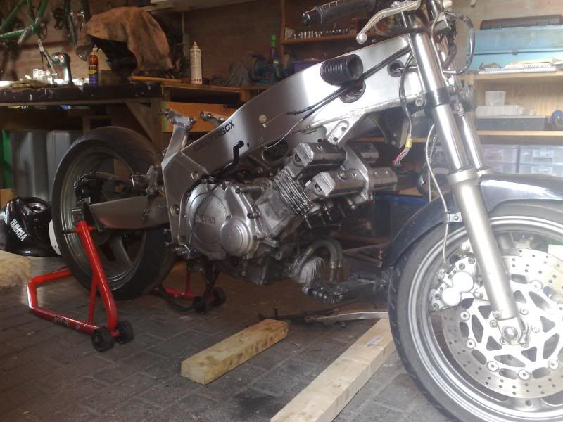

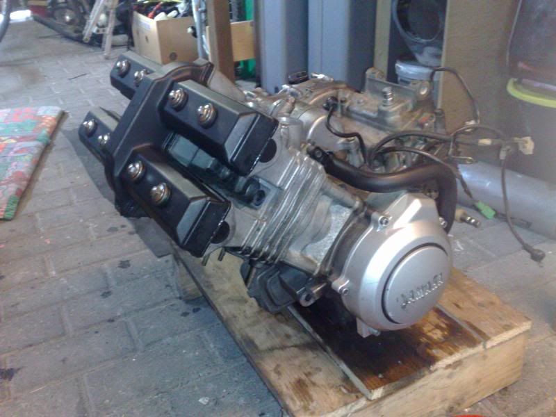

Might as wel post my other mods here then. About half a year ago i bought a complete FZR600 for very little without fairings, as a donor for my FZR400/600 conversion. So one cold but clear febuary morning went to pick up the FZR in my Jetta, and yes, a complete FZR fits in Jetta:
Prepped my FZR400 to take the FZR600 lump:
And about half a hour and four cigs later we have an FZR600 in my 400:

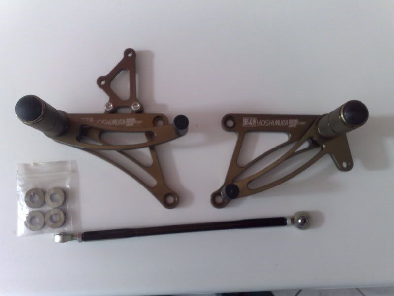

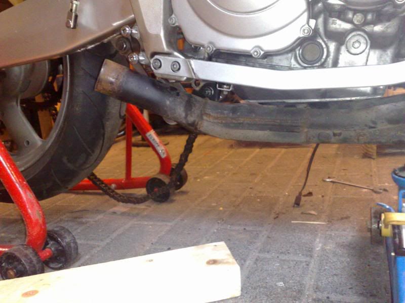

And the FZR600 headers didnt clear the rear-sets

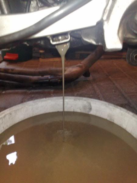

However when i wanted to change the oil i was in for a nasty suprise
Most probably a blown head gasket

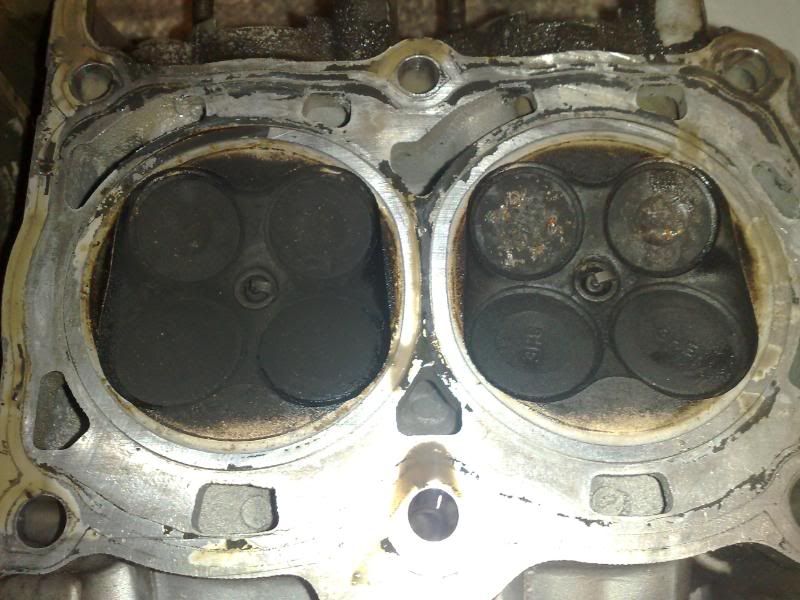

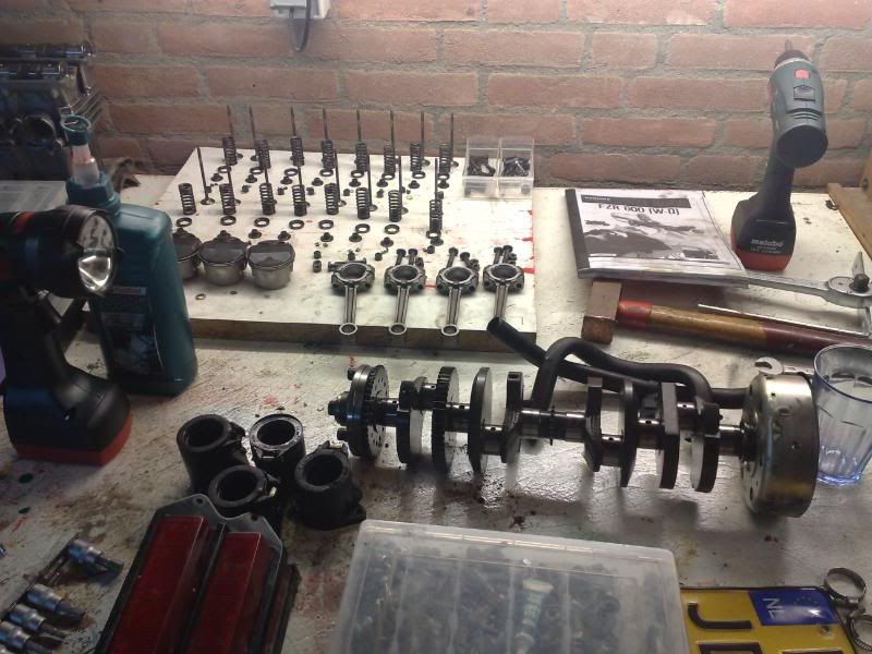

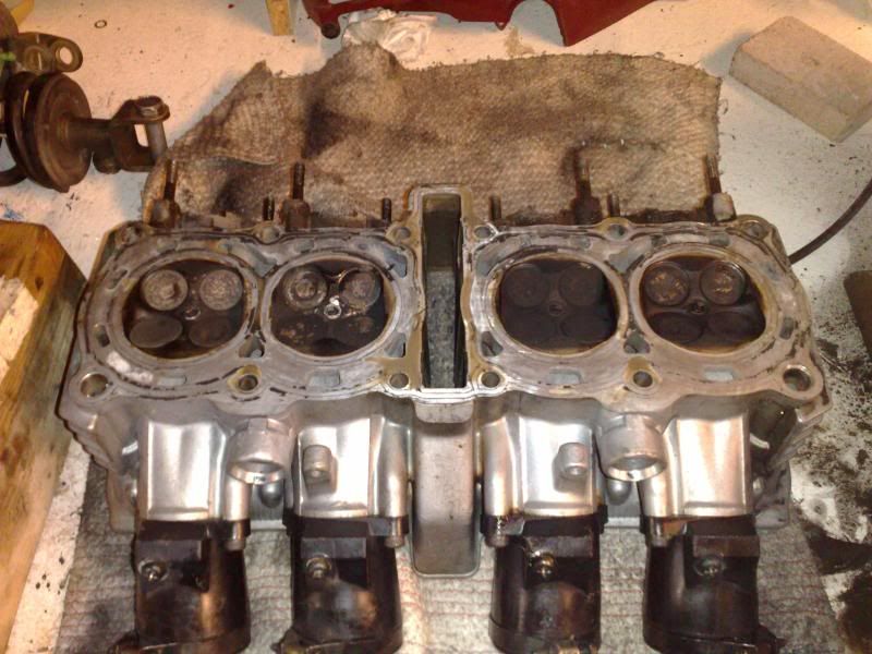

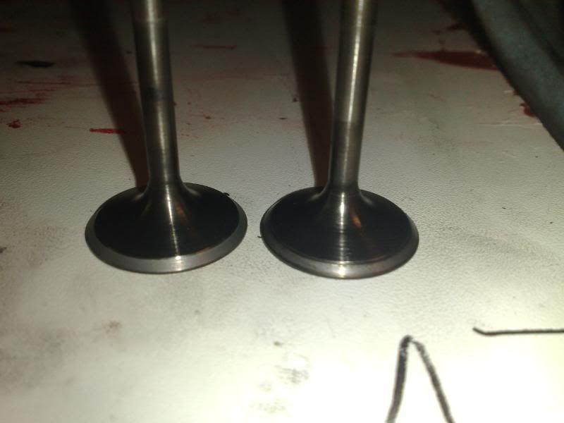

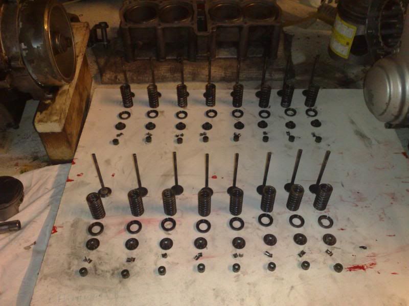

Then started pulling apart the 600 lump
Before:

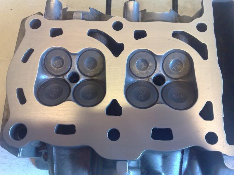

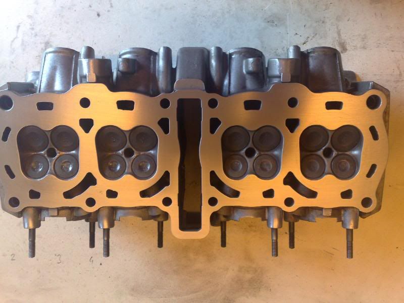

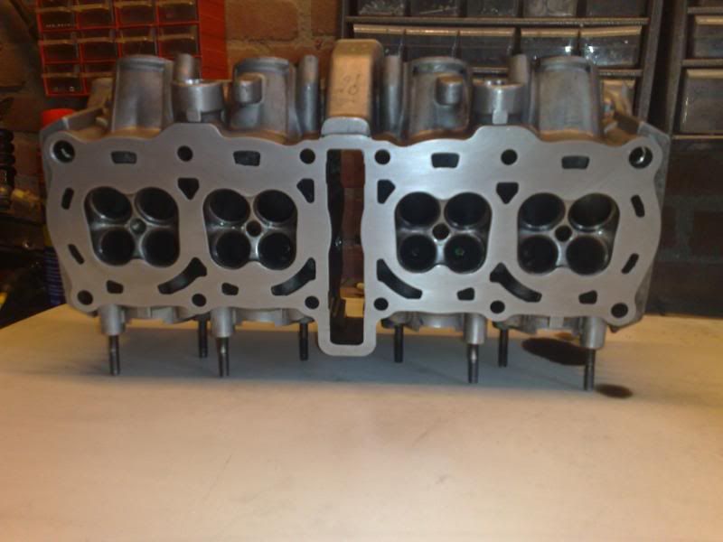

After (skimmed head)

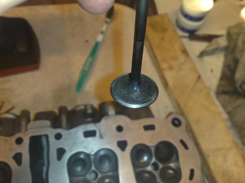

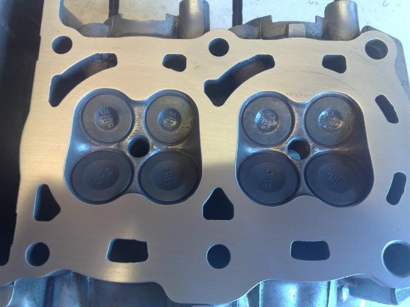

Valves:
And a few friends came to help out

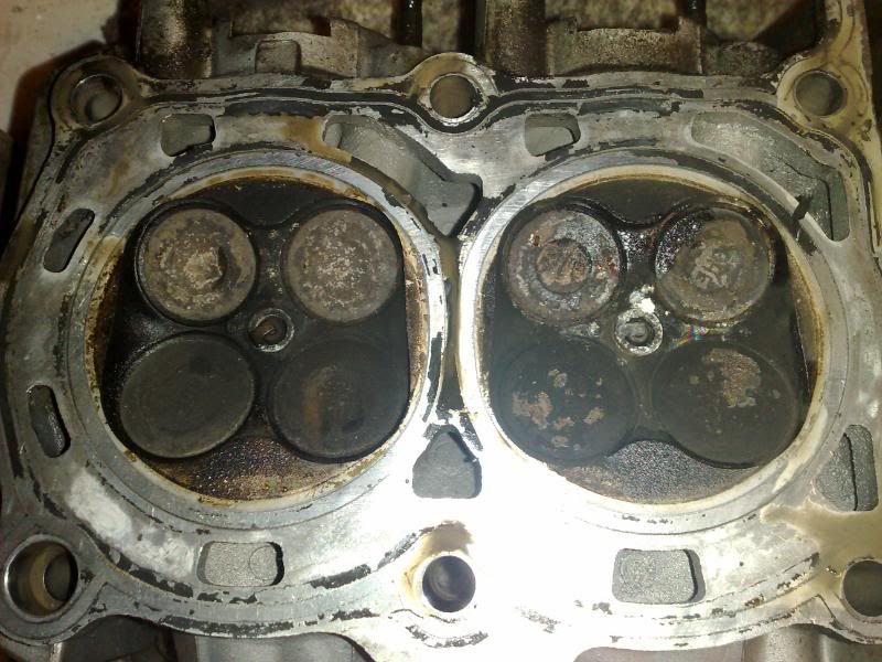

So pulled out the 600 lump again and prepped the 400 lump to go back in so that at least i can ride around
Before:
Valves:
