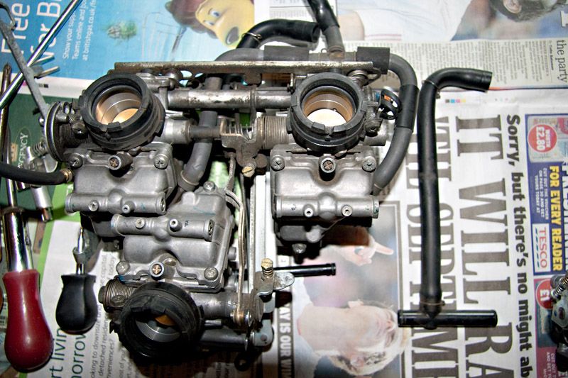

Right, here goes with the first stage.... please note that as I feared some of the pics are pretty crappy, so when I pull the things apart again for cleaning when I've actually got something better than Fairy liquid in the ultrasonic tank I'll make sure I'm set up a bit better for pics! Assuming you already have the carbs off of the bike, you need a selection of medium sized cross-headed screwdrivers (I find that you can always find a slightly better fit than the one you pick up first!) at least one with a fairly thin shaft, a medium sized flat headed screwdriver, a 7mm socket with a fairly thin wall, a 10mm socket, a pair of small pliers and something like a small nail, heavy pin, thin welding rod etc (to push out the float bowl pin). For those like me who didn't know what the numbers were, the carbs (and presumably cylinders) are:
Front left 2 4 right
Rear left 1 3 right

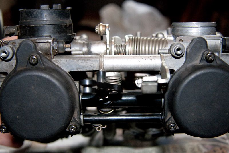

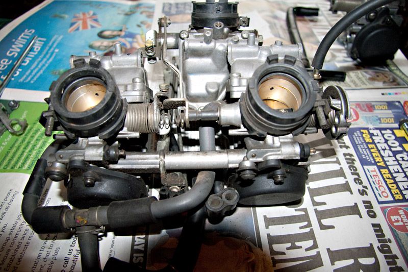

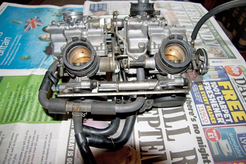

General view of carbs with underside facing up. You are look at the front carbs here, and as they are inverted, it's carb 2 on the left and 4 on the right. Carb 4 is missing it's rubber (or insulator as Honda call it) as this was the one I experimented with in the ultrasonic bath. Despite only having washing up liquid, you can tell the difference already. The carb rubbers go hard over time, and apparently if left with either or both ends off the bike or carbs for any length of time they start going even harder, misshapen and shrink. They are not identical, cyls 1+4 (16211-MR8-900, £6.95) and cyls 2+3 (16221-MR8-900, £4.75) having different ones. Not exactly cheap for a set, and often hard to get hold of.
Side view of carbs 4 and 3. The rubber hose between them is the fuel feed from the tank, and the pipe connected to it that goes to the tank itself can be seen at the right side of the pic. You can also just see one of the pipes that goes to the sub air cleaner element. Please note that the clamp for the carb rubber is NOT in the right orientation if you want to be able to slacken it when the carbs are on the bike as the screw head should be facing the camera, not facing across the shot - I didn't really think about this when I did the thing up! If you lose or break these clamps, they are 16219-MR8-900 and cost a whopping £4.95 each If you've only lost the square nut, it's 16222-MV4-300 (89p), and the 5x28mm bolt is 90023-MM5-000 (1.09). It does not appear that the spacer that goes in the middle can be purchased on it's own, so don't lose it!
Front view of carbs 1 and 3. As you can see, carb 1 is where the throttle cables and idle adjuster (16029-mr8-900, £23.10) are located. Carb 3 has a wiring loom holder (91410-679-000, £3.46) bolted to it's end of the rod that joins it to carb 1, so don't forget where it came from. Under the fuel pipe mentioned earlier, you can now see both pipes that go to the sub air cleaner, and you can just about make out what I assume are the float bowl overflow pipes by the right of those, under the main fuel pipe. The t-piece you see in the main fuel pipe, like all the others, is eye-wateringly expensive for such a simple piece of plastic, but not as bad as some we'll meet later. It's 16958-MB0-000 at £8.76. All the butterfly clips on the fuel delivery pipe and joints are part 95002-02129, £0.65 each.
Side view of carbs 1 and 2. Nothing very interesting here, however you can see where the idle adjuster bears against the throttle cable pulley, and also the large silver coloured throttle cable guide (16119-mr8-900, £10.74). Note that the pulley is not available on it's own according to the diagram.

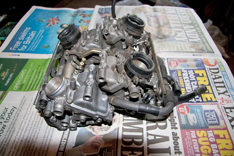

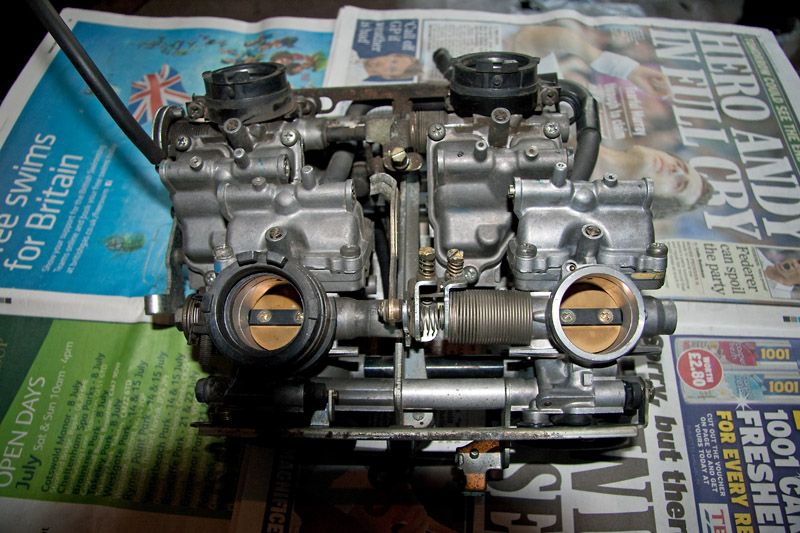

View from the top with the carbs the right way up. The front carbs (2+4) are at the top of the pic, and obviously that means 1+3 are at the bottom. You can see here where the thinner overflow pipes and joiners are located, as well as the thicker ones that go to the sub air cleaner. At the top, the black arm between the carbs is the where the choke cable locates, and the silver bracket is where the choke cable is clamped. In this view, the gaskets that go between the carbs and airbox/velocity stacks (I'm not sure precisely how that lot go together as my carbs came as you see them) are not present.

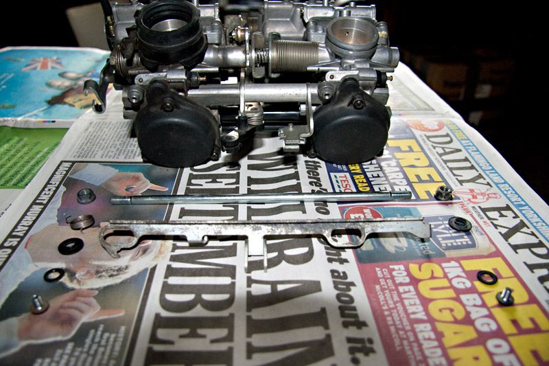

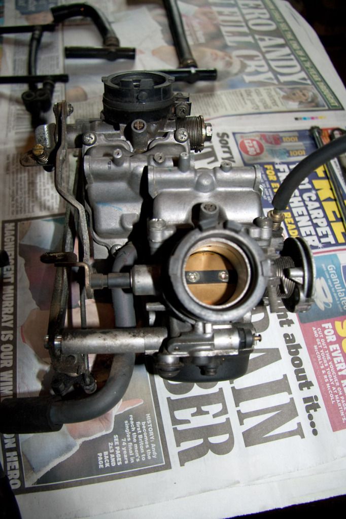

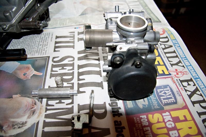

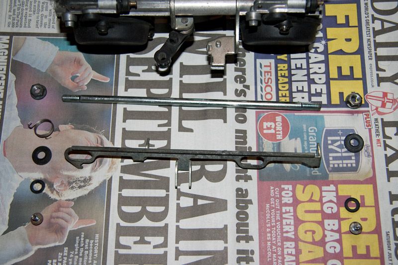

Right, let's start with the demolition.....! Whip out one of your cross headed screwdrivers and remove the two screws holding the choke operating bar on. The front screws and bar tend to be pretty manky as they are right in the path on any crap that finds it's way up behind the top rad. The screws (16081-KAZ-000, £1.07) and washer (16085-MV4-000, £1.11) aren't exactly cheap, but pale into insignificant in comparison to the plastic collars that go behind the bar (16175-MZ1-000, £8.39) and the spring (16051-MZ5-670, EUR11.50), so it would be rather handy no to lose those either! The bar itself, 16121-MR8-900 is a whopping £28.56 if you are unlucky enough to find that it's corroded to death and not suitable for reuse. The joining rod has a 10mm flanged nut on either end (94050-06000, £0.80). Honda describe this as a 6mm nut, so I assume they are referring to the thread size, not the head.

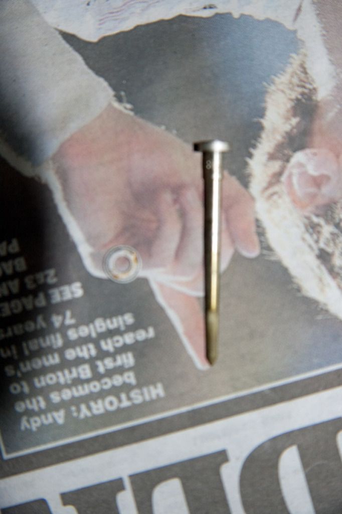

View from above of the same. The carb joining rod is no longer available, however the rest of the parts here add up to over £70 including VAT between them for two nuts, two screws, four plastic washers, a spring and a bit of metal.... expensive parts labels, Honda ones...

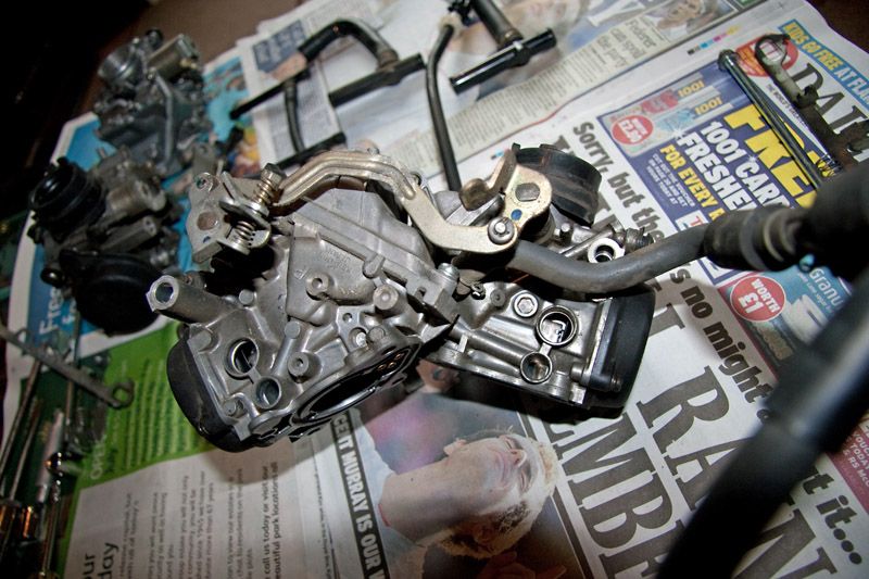

A quick look a bit closer before pulling the first carb off. Of interest here is the spacer between the carbs (no longer available) that has the bracket for the choke cable (16119-MZ5-600, £10.16) between it and carb 2. Also, you will see the smaller spring between the two carbs (16053-MB0-671, EUR5.00) which Honda refers to as a thrust spring. It's not too hard to extract before splitting the carbs, and doing so would probably reduce the risk of losing the thing. Also, there is a spring under the carb adjuster point that you need to be careful with. Not the one that the screw screws through, but under the paddle this one presses against, there is another one between that paddle and the one underneath. It will probably stay where it is when the carbs are split, but be very careful it doesn't escape. Fortunately, they can still be found (16052-MV4-000, £2.28), and are a lot cheaper than the adjuster screws and springs (16028-MR8-900, EUR25.5) which are silly money!
Here is carb 4 removed from the group. Note the thrust spring, spacer and choke cable mount. It looks reasonably clean because it's the one that has already had a bath. In order not to lose any of the bits from the choke bar, I temporarily put them back on it.

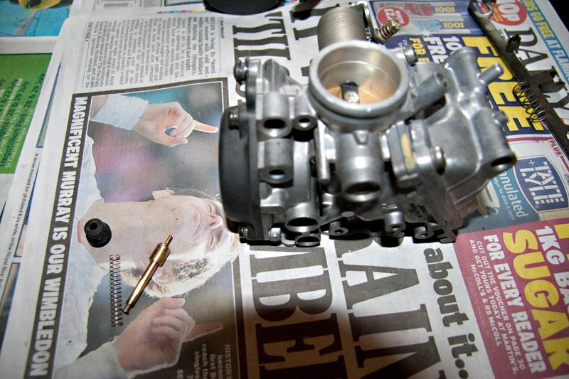

A look at the bottom of carb 4, showing the float bowl. The brass screw next with the cross slotted top is the pilot screw (16016-KBH-000, £13.37). Standard setting is 1 5/8 turns out. If you are not splitting the carbs to remove the float bowls, be very careful with the lower screw. The fuel joint pipe between the carbs makes access awkward if you only have a short screwdriver, and the 5x16mm screws (93892-05016-10, £0.50) are quite soft and easily damaged.

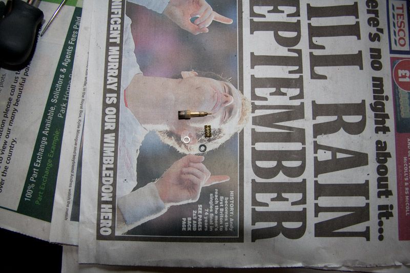

Here is what the pilot screw looks like when it has been removed. It has a spring under it, followed by a washer and an o-ring. The spring and washer are only sold with the screw itself, however, the o-ring is available without having to buy the screw. Unfortunately, it comes with the gasket set for the whole carb, and for that you could buy a new screw and a pint of beer too....
Note that the washer and o-ring may very well need persuading out of the carb using a needle (or the sewing variety, not carb...

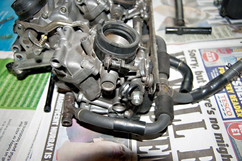

Three wheels on my wagon, or something like that... To the right of the carbs can be seen the long, fatter balance pipe or whatever you want to call it that goes to the sub air cleaner. Honda call all the t-pieces fuel joint sets, although considering where these particular ones go, I'd be a bit worried about neat fuel making it's way there! It's probably standard hose, however is you really need to replace it and really want a genuine part, it's 16199-MR8-900 and EUR5.48. The joint itself, 16026-MR7-004, is a mammoth £23.25 ex VAT, and of course there are two of them (we haven't met the second yet). The last time I hard my carbs done, several of the joint pipes needed replacing as they apparently crumbled to bits, leaving a huge hole in my wallet! They are held together with clips 15772-292-010, £0.95). The other thing to note is that you can now see the idle adjuster paddle a bit more clearly. There are two adjusting screws on the front carbs, one balances them to each other, and the other balances the front and rear pairs together. The spring I mentioned earlier sits under this paddle, and the paddle from the other carb sits below that. There is a raised pip on the latter for it to sit on so it doesn't fall out, and this also helps keep it in place when you take the carbs apart, however it makes it a right pain to get back in!

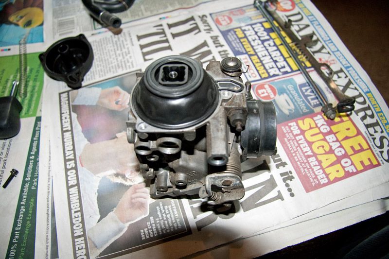

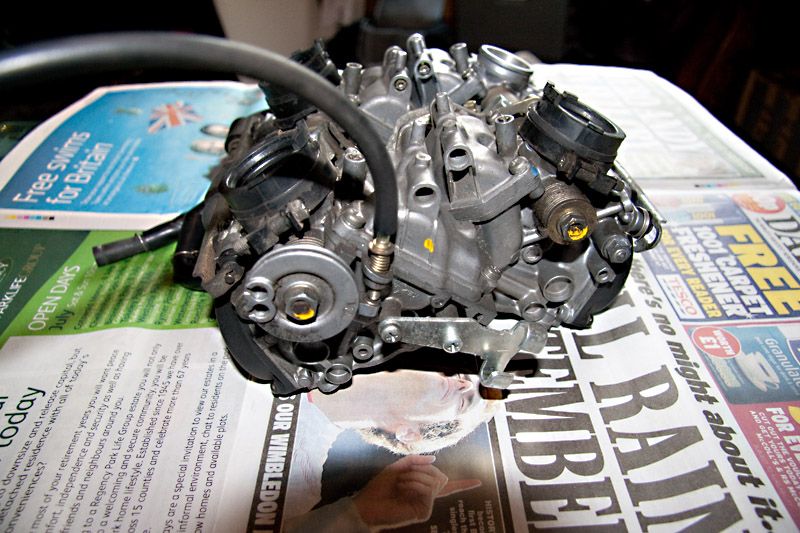

Carb 3, from the side and upsidedown. As mentioned before, note the wiring loom clamp on the end of the joining rod. In this pic you can see the thin balance pipe that goes between the front carbs, and also the the fuel feed joint pipe. I'm pretty sure these are the ones that needed replacing on my carbs last time around. If you are unlucky, they are 16026-KV0-014 and weigh in at £21.88 each. You can also see the carb balance adjuster and it's linkage that joins the front and rear carb pairs together. The fuel hose leading to the fuel joint (16143-MR8-900, £5.20) feels a little brittle to me, so I may consider replacing it when rebuilding. It's opposite number is slightly different, 16144-mr8-900, £5.40.

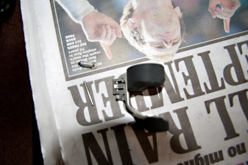

Another quick look at the rear carbs. The choke operating bar has been removed. This is identical to the one for the other carbs. As you can see, the thrust spring is different for this pair, and some more comedy value. It is part 16050-MZ5-600, which Honda deem worthy of a £9.28 price tag!
After pulling carb 3 away from carb 1, you will be left with this. Carbs 1 (foreground) and 2 are joined by the linkage that transfers the butterfly opening movement from the rear carbs to the front. You can see the spacer that fits between carbs 1 and 3, which is identical to the one between 2 and 4. On this spacer is also the bar that the choke linkage pivots on. I have neglected to take a photo of this (ooops!) As the choke operating bars have been removed, this simply slides off of the spacers. Neither the operating rod nor the pivot bar can be obtained any more, so be very careful with them. In the background on the left, for another dose of odd and high prices, you can see the thinner carb joint pipes (16047-ke7-003, £19.95) and their vent hoses (16142-mr8-003, £7.40). These hoses come as a pair, and are attached using hose clips 16163-mb3-671, which are smaller than all the others used, but cost £1.53 instead of £0.95 for the rest. Whatever....!

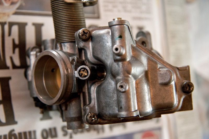

Side view of carbs 1 and 2 with the choke linkage removed. There is a better view of the spring arrangement on the balance paddle that will hopefully explain a bit better how the screw and two springs are arranged. The butterfly opening linkage is attached at both ends with a split pin. Behind this is a metal washer, and behind that is a plastic one, underneath this is the bar itself, and there is another plastic washer between the bar and the carb. The linkage bar comes with the split pins and washers as a set, and is no longer available. In my case, one of the plastic washers is split, so something will have to be found from elsewhere. No pic yet as the one I took was even more rubbish than the others!

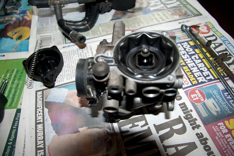

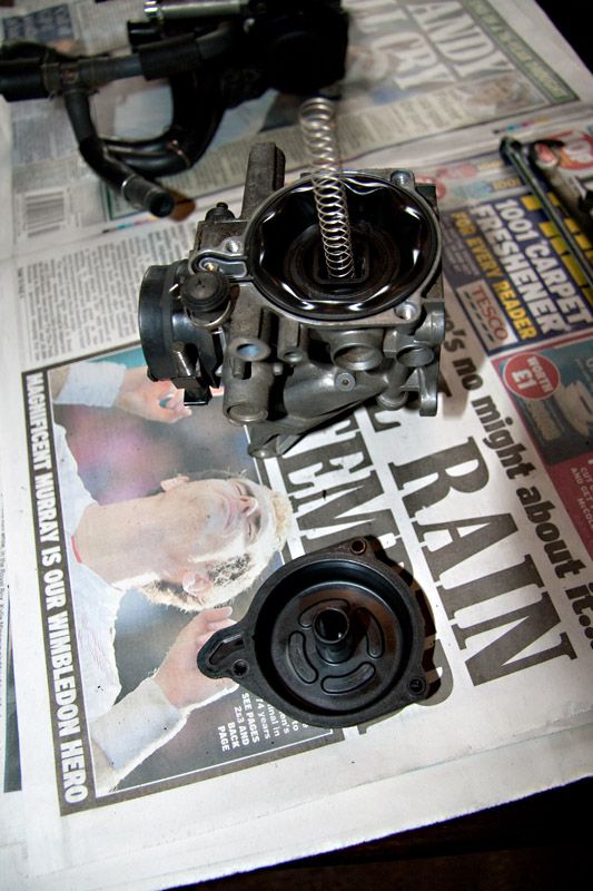

OK, so on to the bit people might be more interested in, what's inside the things and how they are different to the NC30.... So, back out with the cross headed screwdriver and whip off the three screws (16080-MV4-000, £0.82) holding on the piston cover (16107-kaz-000, £32.65). Be careful when taking the cover off, and there is the very large piston spring under it (16051-MR8-900, £8.20). Some people choose to replace these springs with HRC replica ones from Rick Oliver. See the NC30 DIY carb jetting guide/thread for more details.
The next stage is to remove the needle spring holder (16037-KAZ-000, £15.60). This is done most easily by getting one of the piston cover screws and screwing it into the holder. It seems to be threaded for this purpose and the pic shows this done. With one hand hold the piston in place, and with the other pull the holder out using the spring. It isn't very tightly fitted, so should be no problem. There is a small spring inside this holder, although it shouldn't fall out. However, don't take any chances, as this is another item for the comedy price list. It is 16051-MV4-000 and £10.01 ex VAT!
Next, remove the piston and needle. The easiest way to do this is to put your finger in the hole where the needle spring holder was and very gently withdraw the piston, taking care not to damage the diaphragm, which is the holy grail of the comedy prices. If all goes well, it will come out inverted, which also makes it very easy to put back in later on. Here we see the needle spring holder and the piston (16111-MR8-900, a mere £101.90 ex VAT from DSS or EUR106 ex VAT if you go to CMS), with the needle still in it. Check the piston carefully for any signs of holes, splits or any other damage, and also to make sure it's nice and supple and hasn't dried out. If it's no good then you have my sympathy!
The needle (16027-MR8-900, £24.07) should come out if you turn the piston assembly over. There is a washer at the bottom of it, although in my case the washer had become stuck to the inside of the piston due to the fuel residue. There are numerous different needles available, and at the time of writing I forget the short code for the standard ones like this. The washer (or shim if you prefer) isn't available on it's own from Honda, however there are other sources such as Rick Oliver if you wish to replace it and/or fiddle with the needle height. This pic is shocking, so a better one will follow....
Here's a quick look at what I was going on about for putting the piston back. If you put it on top of the carb like this, you can gently slide the slide back into the carb body and the diaphragm will invert while the edge stays nicely in the groove for sealing with the cover. If you have the diaphragm the right way around before refitting, it's a bit more fiddly getting the edge seated.

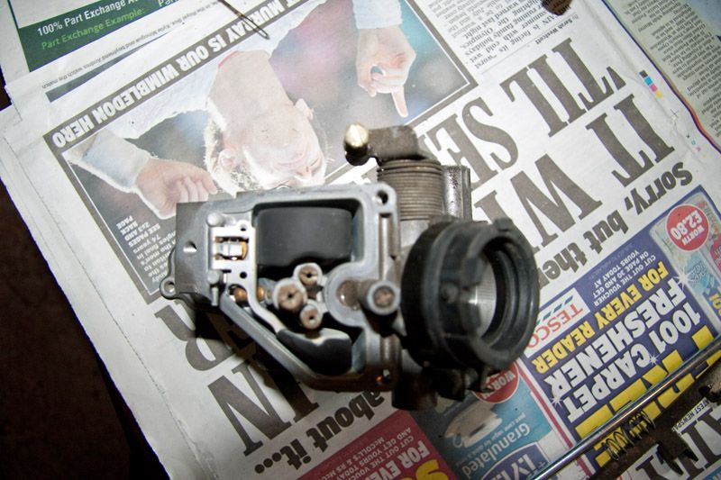

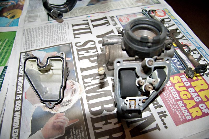

Sorry, another fairly poor pic. Here's a carb with the float bowl removed. All the stuff that looks like anaemic custard power is the wonderful/useless/indifferent/whatever stuff that gets added to petrol to allegedly increase fuel miles, keep our engines clean and do other wonderful stuff as well. I doubt much of it used to be real petrol. The float bowl gaskets on these carbs are hard as a rock and unsuitable for reuse, not that it is recommended in print to do so anyway. Inside the carb body, the big black bit and the smaller black bit with the custard powder on the side are the float. In the middle between the two sides of the float are the slow/idle jet (left, upper), main jet and emulsion tube (centre, lower) and I'm not quite sure what the other bit on the right upper side of the main jet is, however it seems very firmly fitted and doesn't appear on the parts diagram! The slow jet comes out with a flat bladed screwdriver, as does the main jet. Then you need a 7mm socket to remove the emulsion tube. This needs to be fairly slim as the unidentified tube on the right is very close. The float bowl has a drain screw in it, which can be removed with either a flat screwdriver, or seemingly with an allen key. I used the former so I don't know what size allen would be used. Yet again, do not lose or damage it, as it only comes with the float bowl (16015-MR8-900 for 1+4 and 16023-mr8-900 for 2+3, EUR56 if they can be sourced), although the o-ring is part of the gasket set.

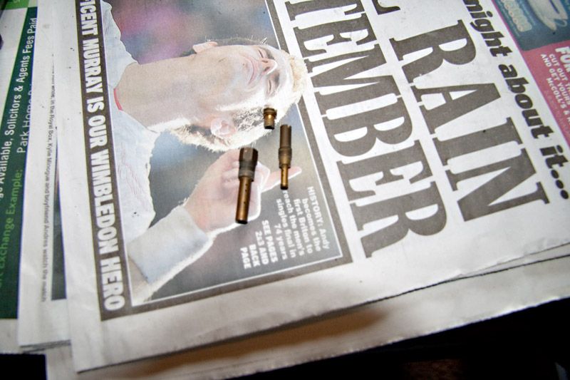

Here we have another very ordinary picture, showing the emulsion tube (left), main jet (middle) and slow jet (right). Take car to note that the emulsion tubes are different from front to rear. This was carb 2 if I'm looking at it right, which makes it a front emulsion tube (16165-MR8-900, £18.28), assuming a previous owner didn't mix them up. The rear cylinders have a different one (16166-mr8-900, £18.28) with different spacing. Standard slow jets (99103-mt2-0350, £8.36) are #35 and it seems unusual for people to change the size, however the size is part of the part number, like the main jets. Standard mains are #108 (99101-393-1080 (393 part of the code now superceded GHB), and £6.87 apiece. I will be going up to #112 on account of a Scorpion pipe, so the part number will change accordingly. Make sure the screwdriver is a good, deep fit in the slot of the jets as it is very easy to damage them with an overly large blade that doesn't go all the way to the bottom. I took a lump out of one of them, but as I'm not anticipating using them again it's not an issue.
Yet another bad pic. Here I have replaced the emulsion tube and jets, and started to remove the float. This is where you need an implement to push the pivot pin out. It's not an overly tight fit, so presents little difficulty. Another one for the do not lose pile, the pin is not available on it's own, so unless you buy a new float (16013-MR8-900, EUR35.00) then it's off to the scrap box or out with a caliper to measure another one to see if you can find something the same diameter to replace it.

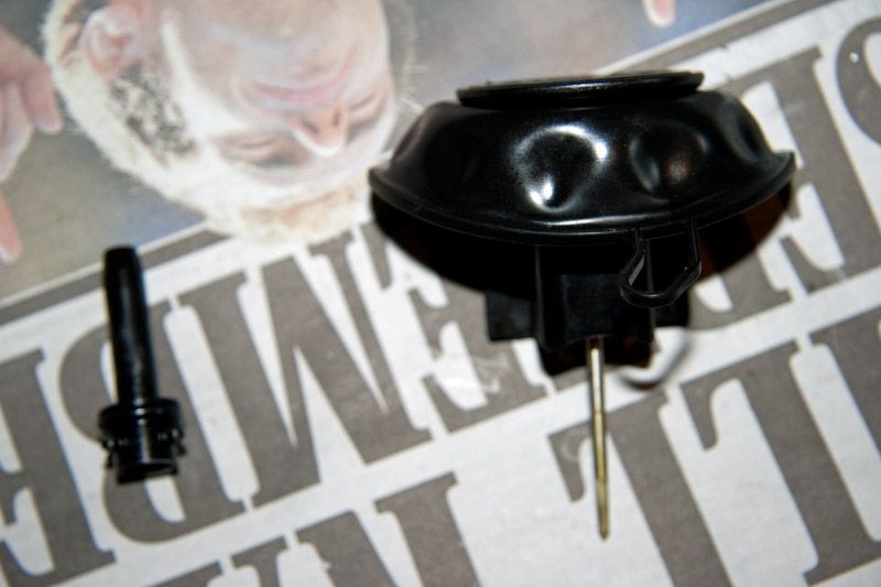

Here, I have removed the cover from the choke plunger, or as Honda call it, the starter valve. You need a 10mm socket to do this. The rubber cover is part of the threaded plastic holder for the plunger, so as ever, a little care is needed to avoid damage.
With everything out, you can see what the plunger looks like. The end nearest the bottom of the picture is where the choke operating bar locates. None of these three parts can be obtained on their own, so will have to be replaced as a set (16046-MY9-000, £29.02). Ouch once more!

Finally, the ultimate laugh. CMSNL have a price for a full set of carbs and also one on it's own, however no indication of availability, but that gives something for comparison to the parts prices. If you think the equivalent of £1050 for a set or £395 each (if they are all the same price, which I doubt) if they can get them is a bit steep, try adding up the individual bits. I've already mentioned above that parts like the joining rods, butterfly and choke linkages and a few other bits aren't available any more, however if you add up the cost of all the bits you CAN get, the total is......... just under £2600 in VAT.
Edit:
Actually, I had a sudden thought last night... I missed a bit.
