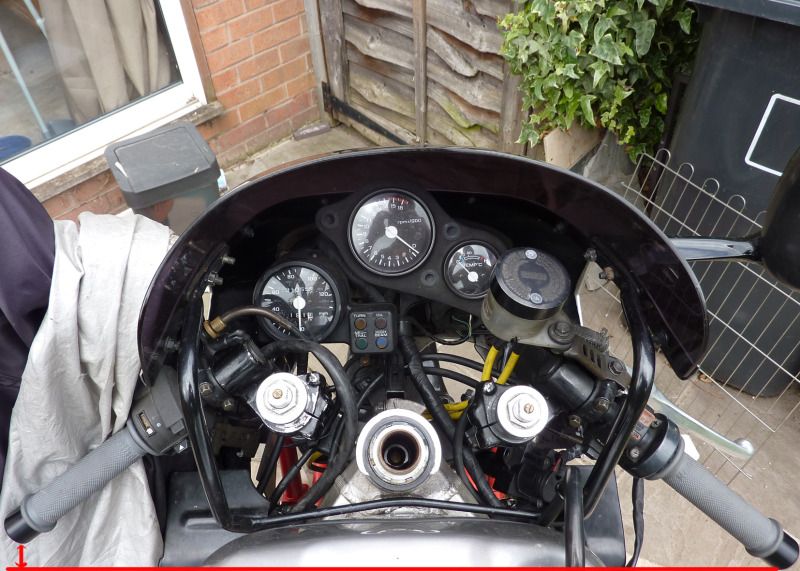

Ever since i've had the bike, the bars have not been quite straight when the front end is pointing striaght ahead. My right hand sits further towards me than my left. See photo below. you can see the difference in position, the right hand bar end sits at the bottom of the image and on the left i've marked the differnce in position with the red line. The centreline of the fok tops also isn't aligned. Both clip ons are aligned in the same position so it's not the clip ons.
I replaced the forks but this didn't help. I've tried undoing everything on the front end and giving it a good wiggle to see if i can get it to sit straight but with no joy so the only thing that i can now think of is that perhaps the yokes are not straight?
I've currently got the top yoke off for a fresh lick of paint and I have noticed that when the bars are straight and I look down the stem that there is a difference in the gaps between the steering stops which seems to re-enforce the thought that the front end is not straight. Surely this gap should be even on both sides?
Can anyone make any suggestions on a fix or a way of confirming whats causing this before I start spending money/taking things apart!?

I think the twist must be before the bar/clip on as the centreline of the fork tops is not in line when the wheel is. as i know the forks themselves are ok, this suggests to me its got to be the bottom or top yoke, or that things have just got twisted when everythings been tightened up.
I'm going to undo everything again and give it an almight wiggle and then nip it all up and see how it looks.

Re: How to tell if yoke is twisted?
Forks dont' looks level.. you can't draw a straight line between one of the fork adjusters to the other.
Perhaps there a little twisted but the picture doesn't help.
Take the yokes off and check them properly, will soon see if it's twisted.
