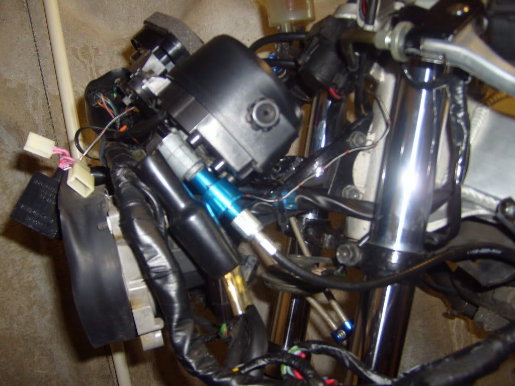

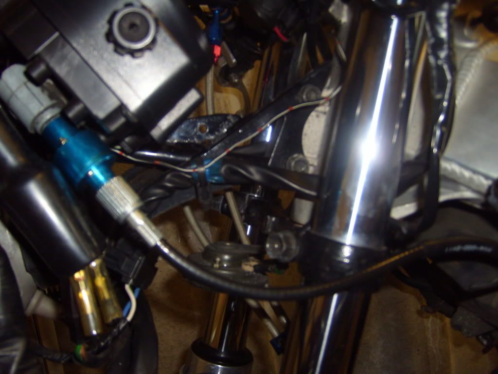

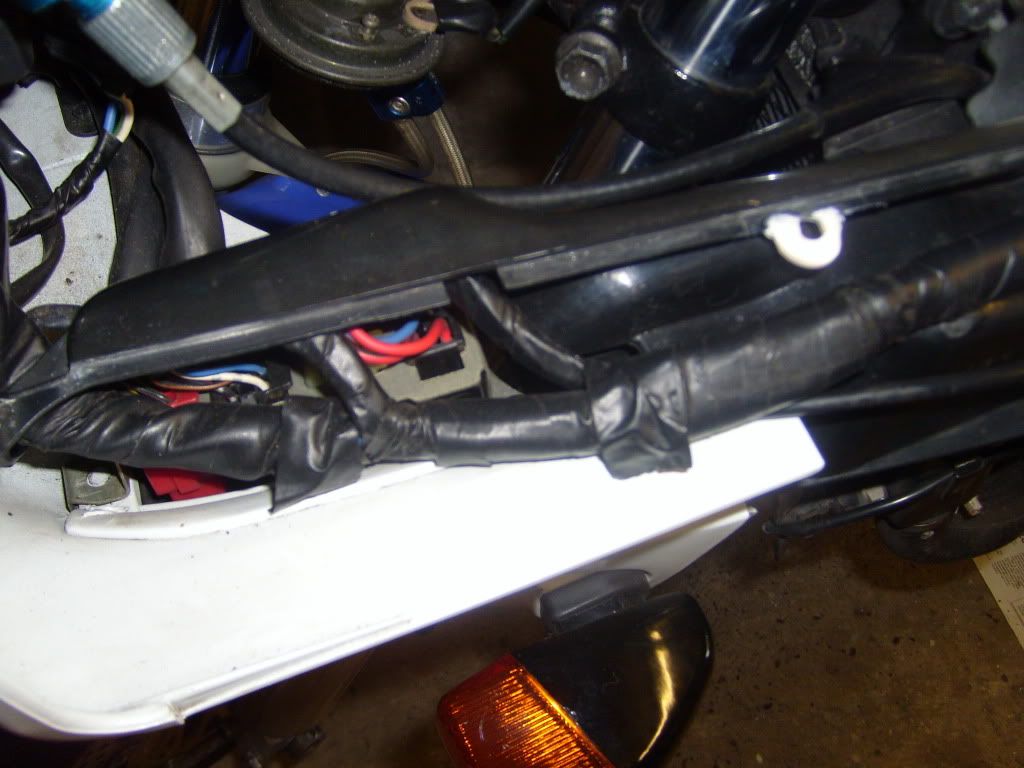

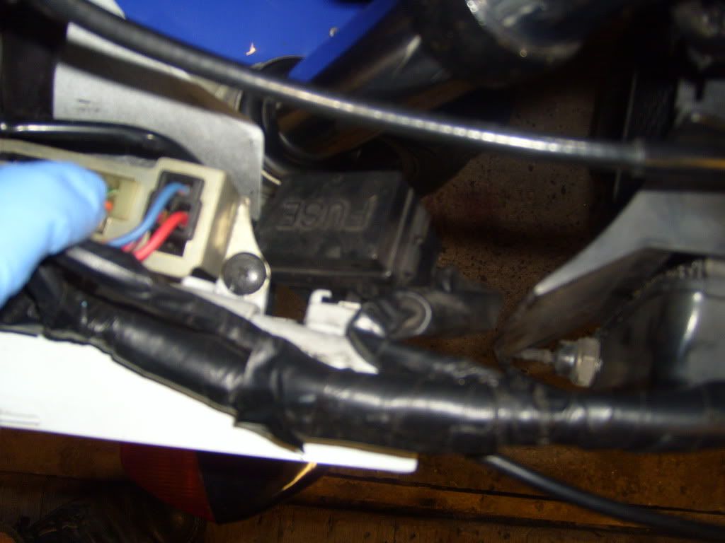

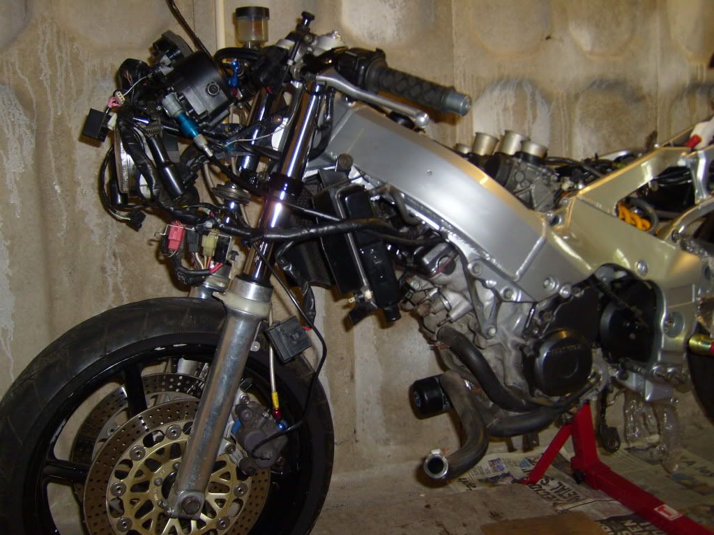

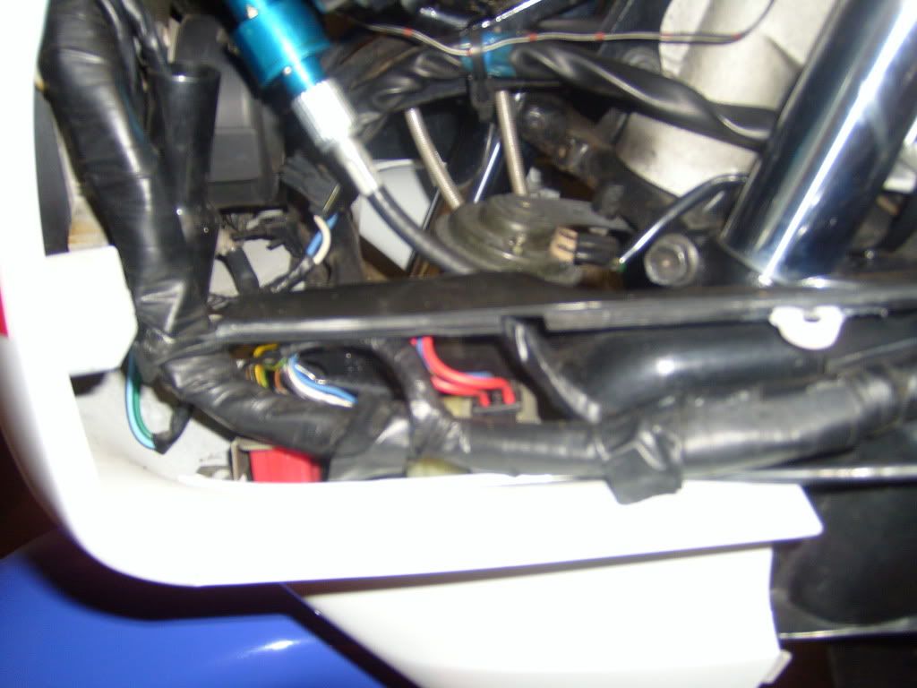

Hope these help, these are really the only photos ive got of the front wiring loom but as Durka Durka has said it wraps over the back of the headlight/ behind the speedo with 2 plastic coated aluminium bendy clips

That's quality guys, if I can't get it sorted from those pictures and durkas description ..... I shouldn't own the bike !!
