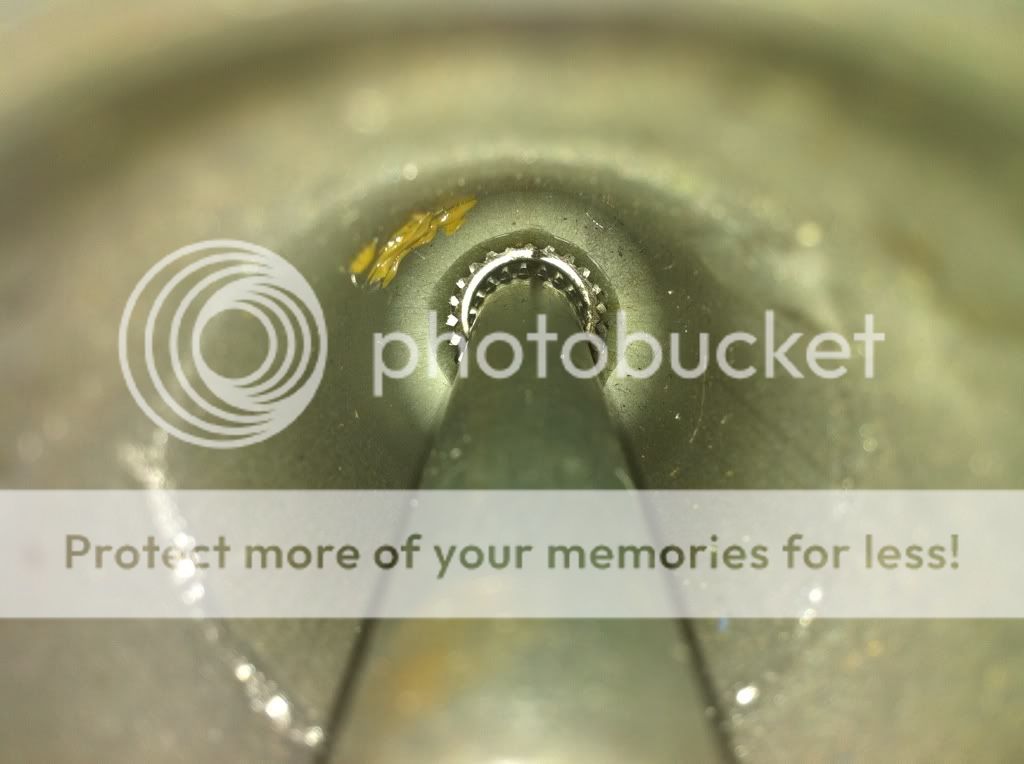

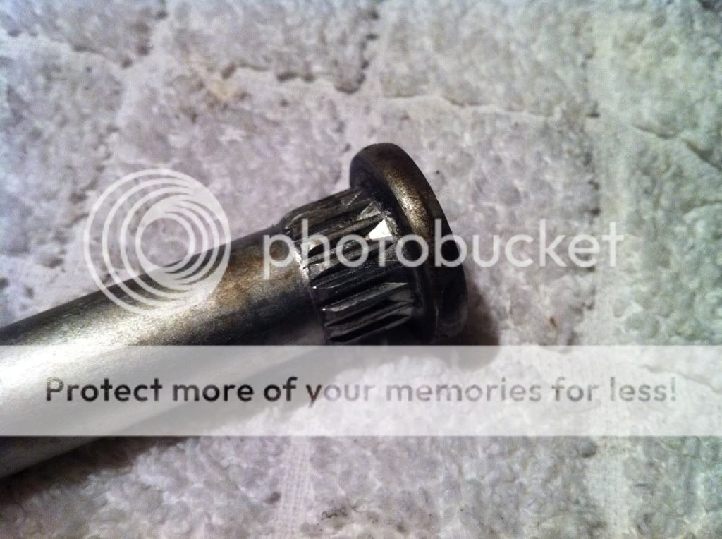

Are there differences between both? I think I've an RVF wheel carrier. Are the splines on the RVF rear wheel axle bigger than the VFR and will the VFR sprocket carrier work on the carrier?
This is the piece I mean,
Splines
In the hub you'll see the gap,
Splines

If you zoom in you might be able to compare the one you have with this one which is RVF
viper_biker
- Posts: 1798
Re: VFR vs RVF rear axle
That RVF one looks like it has a fatter spline on it. It seems to have a step on it that gets bigger in size, unlike the VFR one. Is that still loose in the garage Tony?
