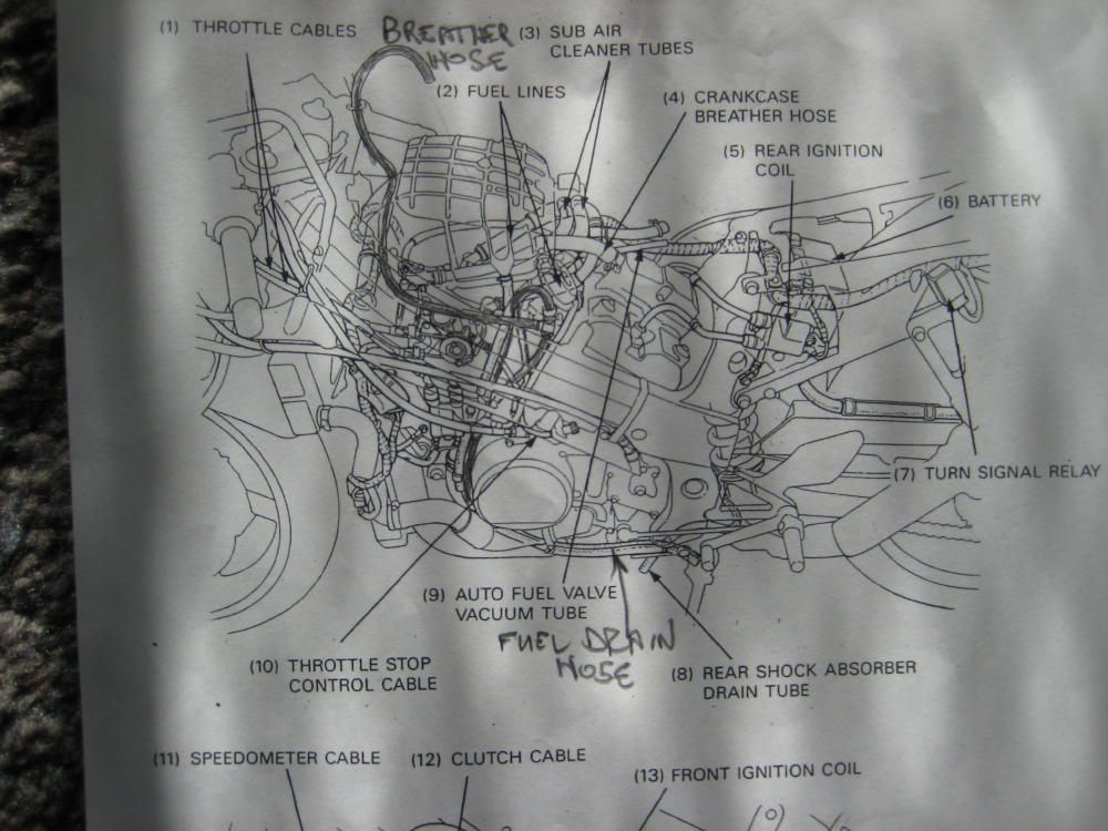

Am i right in assuming this hosing with a t-junction are the breather pipes from the carbs?
Restoration numpitness, Never made note as to where it came from...

It's a breather for the tank, mate. I shamelessly ripped this photo off Deviant400:

yes the hose that sticks out from the T piece goes to the tank breather , the other two ends hang down the left side of the motor and vent to air

Just to clarify then, the top hose connects to the aluminium screw piece on the top right of the tank?

Yes, the top hose threads up through the eyelet in the screen brace and plugs on to the cap on the top of the tank. As far as this new hose goes, I'm not certain where it's from. No idea why it would have another piece of hose inside it either. Sorry.
