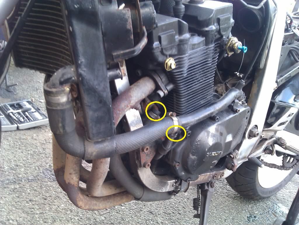

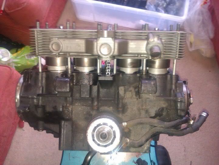

Ive recently bought a new barrel for my bike but it has a different water inlet then the old. there are two different sizes into the old head, hers some pics to try and understand it.
the top hose that comes from the oil filter should go into the same place as the top right side inlet. Some pics of the old set-up
Is there a type of different sized T-junction I can get? ive been searching the net for past hour but my Google skills are sh*te i admit

The new barrel is from a gk73a not 76a, in fact looking at the coluor i'd say its from the Bandit4.
Might be worth talking to Mike at BMC racing as im sure he had a complete top end.

yh its from a different bike, its the big bore kit 442cc, i have the engine mainly rebuild, just need to sort the valve clearances/ shims -,-' its only that 1 piece that is different. need some type of T junction, but carnt find one because there different sizes

The way to work it is to use a 73a or bandit pipe from the pump to the barrel.
If you want to use the water cooler for the oil pump you will need a straight pipe connector that has small 'T' takeoff to allow the oil cooler to be attached, you would then cut either the main in or out pipe (depends on which way the oil cooler is flowing) and connect this in. I know for a fact that ZXR4's use one of these, NC and CBR may use them.

Yh i am after a T-junction best as i'd like to use the oil filter cooler, i just carnt find one because of the 2 different sizes
