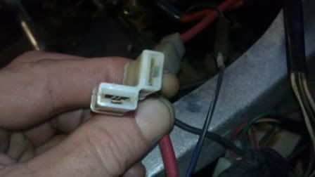

Could someone please tell me what this connector block is for,
And is there anywhere I can get a diagram of where each connector goes ,,
I have the loom back in the bike but have 2 connectors I cant find where they go ..
One green one which plugs in in the under tank area and the one in the picture ,,
Thanks in advance ,,

The green one should go to the other green plug ... it should be there somewhere, maybe attached to the fuel tank ???
I think the 90deg plugs onto the indicator relay if so it has a brown and brown / white wires.
have a look on the forum's front page and there should be a link to manuals there's a pdf of the wiring diagram there or use this one below

Thanks for the Diagram Evilchick...problem solved now I think,,,

yamaha are pretty good and tend to use different connectors and colour code them so if they fit, generally they are correct!
