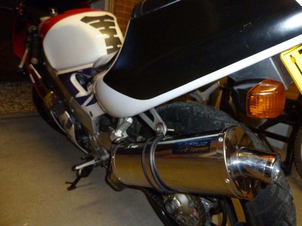

Hi guys.
So took my bike out today for the first time since fitting my new Blueflame exhaust:
Was riding along the country roads, had been for about 10 minutes, came up behind this Mini so slowed down a bit and then it felt odd, like it was losing power, like when you run out of fuel... I knew I had fuel as I only filled up the other day, and when I pulled over it was still idling fine, so switched it off. Turned it back on again and continued home. Again, it was when the revs were low and I had slowed down, when I got into town when it was really struggling... Got home ok but something was definitely up. Now I ask the obvious question could it be I somehow cocked up fitting the exhaust? Or could it be something else, just coincidence that it's happened now?

I think I have found the problem - this one has a baffle, the other didn't :-)
Re: Help! Somethings gone wrong! :-(
Sounds like the carb pilot screws need adjusting to match your new muffler.em2evol wrote:I think I have found the problem - this one has a baffle, the other didn't :-)

The new one didnt happen to be a fair bit quieter?em2evol wrote:I think I have found the problem - this one has a baffle, the other didn't :-)
How does it sound by the way?
- em2evol
- Posts: 92
- Joined: Wed Jun 15, 2011 4:02 pm
- Bike owned: RVF400
- Location: Berkshire
Yeah it's quieter which I was pleased about - going to be louder when I take out the baffle though eh!
