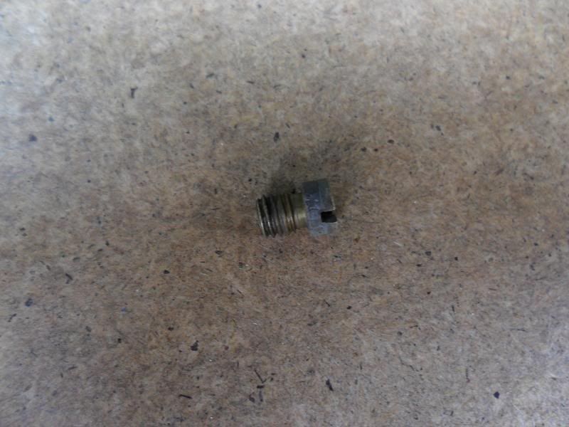

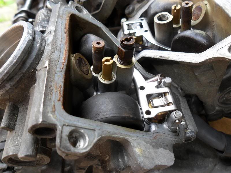

While waiting for my new jets I decided I'd strip the carbs and try to clean the emulsion tubes etc
It seems whoever had been here before had a fair old go at buggering it up
Both front and rears have one four hole and one five hole tube
They all look like cack
trying to remove main hets resulted in them coming out with the emulsion tubes, managed to free all but one by putting them back in and holding the tubes with a 7mm ring spanner, one is still stuck fast that is now saoking in penetrating oil
No indication as far as I can see on the main jets as to what size they are
Where would I find it?
Any other recommendations on further cleaning and getting that bloody stubborn jet off?

EITHER ON THE SIDE OR THE TOP/FACE OF THEM
ID PUT THE STUCK ONE - EMULSION TUBE I A VICE ON THE BENCH AND THEN UNDO THE JET WITH A LARGE FLAT SCREW DRIVER AND UNDO THAT WAY.
YOU CAN BUT JET, PILOT, AND EMULSIONS AS SPARES PAL. PANIC NOT!

porndoguk wrote:EITHER ON THE SIDE OR THE TOP/FACE OF THEM
Thanks
I'm not panicing........................ yet
I've got 4 jets and pilots and new gaskets on order, just no emulsion tubes, Thought they would be OK
I'll try the coke trick too
Bollocking bloody bike!
Edit/addition: I have just discovered that Wynns carb cleaner eats plastic, at least the plastic that my screw/fastener draws are made of, used one to put the emulsion tubes in, and put a fair bit of cleaner in to soak them. Came back to find no cleaner and the tubes sticking to the draw, knowing my luck the plastic will screw up the tubes. They are now in a tin of pepsi max (no coke in this house!). I will revisit this sorry pile of shite tomorrow!

Hey.. that'll be dirty old fuel!
I don't know if you read in my other thread but I said keep the carb-cleaner well away from the rubber diaphrams, just wipe them over and put them to one side (the diaphrams are in the tops.. check the needles are ok etc..)
Anyhow.. a few ways to clean them up.. the coke as been said.. not sure if pepsi-max will work.
You can also use on really bad jets...
1. Cheap tesco value vinegar (17p)
2. Bicarbanate of Soda (about a 1gbp?)
Anyhow.. emtpy your bottle of vinegar into a small bowl, ensure the vinegar is deep enough to cover the jets in, soak the jets in the vinegar, check them every hour or so and work them with a small soft nylon brush.
After a while they'll be spaning, rinse them with barcabante of soda water to neutralise the acid from the vinegar.
As for the stuck jet.
Ring spanner method is good, get a friend to hold that.. use the biggest screwdriver you can find to fit, anythign smaller will slip and break the jet... use positive but slow consant pressure and it'll give (two hands helps)
You can try tighening it a fraction first before you undo it too.
As rick said.. jet sizes either on top or side (wil see when crap is off them)
