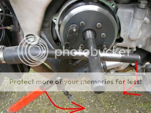

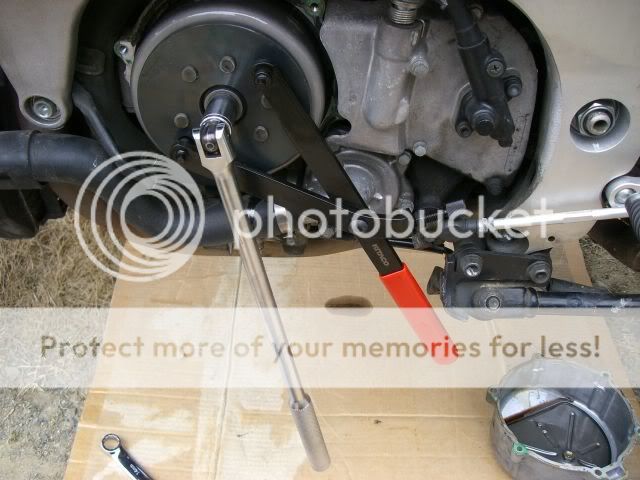

you need something like two big bars with bolts on the ends to hold the flywheel still while you loose the nut holding it,putting it in gear does nothing as your trying to spin the crank....then use the maahoosive bolt rick sells to screw it in and push the FW back off the motor...a fair bit of work for 2 Kgs of dead weight on the side of the crankviper_biker wrote:How do I go about removing it?.
removing it means you are going TL as you are removing one piece of the charging curcuit,then you don't have to buy the rec/reg and you can ditch a fair part of wiring out of the loom,it really is ,in my eyes, all or nothing ,don't do it if you don't want the hassle of charging the battery up after a few sessions,but with it removed you saw how quickly scotties bike span up and that in turn will affect acceleration,it'll be a bit harder to get off the line andyou will drop revs quicker but i think the pros out weigh the cons .....viper_biker wrote:And if I go that far should I just go total loss, or ditch the quietening gears etc?.

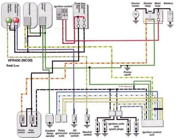

Here is a Total loss wiring diagram if you need one.

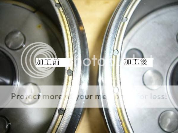

Is it possible to lighten the flywhel by machining?

Yes - but you had better be good at it as an out of balance weight ont he end of your crank at 14000revs i going to make a serious mess if it lets go!Carlos wrote:Is it possible to lighten the flywhel by machining?
Popping a few 10mm drill hols in the flywheel is prbably not the way.

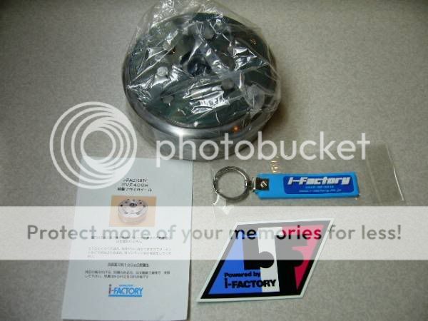

The best solution I have seen is the GSXR swapout by the G Force gang. brilliant work..
- Posts: 1798
Re: Removing the fly-wheel
[/quote]CMSMJ1 wrote:The best solution I have seen is the GSXR swapout by the G Force gang. brilliant work..
I did see that. I wonder why they kept the fly-wheel.

I was actually wondering what the wall thickness of the cylindrical part of the assembly was and could a safe amount of material be removed. Don't worry the black and decker is safely locked away.CMSMJ1 wrote:Popping a few 10mm drill hols in the flywheel is prbably not the way.
- Posts: 7161
sticing it ona lathe and mil ing out the insides? hmm - my wife's step dad has a lathe and I can probably get him to take some off the flywheel..hmmmmm
