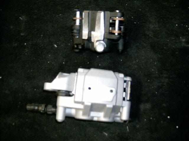

This is how it's done...Suzuki RM85 -07 FRONT caliper, with quite a few modifications to both caliper and bracket.
/Lasse
/Lasse
