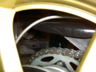

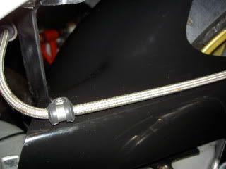

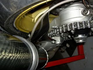

gavin there a bit rolf harris will remove it and get some better pics outside if unable to identify from these

davethetrucker.I have a cf rear hugger and it has a bracket that bolts to the link mount,
you don't show a pic of your link.

hunter yes need to get better pics was in a rush hopefully get some better ones tomorow . curious about bracket you have i take it bolts onto bottom right of the hugger then behind the nut at the linkage mount on the swinging arm and bracket is just a simple L shaped with bolt holes either end
