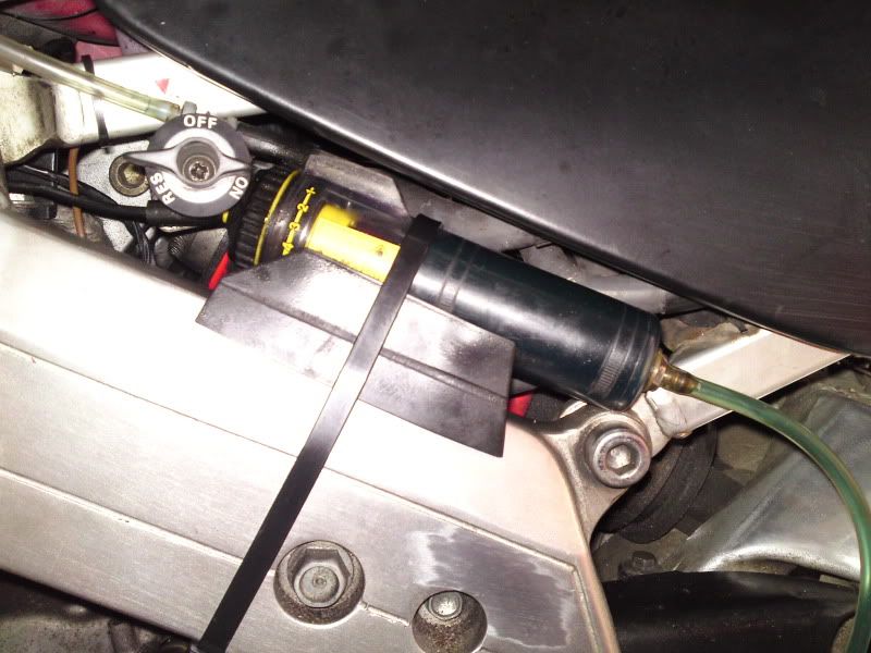

Just found a scottoiler on a GS500 I am breaking, am looking to fit it to my NC23... all good apart from what to do with the vacuum hose? On the GS500 it fitted into the carbs via a T-connecter, how could this be plumbed into a CBR, can I patch it into a hose or would it have to go into one of the carb balencer ports?

One of the carb balancer ports is the usual way.

Sorted!

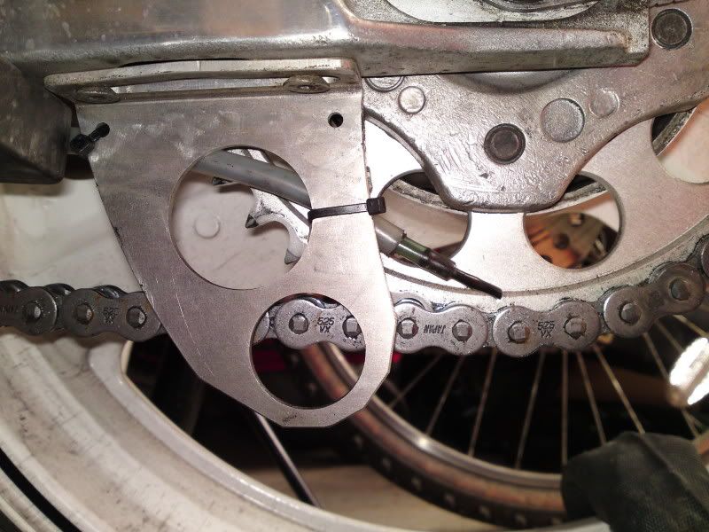

Bought an M5 adapter for the manifold, fits quite snug, bike now oils its own chain for me! Its the least it can do, lol

Rear hose:

Dead chuffed with this, the bike freewheels a lot better, back wheel just spins when on a paddock stand?
