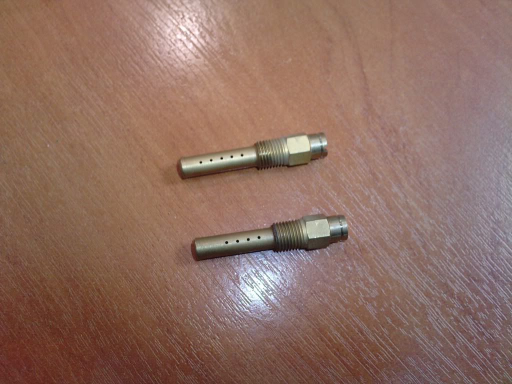

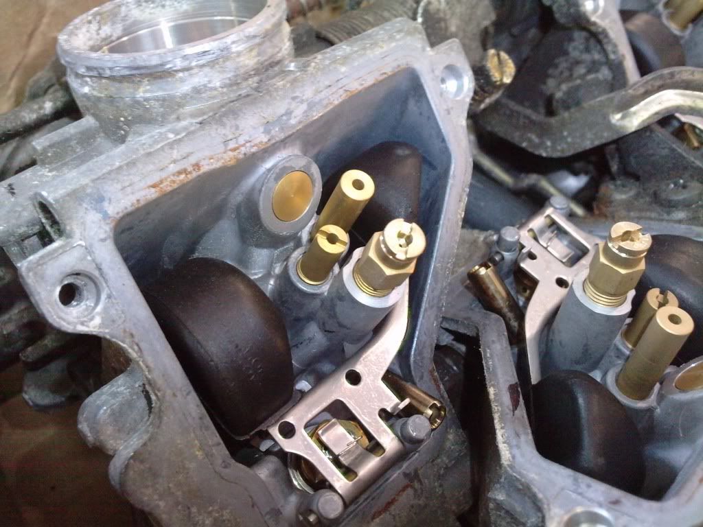

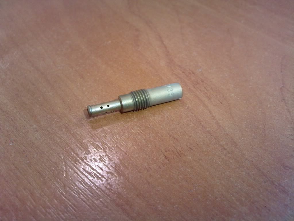

i have taken a punt on cheap set of carbs from ebay, they looked very rough from the pics & what arrived in the post, however the interals are immaculate. the needles have had the extra washer added & the jets are 120 all round.
is 120 all round a common setting? i have a laser race can & a dual foam filter and she is very rough at 4 - 7 k, i have standard jets in my import ( i have not tried this with the original honda filter which i think will be better )
as this has 120 all round & the needles have been raised ( the sliders have not been increased to 2.5mm ) would we guess that the very rough spot 4 - 7 k would be better?
i know the only way is to try but would like to get an idea of what to expect before starting!

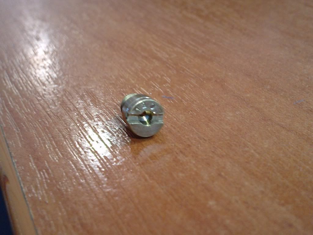

Do those 120 jets have a make or symbol stamped on the side? Unusual that they have the number stamped on the top (and look silver in the pics?). Thought they were dreaded Dynojets at first.
120s all round should be fine though.
- Posts: 367
Re: nc30 120 all round jets - common?
all they say is 120 stamped on the top as you can see in the pics, they are brass and seem like new, there is no screw driver marks etc, the float bowls are as if they are new so clean it is unreal. all of it is so clean inside!

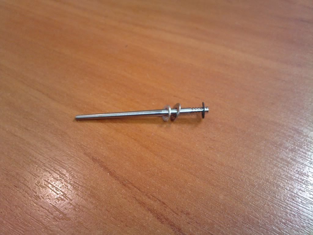

the other interesting thing i have just found, the diaphram needles dont look standard...they have 6 adjustable heights operated by a e-style clip. in the carbs they had also had an extra washer added.
ther are no markings what so ever on these and i know they do not look like my needles in the carbs at home?

Adjustable needles from a dynojet kit ?
- superlite
- Posts: 748
- Bike owned: TLS, LB80 x 2
- Location: Australia
Doesn't look like a Dynojet needle - the grooves are machined differently and the tip is quite blunt in comparison.
Whatever they are, I'd turf them. It's not worth the headache setting them up I reckon.

Putting an extra washer under the needle is much the same as lowering the needle clip on the adjustable needle. Im sure you know but i thought i would put in my 2 cents just incase. Does depend on the shape of the needle though.
