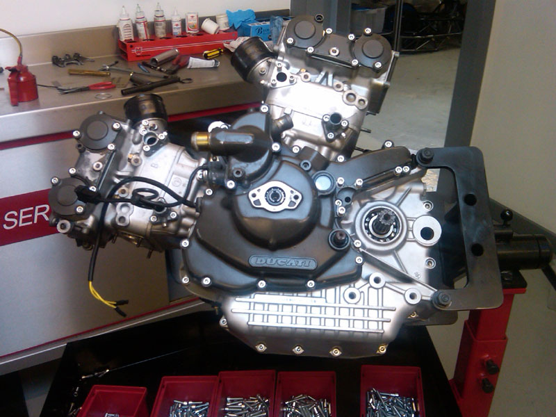

New (well to me) engine built like it should have been from new, with lots of SP parts, high comp pistons, 748 and RS hybrid box, chris mayhew heads = rapido engine
such a delight to work on, some serious engineering gone into this, granted the components might be made from chocolate, but at least its easy to fix.

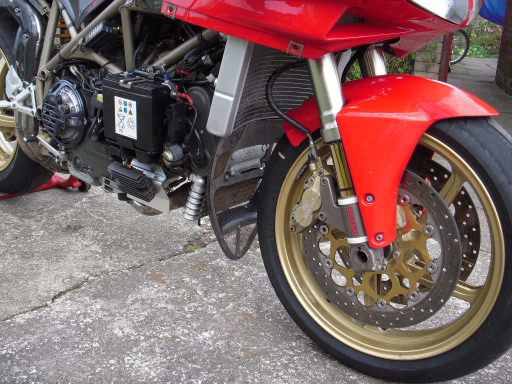

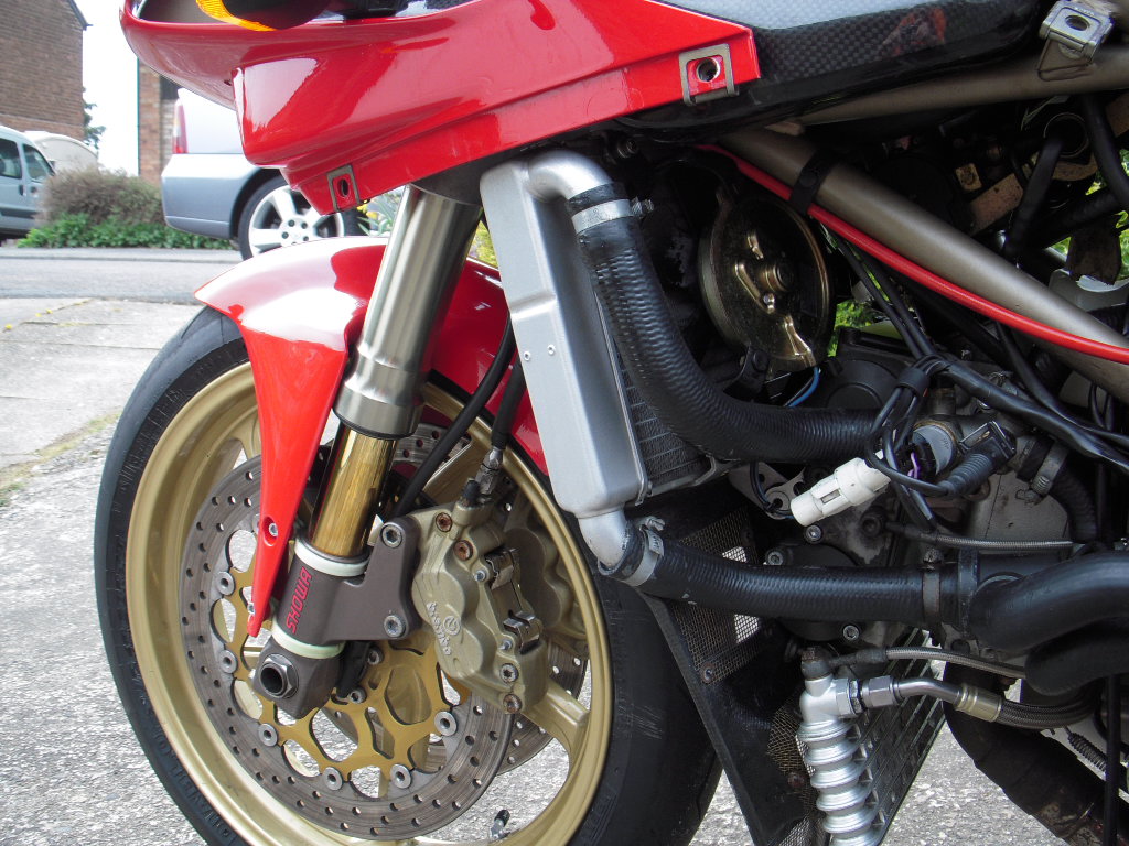

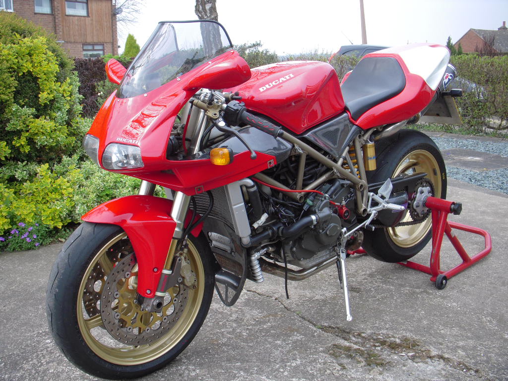

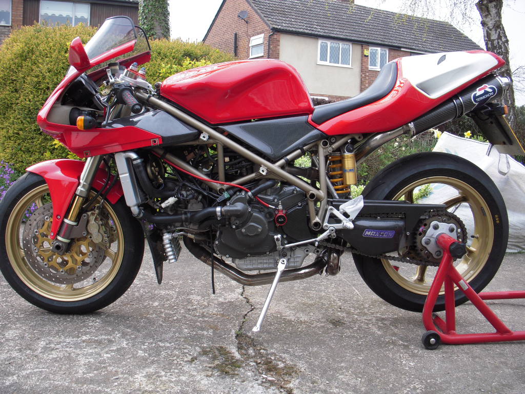

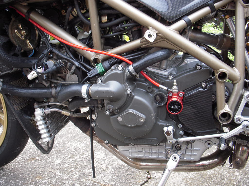

anyway allow the pictures to speak. behold some italian goodness

So current spec is something like this
1995 916
Started life as a strada, converted to bp with subframe, seat unit, P1.6 ECU and bp left hand loom.
Lightweight high capacity battery and tray conversion
original equipment dogshit factory rectifier (at time of writing is still working after 2 years - so anytime now lol)
Rear ohlins from a 748R, valved and sprung by maxton.
Front 996S forks valved and sprung by maxton
60mm calipers.
Carbon airbox and high capacity air tubes.
MS production undertray
Marchesini 5 spoke alloy wheels (to be replaced with stregthend mag items later this year)
Engine as follows - now
Cases 916SP
Crank - 916SP lightened and balanced.
slightly lightened flywheel
749R starter motor
748SP gearbox with 2nd and 5th i think from a 02 RS
All new bearing and seals and gaskets
low mileage (7k) std 916 barells
High comp pistons
Chris mayhew cut heads.
Aftermarket clutch slave - so no need for an arm like tyson to shift gears.
lightweight alloy clutch - hmmm jangly, needs to be replaced with a slipper soon.
Std 45mm headers, Now 45mm collector with 50mm carbon cans (the full 52mm Ti system was that loud it failed its mot - the tester was deaf !!!! and it still failed lol) it grunts better low down with the 45mm tbh
Ultimap chip to suit
