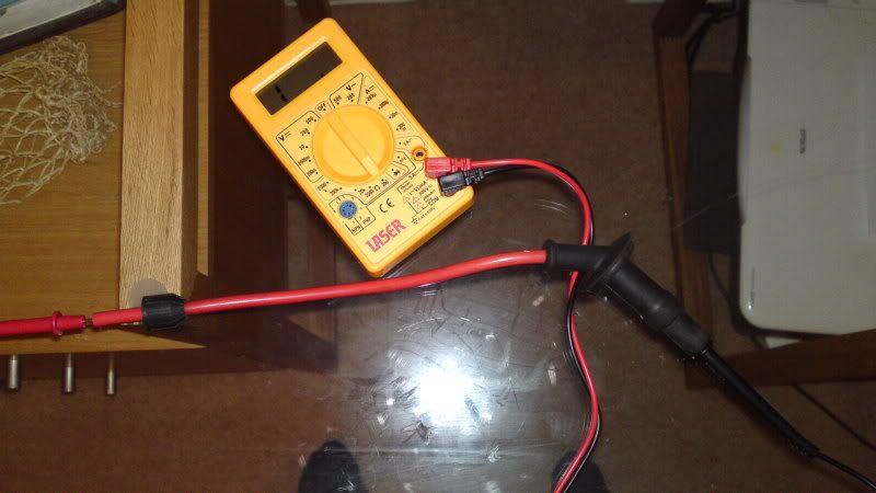

HT leads - I cannot get a resistance reading for either of the two which I have tried. Is it feasible that all the leads are duff? seems unlikely right?, but why then cant I can any reading on the two which I have removed?

I was starting to feel like the CDI unit was the only thing left to try. Plugs are new so should be fine. HT leads, just tried all scales on the multimeter, still nothing?
Re: NC24 - No spark?
Your black lead on the picture looks a little low to reach the end of the cap where the plug makes contact.Christoph wrote:Interesting, thanks for that :)
Either use a piece of wire stuck in there or try putting the sparkplug back in and measureing the resitance from the electrode of the plug / other end.
I can't really see all of the plug leads just going.

Yes I did try getting continuity with the spark plug attached, still nothing. If I wanted to replace the HT leads, where is the best place to go?

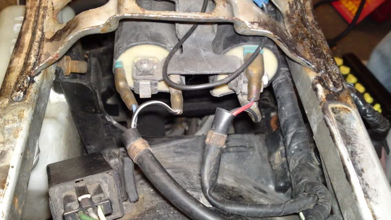

Check the earth on the front coils is ok too, you'll have problems if it's loose.

have you checked the front coil earth cause i had this prob aswel an just had to re-earth it

I havn't checked the front coils but I'm guessing as there is no spark from all 4 plugs, it's not an isolated issue. Have now ordered a used CDI off ebay. No doubt it'll change absolutly nothing and I'll be heading down the garage come pay dayVfRTeddy wrote:have you checked the front coil earth cause i had this prob aswel an just had to re-earth it
