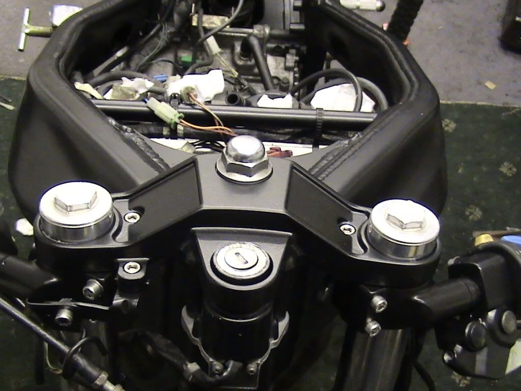

Re: hybrid rebuild starts again!! plus some pics
got some more stuff done in the last couple of days,new shocks in,rearsets,and various brackets bolted on
yokes etc powdercoated
[img]http://i248.photobucket.com/albums ... .jpg[/img]
new a4 stainless bolts
arrow pipe in mock up position-gotta make it fit the link pipe yet
rear end- 07 2co r6 shock sits in there now
reground and rechromed sp forks-yum!!
3ohm dynacoils for improved bang
ap racing adjustable ratio master cylinder
new plate
r6 shock now in residence
still gotta sort out a rear caliper as mine is minging but might have to rebuild and use it.need to sort out the coil connections so will be busy slodering tommorrow night.resprayed fork legs coming back friday so i can build the forks up and adjust the head bearings and the chassis is done,the forks have wp internals in them so need no further work.will post some more pics up when it looks abit more interesting.

Thats going to look nice,i'm going to do the same to my frame satin black.

That is looking rather nice. Love the endcan.
