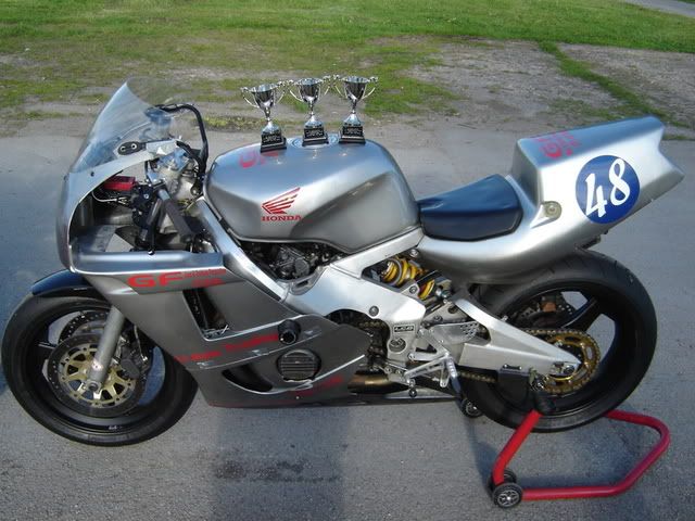

Maxton Shocks
GF Racing Racetech Upgraded Forks
GF CBR6 rear kits
HRC replica Ram Air Kits
TSR Systems
HRC Systems
GF Systems
HRC New Replica kit Rads
Magnesium HRC wheels
Just as we race and win with ..
etc
all in stock ...
Graeme
GF CBR6 rear kits
TSR Systems
HRC Systems
GF Systems
etc
all in stock ...
Graeme
Tel 07778 628448
