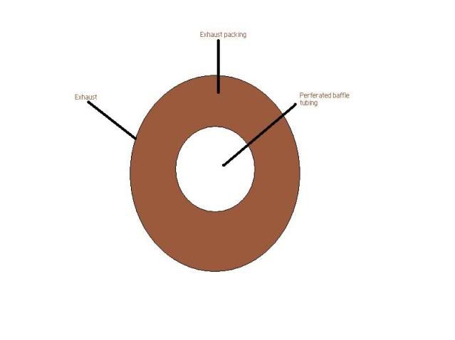

Ok, so to put it basically.
I measure the external diameter of the tube on the very end of the can (where the exhaust gasses exit.
I buy some perferated baffle tubing a mm or 2 larger than the diameter of the tube on the end of the can and the same length (ok well slightly shorter) as the exhaust.
I stick the baffle in and screw it in/weld it in. I then buy some exhaust packing and pack it around the outside of the baffle as tightly as i can.
So i end up with this basically-
Sorry for the rough picture but you get the idea lol.

yes just like a polo mint :lol:

i have an ART 2 inch straight thru on my bike, with bs stamp, no baffle (or even a fitting for it). the only difference between mine and your diagram is just into it where the exhaust bolts onto is a 'bulb'/chamber thats around 3" around, dont know what it does or why but shes pretty loud.
