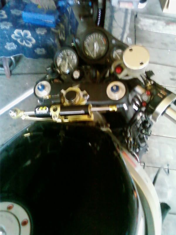

Looks like I'll be able to fit Hyperpro with R1 mounting kit - not too much mod. Sorry, for picture quality...
PARUS
Posts: 1160
Location: Seattle, USA
Re: Matris damper on NC29.
Post by PARUS »
That what I did with HypePro steering damper and R1 mounting kit. Easy job and works properly ever with screen brace.
Video: http://www.youtube.com/watch?v=uDEAz-bxlwI

but, can we use it with 29 stock front end ? as i know you are fitting 600RR07 front.
ta
