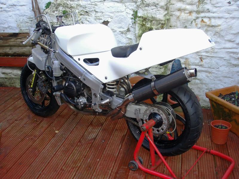

Fitted a new to me bottom rad yesterday......
