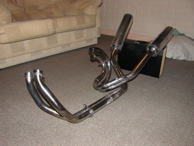

I have a question about my exhaust guys
I believe it to be a full TYGA system but I cannot see this particular system on the TYGA site, here it is :
Has anyone ever seen this one before ? maybe its a really old version thats why its not found online anywhere.
Also does anyone know if having this installed will release any extra ponies or effect the running of the bike ?

Not sure about the muffler (ask one of the Irish experts!GSX-R400 wrote: Has anyone ever seen this one before ?
Most half and full systems will increase mid range power and also a bit of top end power, but for best effects you'll need to jet the carbs to suit it. Typical main jets needed will be either 112 or 115 main jets (standard rvf is 108).

Certainly looks like Tyga pipework and can. This was on their site,

well now we've ID's my system as a RPM full system here's some pictures incase anyone else has one around
