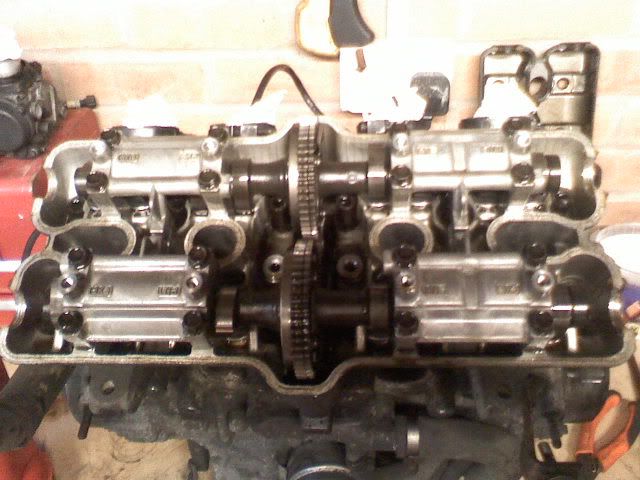

Well after "borrowing" a socket from work and converting it into a castleated socket ive managed to remove the engine
Removed the cover to assess whats involved with checking the valve clearances.
After eventually getting my head round the measurements i removed the cams to swop some of the shims over. All done...
Ive bought some alloy cleaner and the new jet washer is on its way.This all kinda reminds me of starting from square one again!!!!!!

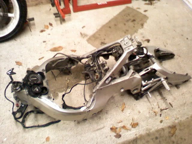

So once the jet wash turns up, i will be giving the frame a good seeing to...
