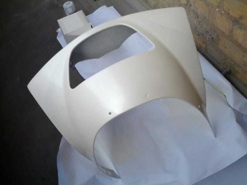

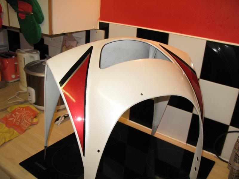

I've tried a new pearl white paint. Got it off the bay and while the Tamiya is £6 for 100ml this is about the same for 400ml. It's got bigger mica (metalic flakes) and it's thicker than the Tamyia. It might prove to be a bit softer too, it feels that way.
Anyway it's on the top fairing
Primered up
Taken the masking off and retouched the stickers
I'll let it dry overnight then a bit of laquer and some stickers.

I'm not touching anybodies flies !!!
Getting closer to finishing it :grin:
