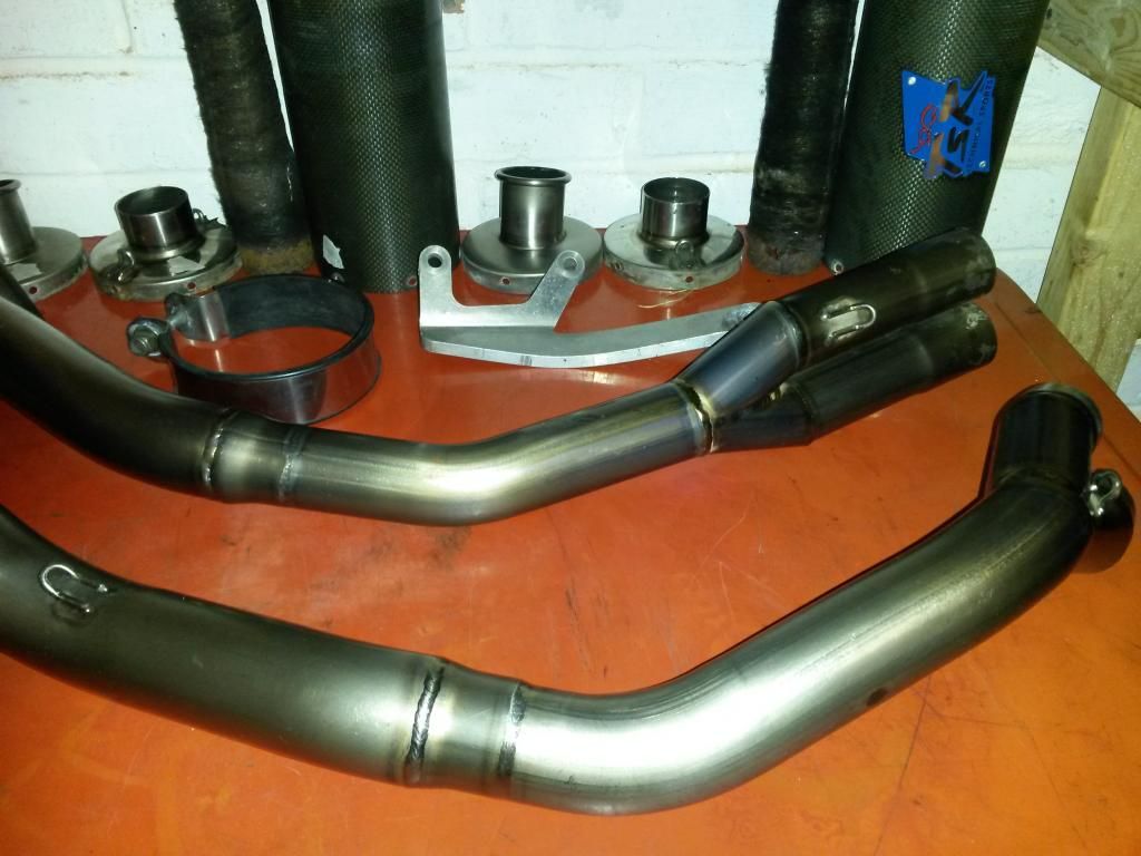

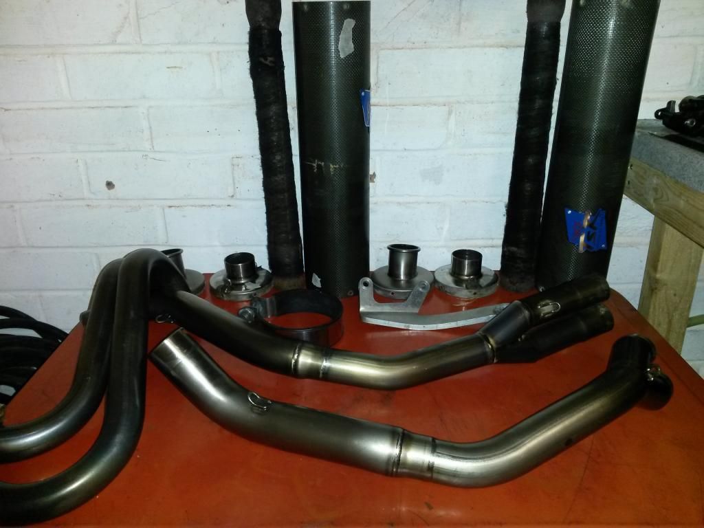

Not much to see at the minute
One of the sleeves is split so just going patch that up from the inside
Hanger needs bending back to position
And repacking obviously, luckily the inner perforated tubes are still usable as there bespoke to these cans
I still think these systems have the best looking pipework :drool:

That looks different to mine, I don't think my pipe diameter increases after the weld.
Re: RVF RT Suzuka build
I believe there are early and late versions of these systems although i didn't know the pipework changed, i thought it was just the cans. This one is the same as the last one i had.

How do the cams differ?
Ill fire you some shots of mine if I can get near it.
One type of can has rivet bands each end and a glossy finish to the carbon where as the other type has no rivet bands and quite a dull finish.

I've just noticed your front pipe link pipe has a spring loop on it the same as mine, I wonder why this was done ?
They come with a large jubilee clip that has a hook tacked onto it which fits around the front downpipe so you can spring fit the 2 sections together.
