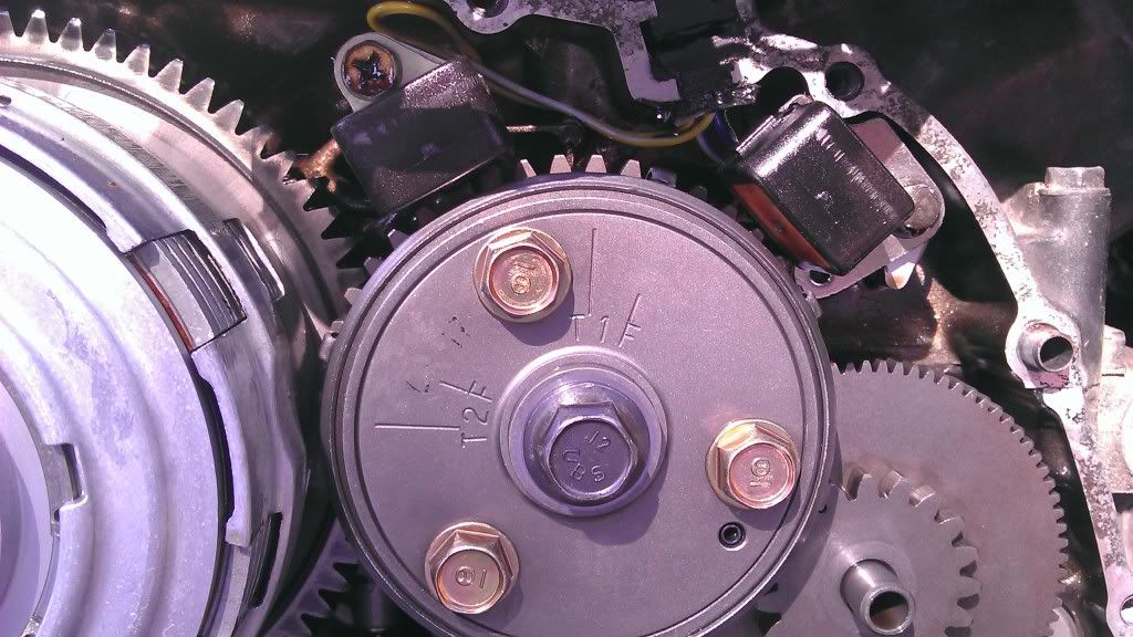

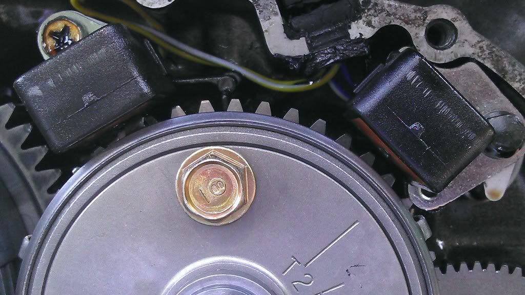

hmm well ive just checked the pick up. and its still tight in its place not a movement to it. but ive took a picture of my pick ups.. the left one is the one witht he good tread, the right one is the fucked up one.... but does the left one look awfully close to the starter clutch?

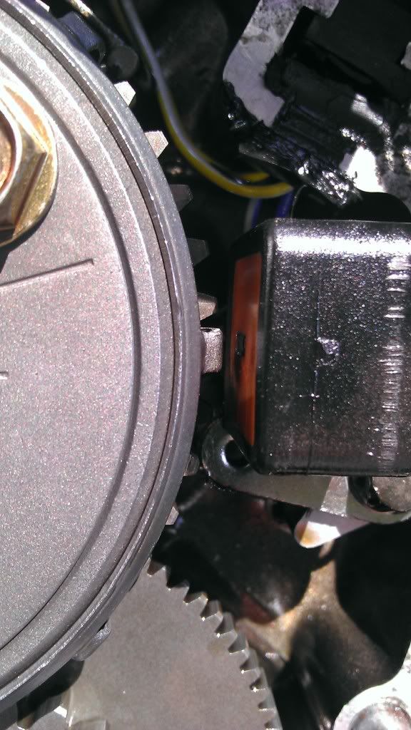

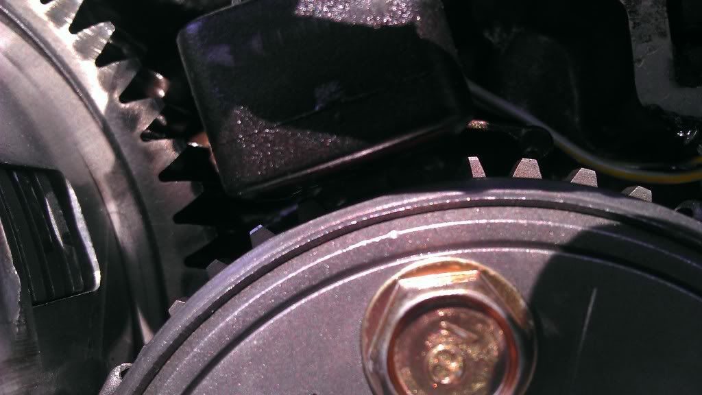

here are more pics of what i mean.
the first pick is the right pick up. notice the huge gap between that the and starter clutch.
second pick up the left one, and its almost touching the starter clutch. but it is NOT touching it.
3rd pick is them both from further away.

anyone? does that look fine? or a bit wrong?

Good question regarding the clearance between the starter clutch and pickups. Large clearance will reduce output voltage a low speed. Could cause engine misfire on two cylinders at cranking and low rpm (idle). Once rpm increases the output pickup voltage increases enough to fully run the ignition.
As I have not had this part of the bike apart I cannot be sure how Honda set it up but I would have thought the pickups would be designed to automatically maintain the correct clearance, cannot find a figure in any of the OEM or haynes manuals, so IMO start with a 0.5mm feeler gauge to set the clearance between the starter clutch protrusions and the pickup face. Make sure you have this clearance all around the starter clutch.
As other have suggested, if the bolts threads are oversize then you should have them repaired with thread inserts, otherwisw with time the pickups will work loose and hit the starter clutch.
This might explain why your have had failures. There is a magnetic attraction between the pickup and starter clutch that will pull on the pickup every time a protrusion on the starter clutch passes. Effectively setting up a vibration that will rattle the pickup loose if not tight.
